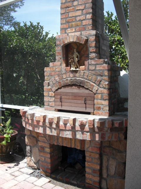

ID:	2752026 months later and still no countertop. But, I have made a few improvements. I added stone veneer to the base with an overgrouted application along with a neat brick detail for the door surround. I also made a cool brick face to my hearth that will one day support my countertop. The top will sit on the bricks and be level with the floor of the oven. I'm making a wooden door for the wood storage area to match the door to the oven. I thought this would tie in nice with the old world look I'm going for.

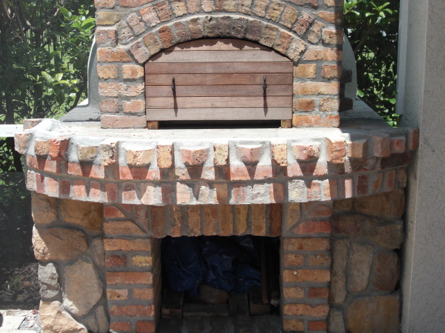

ID:	275203 Here is a close up of the hearth face. I chose this design from a few pictures I had from Italy. They used so many details in thier designs; I wanted to have that same look/feel.

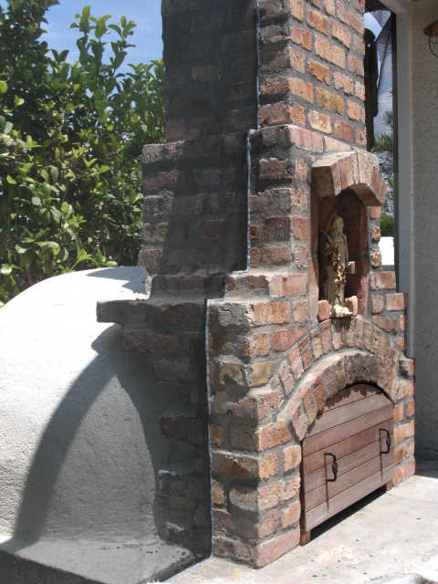

ID:	275204 I cant remember who asked me to post the picture of how I tied the screen enclosure in to the build but here it is. I still have to trim the screen in a few places but the measurements and screen placement was exactly where I planned it to be. I know, I'm amazed as well. As you can see there is plenty of work left on the oven exterior. I have the bricks for the brick dome I'm planning to place on top of the stucco shell but that may wait until it gets cooler...

ID:	275205 This is the view from the sitting area.

                Very nice indeed. Bill, on the third picture down - what is that white line between the front and rear brick? Is it the camera or is there something there?

                  The line is the 'clear' silicone sealent I used to hold the screen in place. I guess clear can mean 'partly cloudy' as well.
