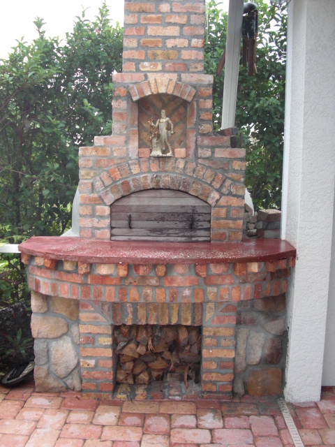

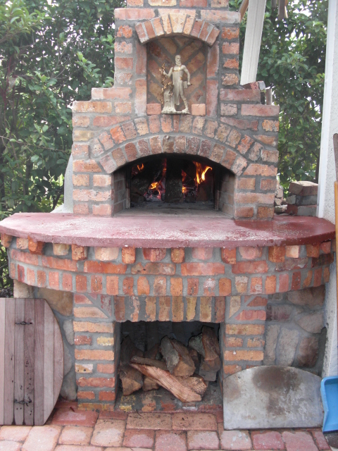

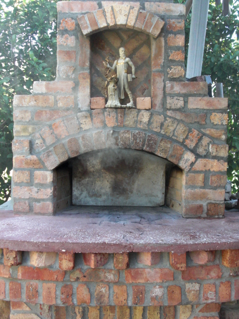

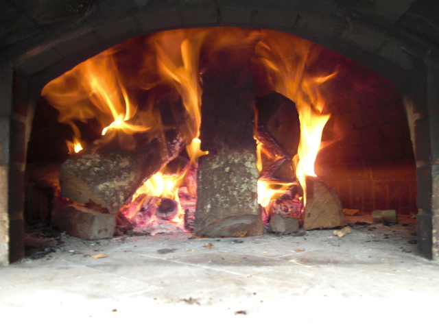

                        After rave reviews on the turkey cooked in the pizza oven last Christmas I decided to cook two for this Thanksgiving. I cooked the traditional honkin bird in the kitchen oven that came out fantastic , and then I smoked one on the pizza oven. I still cannot believe how easy it is to cook in the pizza oven. It doesn't matter what it is it always comes out better than expected.
                        I started the fire around 830am, had a good roaring fire for a few hours and just when the top of the dome started to self clean I knocked the inferno down, pulled the larger logs out and left a nice pile of embers/coals glowing. The temp averaged around 650f. After I moved the coals to the left side I let the oven rest for about 40 minutes so it could adjust itself to an even temp all the way around. Then I placed a 15lb bird resting on a roasting tray with foil covering the entire surface along with an inch of water in it to the back right side. I placed another water tray in the center of the oven with about 2" in it. (Glad I built the larger oven). After that I simply tossed a few handfuls of Publix bought hickory chunks 'DRY' on the pile of coals, place my ugly stainless steel door in front of the opening leaving just about 1/2" gap on the bottom right of the doorway. Within seconds moist thick smoke was billowing out of the door and chimney. I opened the door up after 1 hour, pulled the bird out, filled both trays up with water, tossed another pile of chunks on the bed of coals and shut the door. 2 hours later I uncovered the bird. Surprisingly the bird was already caramelized from the smoke and looked incredible but the bird was just at 150f. One hour later it was done and the bird came out. It looked like it was over cooked but that was just the smoke on the skin/surface. After pulling the skin off (too smokey/spicy for me) I started carving and man o man was it awesome! the smoke had penetrated so deep it was a third way through the breast. The meat was falling apart, and had the best flavor. My family has already requested that the large Christmas bird is from the pizza oven .
                        Here are a few shots.

                          [ATTACH]16112[/ATTACH] She ain't pretty but there were hardly any left overs! The meat was so tender; at first glance you'd think this would have been dry. Next time I'm not going to heat up the oven as much and try a lower temp/longer cooking. I think if I get it around 400f and then keep the coals going like I did I could maintain a 250-300f oven for a longer period. I'm also going to try one without any smoke; just retained heat.
