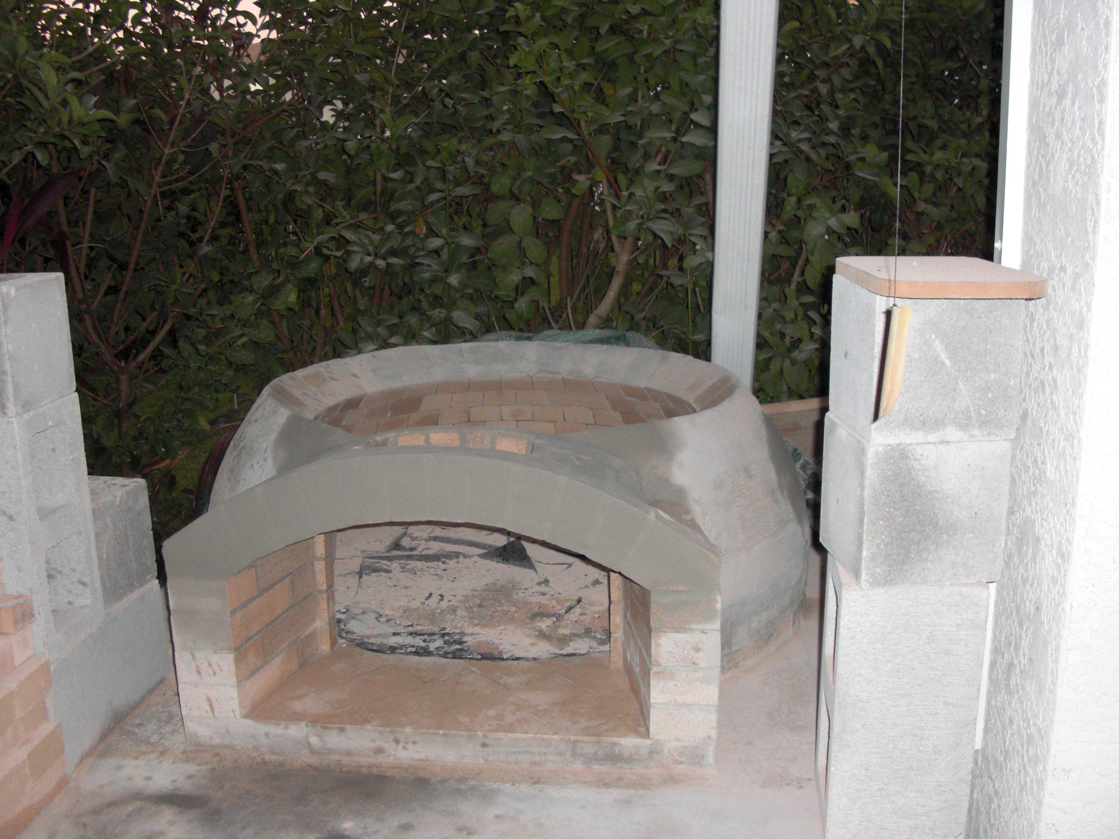

                          11-16-08
                          Ok, I've completed my objectives this weekend and even had time for my 'other love' (pizza oven) as my wife calls it. Work, yard work, and a very disappointing loss of the world heavy weight UFC title that my man Randy 'The Natural' Couture endured when he had to battle the Freak-of-Nature Brock Lesner last night all got in the way of my oven build. Despite all that I managed to stay on task.
ID:	272986 The arch entry came out good I feel. Not perfect but I am trying to remember that a lot of this will be covered up.
ID:	272987 I had to place blocks to hold up a tarp since it decided to rain yesterday as the cold front moves in . I hear that areas close to me may have frost tomorrow morning... The next row should completely take the arch out of the picture and allow me to finish it up.

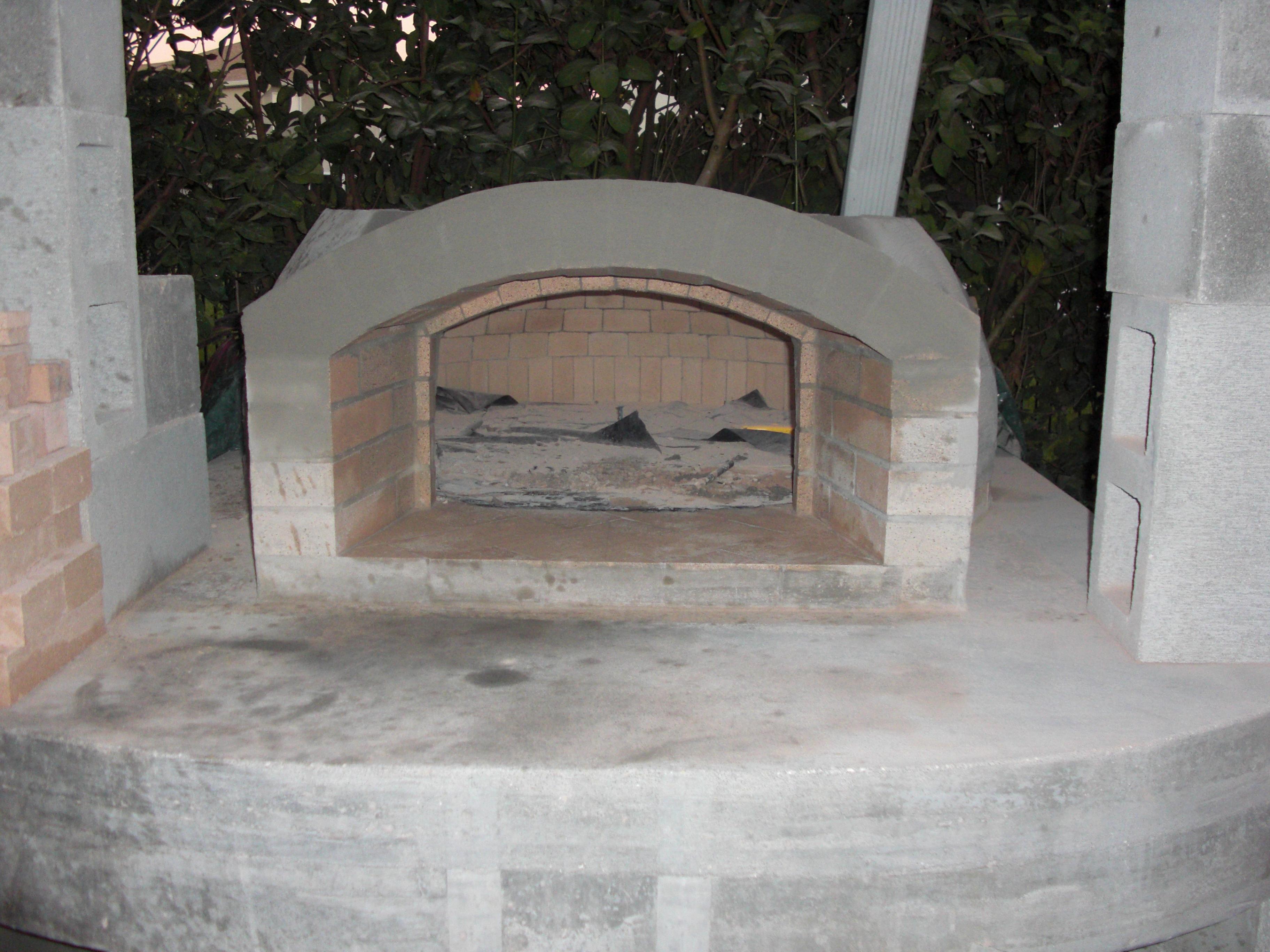

ID:	272988 Blimp shot of the arch and chimney opening. I made a template and pre cut the bricks to have the right size opening ahead of time. I also have a full brick pad that will sit between the chimney and this opening. It will give me the extra couple of inches needed to get over the top of the screen enclosure along with reducing the amount of heat that directly hits my chimney. I still have to mortar the pcs on each side of the arch but I was tired and had enough fun for one weekend.

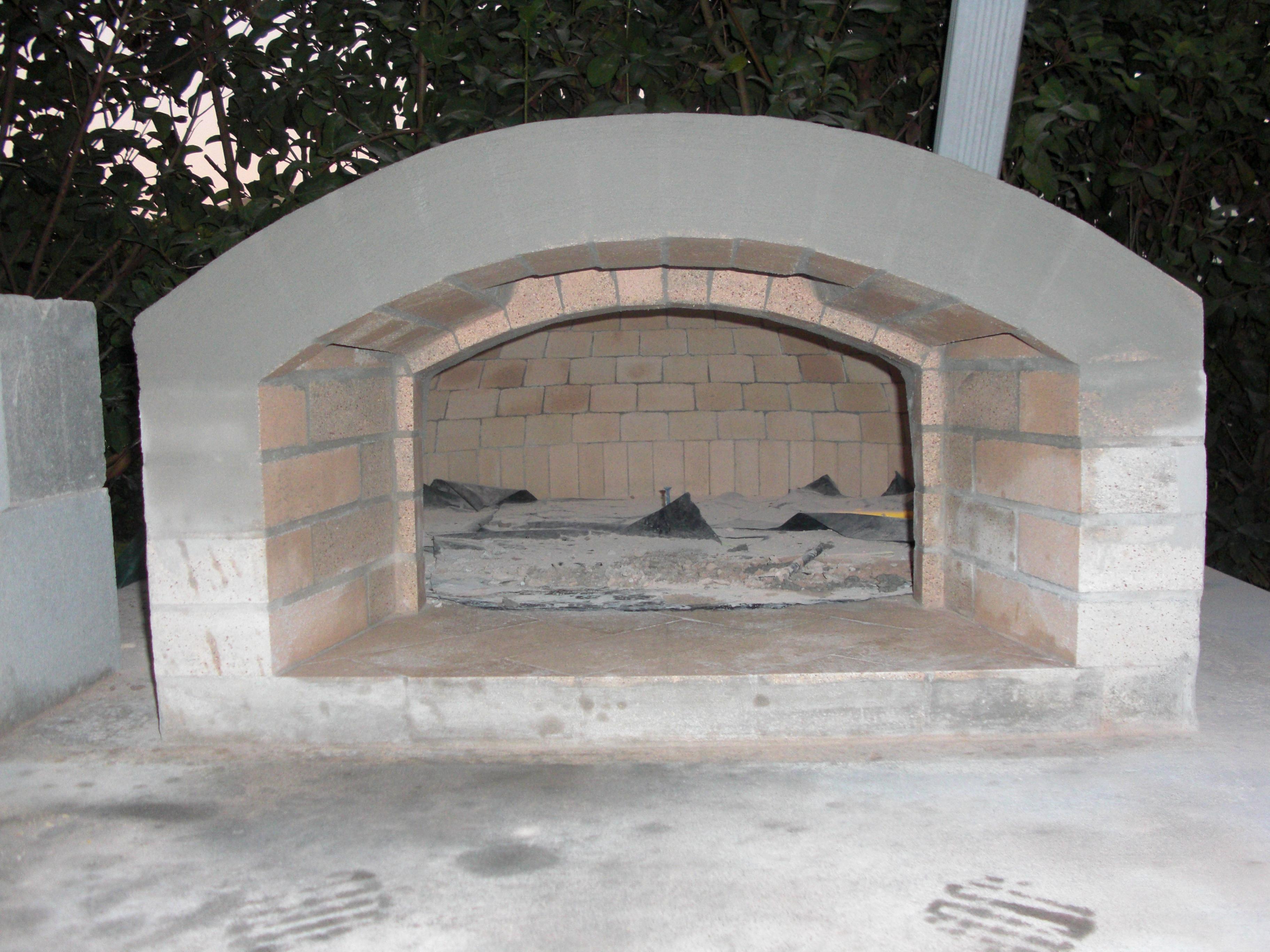

ID:	272989 Close up shot of the entry showing the vent design. Hopefully it will be good enough as it is. I can always grind away at the bricks to make the opening bigger and encourage the smoke to cooperate.

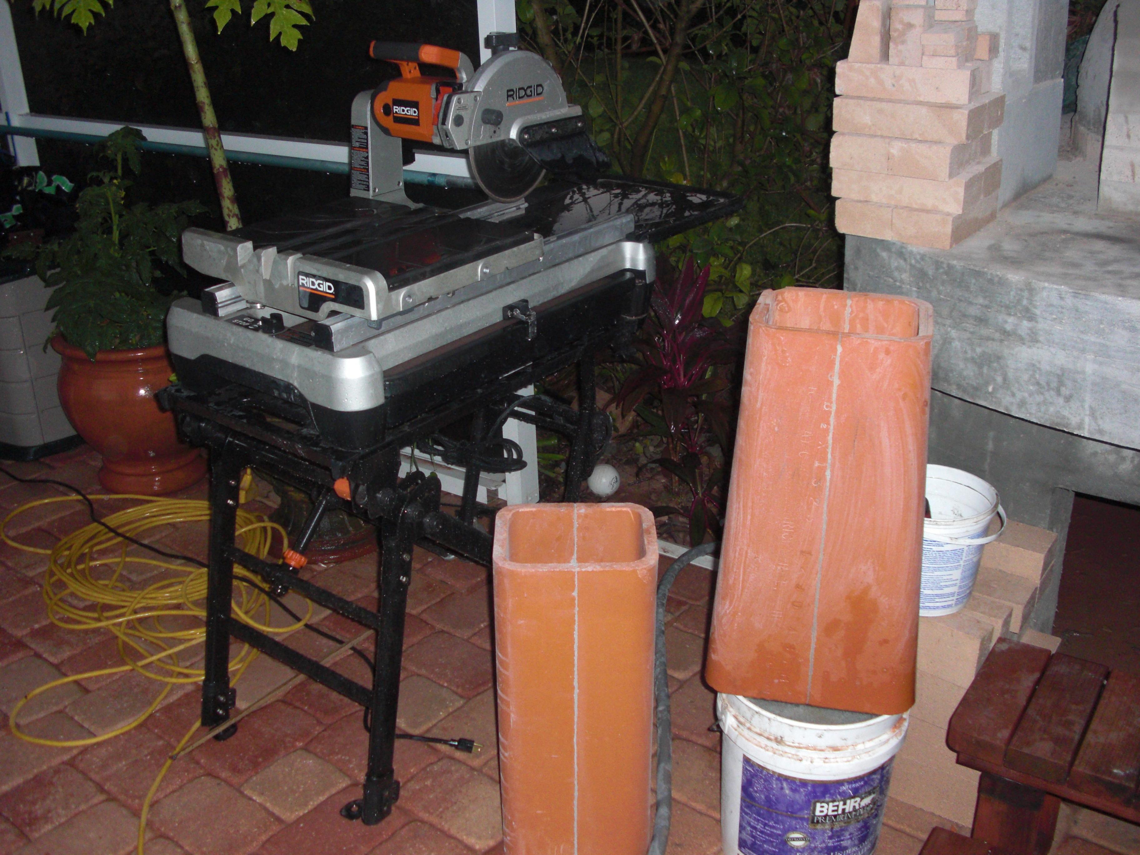

ID:	272990 I took the advice of Les and Mike and cut my clay pipes. It went very quickly and was way too easy. I simply found the center of my pipes, measured 4" from both sides (inside), marked the lines and cut them with my grinder. Next I took my grinder and made about a 3/16th" deep groove all the way down the center of the edges that were going to be mortared together to give it kind of a biscuit joint if you will; mortar being the biscuit. I took the other one and just made it 8"x8" ID square.
                          Oh yeah; that's the new Rigid wet saw. I must say; it's not built as well as the MK and if and when it ever needs a new motor it will be a huge issue. The MK is belt driven so the motor is easily replaced and not that expensive and has way better water spray wich makes the blades last longer. The MK blade is over 3 years old and has seen much use (it belongs to the place I use to work and it's seen a ton of abuse). The Rigid blade is just days old and is already 25% gone. I like the compound miter capability but at this pace it will cost me $$ in blades. I may go back to the MK... Sorry guys; I cant stand paying that much for something that just wont cut it... no pun intended.
