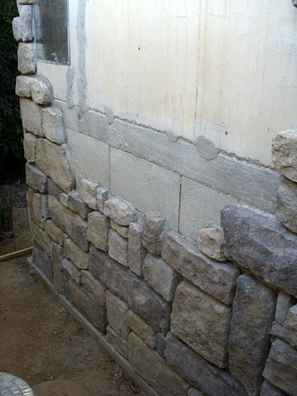

                • Re: Dino's 42" Pizza Oven Starts
                  I did the Surface Bonding Cement (SBC) thing yesterday. It's really hard to do a tuscan smooth plaster kind of finish. I decided to just swirl a rubber float and rough it up a bit, like smoothish stucco. I used Quikrete SBC (white) and added a 2 cup bag of gray stucco color and a small scoop of tan. It wanted to be more tan than gray, but it matched just fine. Oh and I replaced 1/2 gal of water with Acrylic Fortifier. Easy to mix by hand in 2 batches. 1/2 batch is: 50 lb sbc bag in half: 25 lbs, add 6 cups of H2O and 4 cups Acrylic Fortifier (you could reduce by 1-2 cups of H20 if its not hot/dry outside).
                  Here is a pic of the inside of my wood storage. You no longer see the CMU lines. I thinks it's still damp and the suede look will sadly go away.
                  And here is the back of my oven. I put SBC on the upper half, since the lower half is stoned (...dude) Yes, there are a few, barely noticeable "hairs" or fibers that stick out of it, but it's fine. It was really hard to keep it at 1/8" thick but after checking it this morning, the 1/8" areas (some even less that I was worried about) looked great. So I recommend trying to go that thin if possible.

                  below attached is the "before" pic of the back.
                          Dino,
                          What kind of stones did you use? Are they cutured; a certain manufacturer...what style?? I love the look of them
                          Peter
                              Thanks you guys. I appreciate your comments. Like Gary said, there is always some little thing to do. I'm going to try to tackle those little things right away.
                              Peter, I can remember only 1 of the stone types, I've got the other brochurs at work. I used a "cultured" stone (cement poured into stone molds with a color and texture added). I'll get back to you on that.
                                Dino its been a little while since I saw progress shots of the enclosure but must say that the stone work is first class!! Thought about changing occupation and becoming a stone mason!!
                                Did you use cedar in the eaves?
                                The contrast from the Slate roof (assume its slate) to the eaves and then to the stone work is perfect!! Overall great colour scheme.
