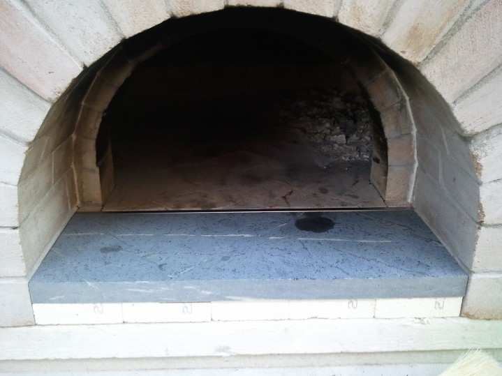

                  I did something similar to Russel - used Insulated firebrick splits under my stainless steel and a piece of Soapstone that is my landing.

                  I just got the landing fully installed in front of that today... the picture was taken last August
                  I think there has been some discussion of how well Granite will handle the heat of a landing - I would do some searching on that.

                    Hey Deejayoh, that looks great [you photos] and I was doing the search on Granite Landing while you were typing the message.
