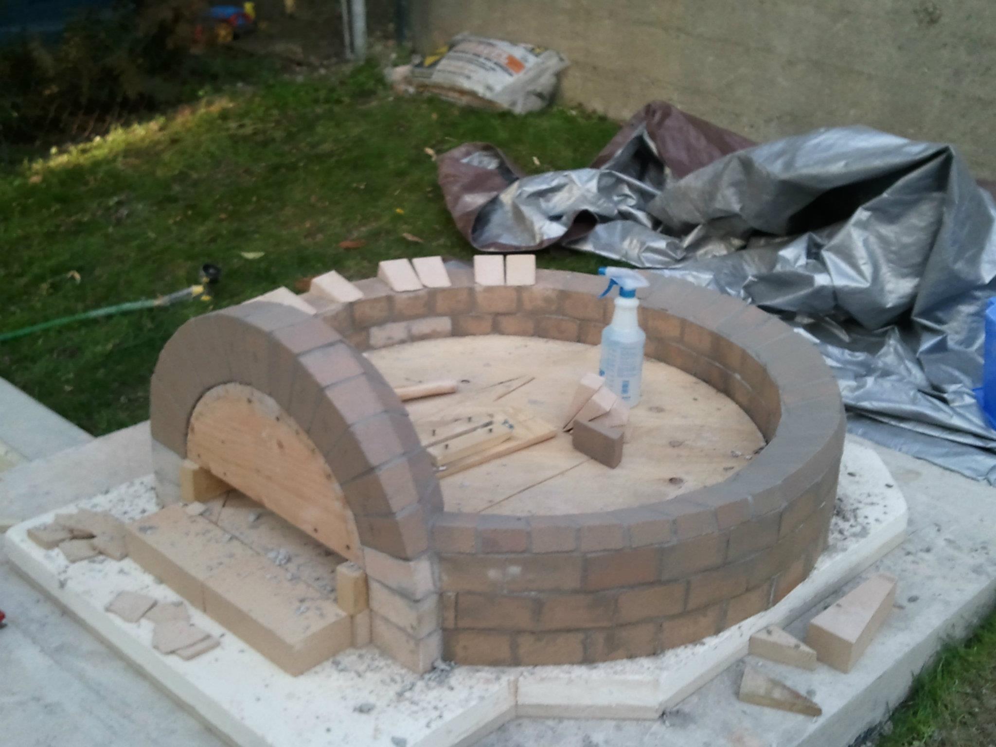

                    • Re: new build in werribee
                      Colin -
                      I built a flatter dome and because of the shape of the dome, the cut away changes as you go higher up the dome. See my picture below
                            Hi Dennis
                            Was Looking At That Photo last Night Dennis.
                            That's how i believe mine will end up. I think Russel is referring to the triangle where the dome template meets the arch in previous photos.
                            Lining the TDC brick up with the face of the Arch Form pushes the brick back into the oven engaging the Dome Template [slightly lower/flatter Dome at that point]. Is this ok as you see it.
                            I'm not to sure then how to work out the scribing bit spoken of in your's and Johns conversation about this on your and his thread. I will cut that TDC brick during the week and dry lay the Arch with Shims.
                            Am I On The Right Track.
                            Cheers Colin
                            Oven 1 Completed
                            Oven 1 and surrounds
                              Hi Colin
                              Because you are building a flatter dome I don't think you should use the string. It is giving you the angle if you are building a hemispherical dome. Just make it a right angle with the line traced from the dome form and it will be ok.
                              Just picture it as if you had laid any other brick in the dome. One surface is the inside of the dome and the other (the top one) is ready for you to lay the next course (or chain ) on.
                              Sharkey.
                                what I did there was figured out the TDC brick and the brick at the beginning of the arch, and then I drew a line between the two to approximate the face of the intersection. It wasn't perfect, but it was pretty close. Certainly close enough that any error could be covered up with mortar.
