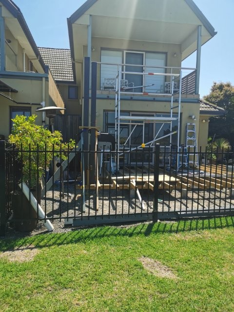

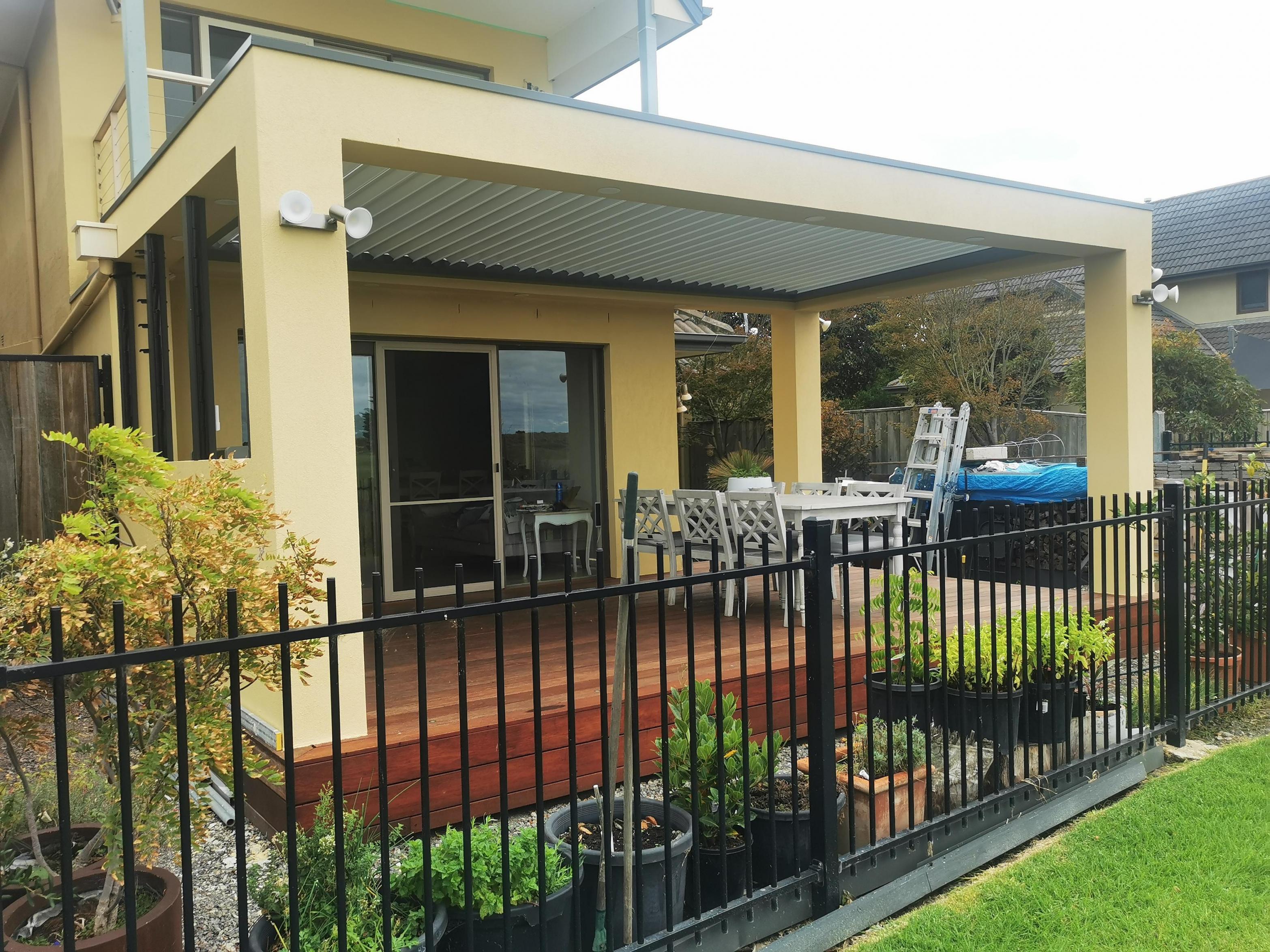

    https://community.fornobravo.com/cor...EAAAICRAEAOw==​​ Finished Verandah in April, the open louvre roof is a great addition, now onto Garden, paving and then finally the Oven. Louvre glass panel being built for left side.
    Click image for larger version  Name:	IMG_20220325_142811.jpg Views:	0 Size:	1.00 MB ID:	448971

  • oasiscdm
    HI All sorry i gave been scarce has been a busy time since last post am now a grandfather have been busy trying to get verandah done and dusted before March deadline [will fail] due to material delays and tradesman delays wont succeed.
    I am getting verandah rendered currently and have ordered roof.
    Then onto paving after that I can start oven. Yay.
    ​​​​​​​Will post photos when a get a chance.

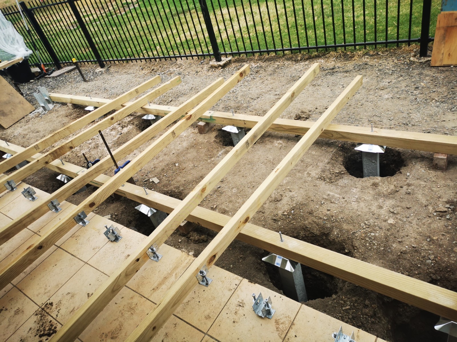

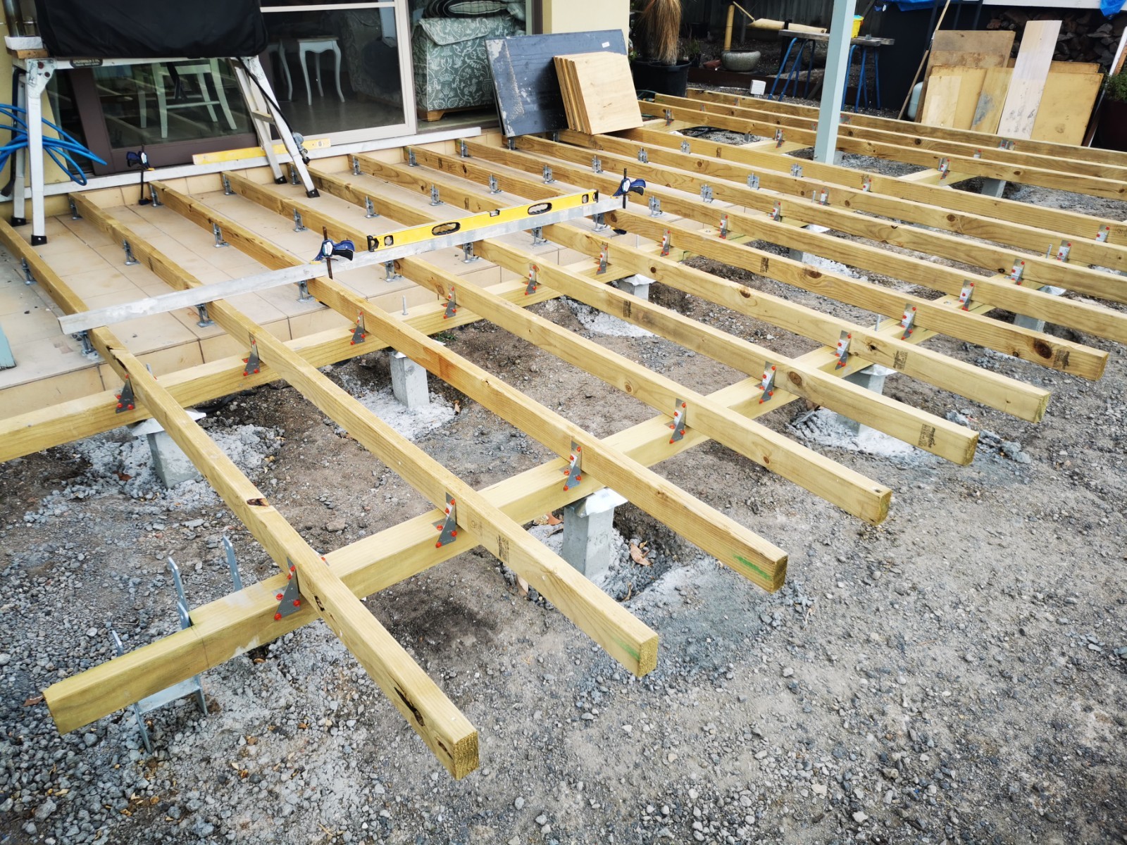

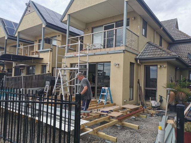

  • oasiscdm

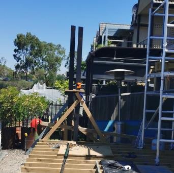

    And the Verandah and Deck continues
    .Click image for larger version  Name:	IMG_20201213_191932.jpg Views:	0 Size:	675.2 KB ID:	434904 Click image for larger version  Name:	IMG_20201213_191854.jpg Views:	0 Size:	706.3 KB ID:	434905 Click image for larger version  Name:	IMG_20210114_095540.jpg Views:	0 Size:	37.4 KB ID:	434906 Click image for larger version  Name:	IMG_20210114_095553.jpg Views:	0 Size:	114.7 KB ID:	434907 Click image for larger version  Name:	IMG_20210114_095559.jpg Views:	0 Size:	105.3 KB ID:	434908

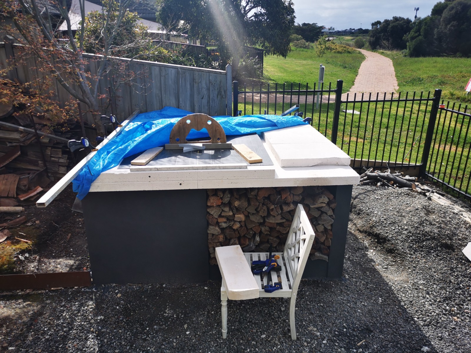

  • oasiscdm
    and some more. had to stop oven and begin verandah deck construction
ID:	434901 Click image for larger version

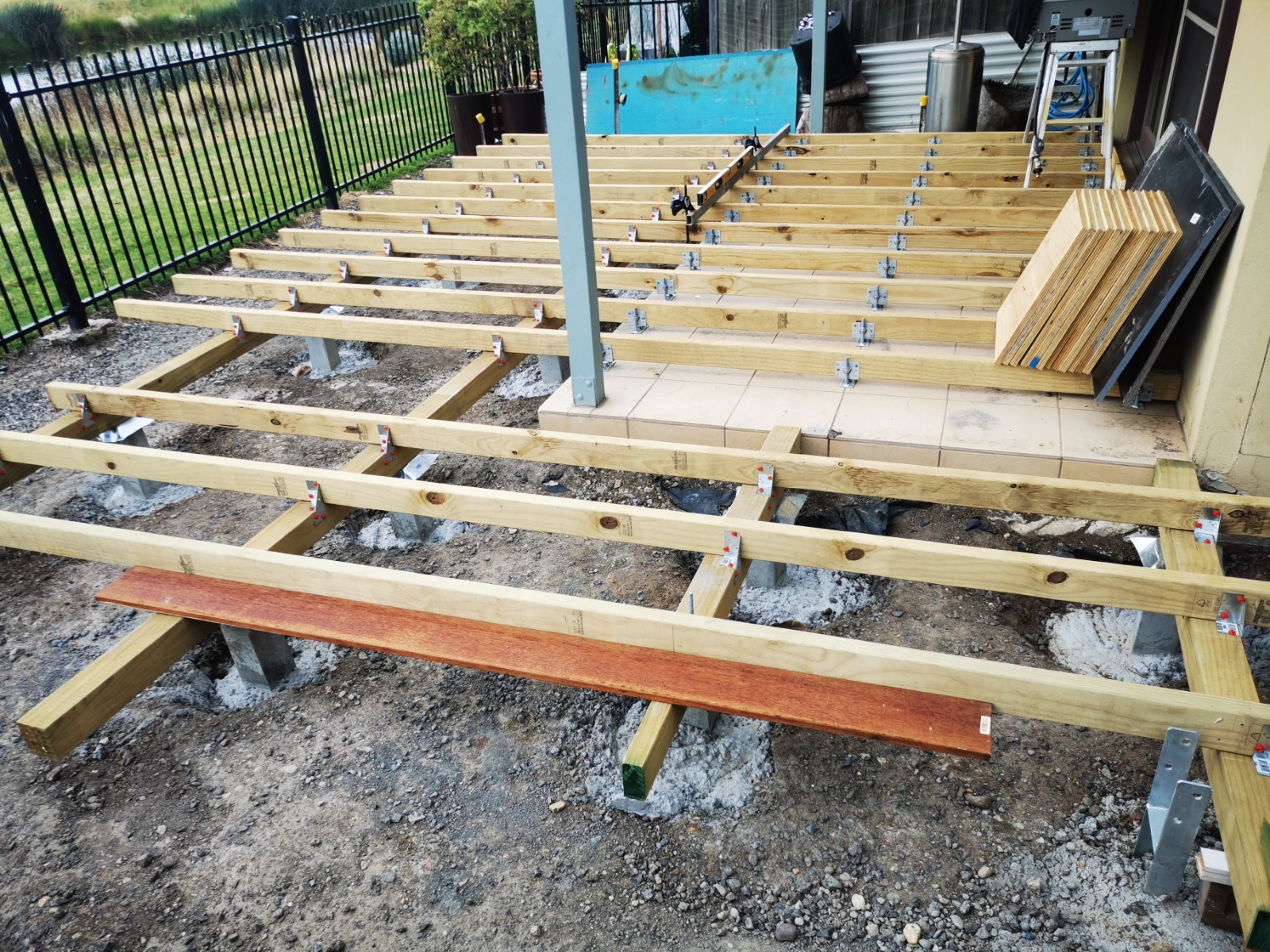

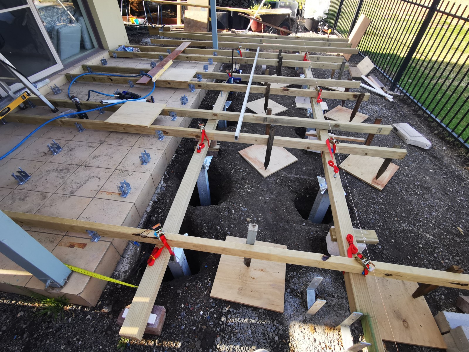

  • oasiscdm
    Hi All
    Just checking in.
    Oven is pretty much on hold as I have had to begin construction on our Verandah and Deck. As my partner son's landscaping team have completed all the holes for the verandah posts and deck stumps. I have managed to get these concreted and all jbearers and oists installed for the deck. This weekend managed to get 6 posts installed with 2 left to install.
    Oven base completed and I'm up to the hearth but alas I have no room to set up the brick saw.
    Will post photos soon.

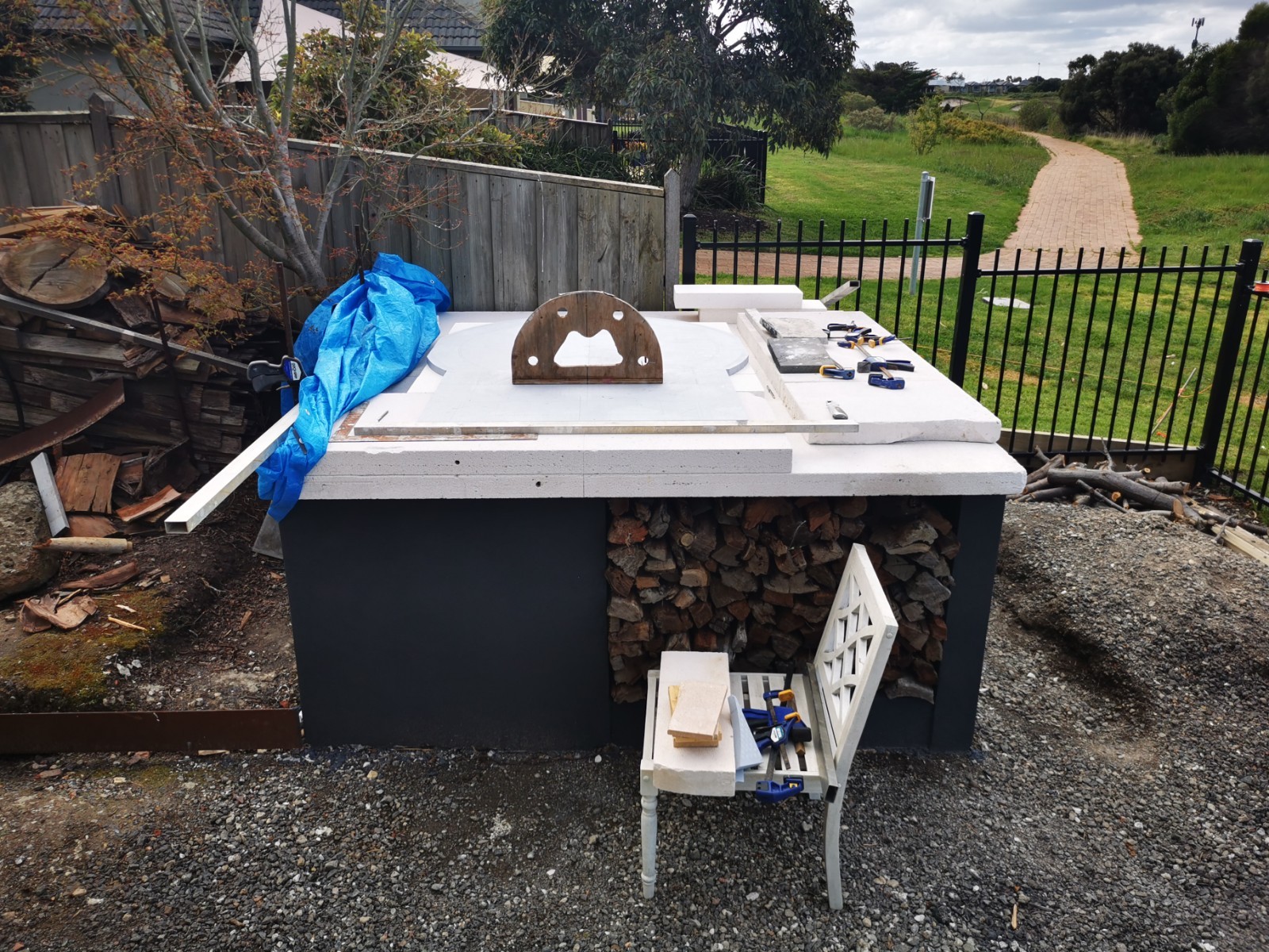

  • oasiscdm

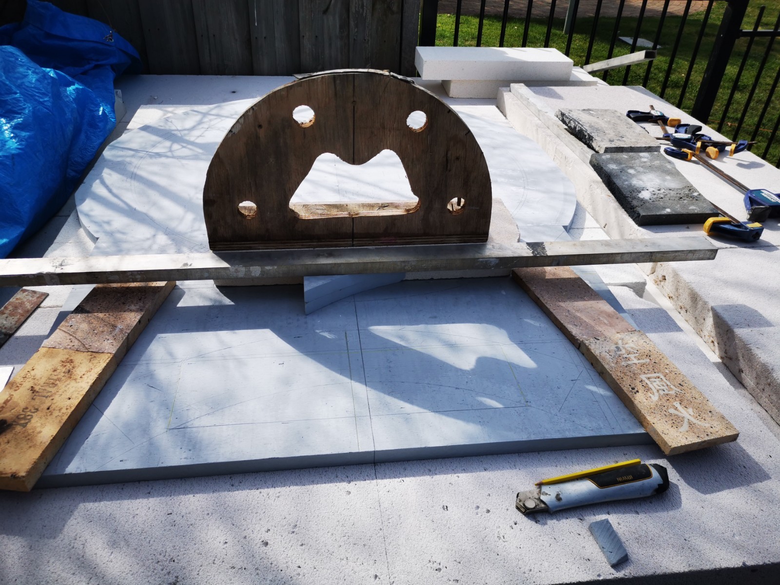

    And some more. The flue is double skinned and insulated.
    I researched this to death and found a place in South Australia called Timeless Classic wood Stoves https://www.timelessclassicwoodstoves.com/
    The flue is 8" internal diameter made up of 1 metre, 250mm, tree cowl and a step down double to single for the anti down draft cowl. I will weld a 300 x 300 stainless plate to the bottom of the 250mm flue to act as the mount base with a hole cut out. Flue bits $500 + $59 delivery. Possibly overkill but flue I previously used on the first build l paid the same amount for shipped from the US. That one is now well over $1200. So being able to source in Australia was a bonus.
    The flue will be longer than the last one by about 300 so should aid drawing more.
    Click image for larger version  Name:	image_91920.jpg Views:	3 Size:	281.1 KB ID:	428958 Click image for larger version  Name:	IMG_20200824_102233.jpg Views:	0 Size:	281.8 KB ID:	428960 Click image for larger version  Name:	IMG_20200822_130445.jpg Views:	0 Size:	395.2 KB ID:	428961 Click image for larger version  Name:	IMG_20200827_162942.jpg Views:	0 Size:	274.9 KB ID:	428962 Click image for larger version  Name:	IMG_20200827_163009.jpg Views:	0 Size:	346.7 KB ID:	428963 IMG_20200818_091326.jpg

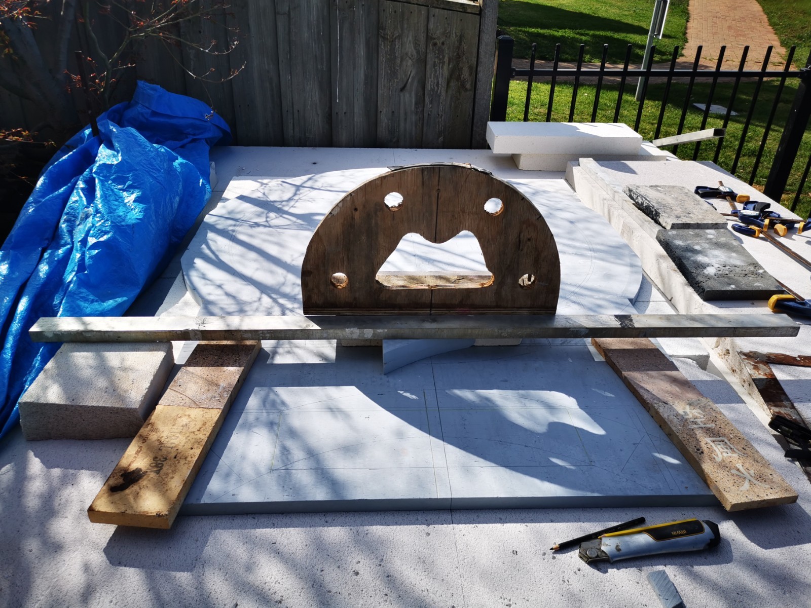

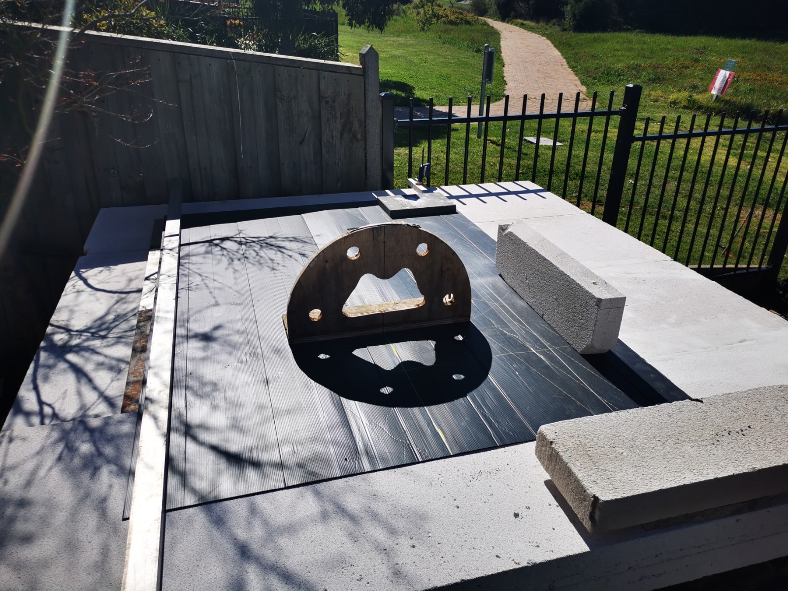

  • oasiscdm

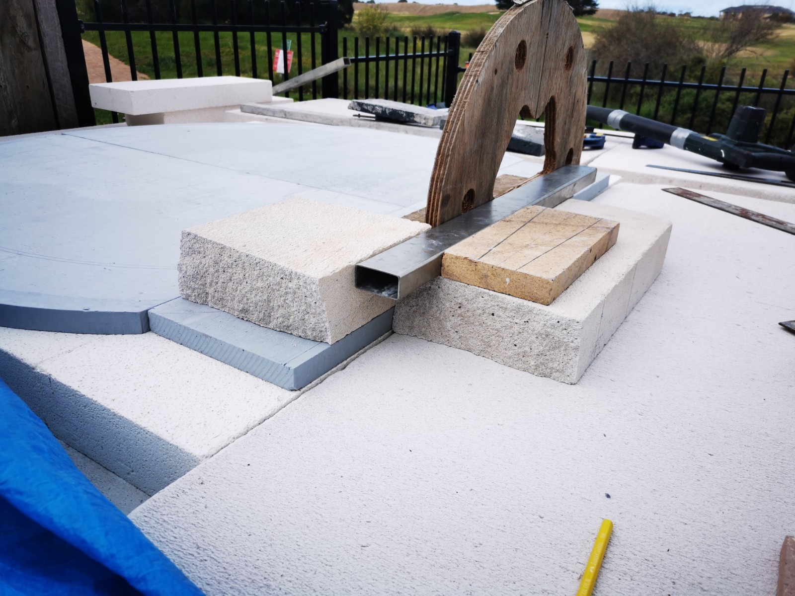

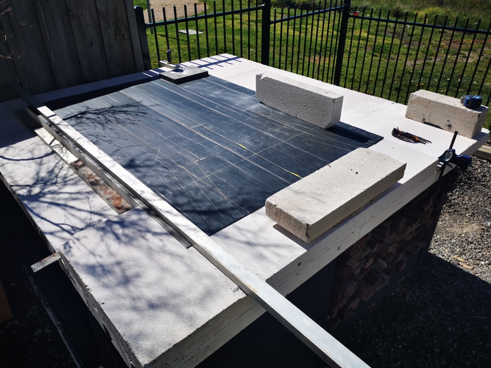

    Managed to get various bits happening, base finished, templates done and flue arrived. The insulation tiles are 230 x 600 x 75mm. The firebrick tiles 610 x 305 x 75 and are bloody heavy.
    Click image for larger version  Name:	image_91913.jpg Views:	3 Size:	568.2 KB ID:	428951 Click image for larger version  Name:	image_91914.jpg Views:	2 Size:	436.1 KB ID:	428952 Click image for larger version  Name:	image_91915.jpg Views:	2 Size:	715.4 KB ID:	428953 Click image for larger version  Name:	image_91917.jpg Views:	2 Size:	361.6 KB ID:	428954 Click image for larger version  Name:	image_91918.jpg Views:	2 Size:	338.0 KB ID:	428955 Click image for larger version  Name:	image_91919.jpg Views:	2 Size:	379.7 KB ID:	428956
