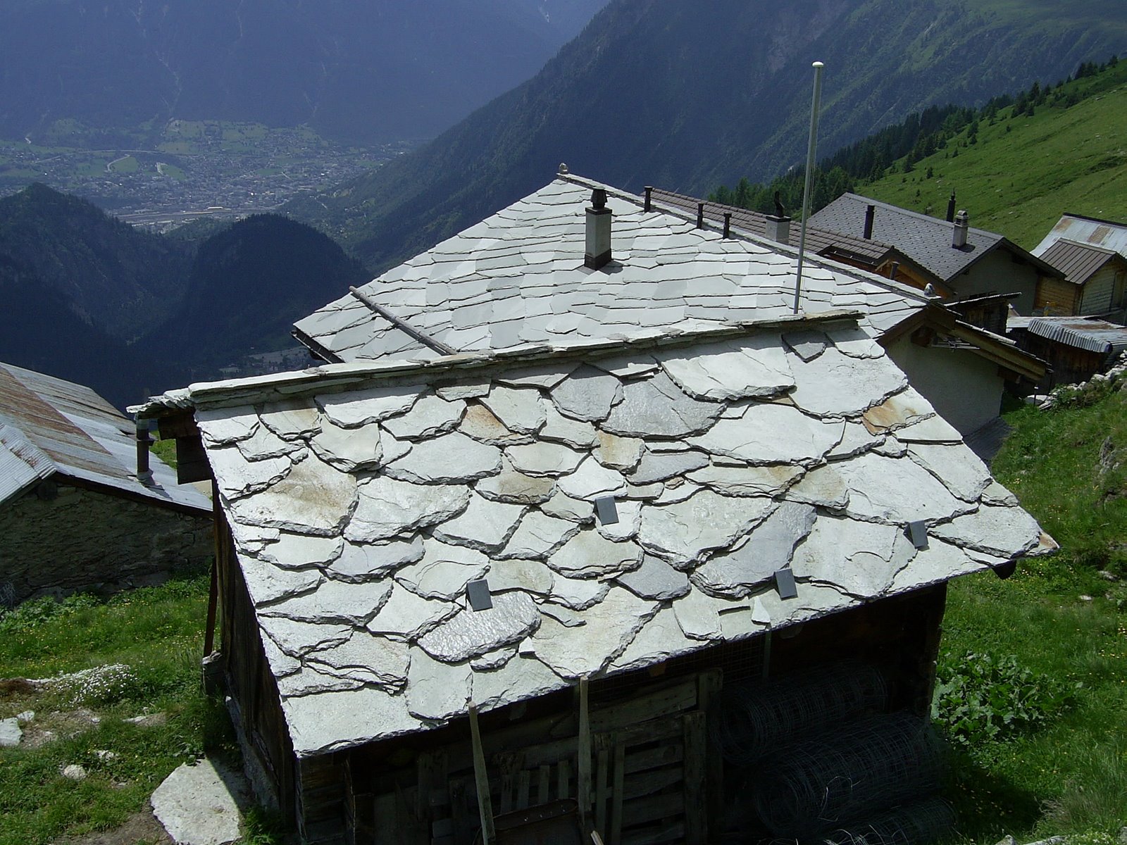

                  No worries Dave ( in my best OZ accent ) happy to answer questions. The stone I am going to use would typically be thought as flagging.....large, flat, irregular paving stone.
                  It is not slate, but a type of metamorphosed sandstone, which varies in thickness, from 1/4"-3/4". Here is a pic I posted earlier in the thread. This is what I am shooting for....
Name:	New Stone Roof.jpg
                  I haven't done one like this yet, but to me it's not unlike other types of stonework I have experience with so I'm not concerned....it drills nicely too. I'm pretty psyched to do this...and I returned all my cedar shakes so I wouldn't back out again.

                    Looks nice. Is there anything apart from gravity that prevents them flying off in a storm? Reason for asking is that we're in a cyclone area.
                    • Re: My Wood fired Redux
                      The old traditional stone roofs used thick heavy stone. If a storm blows them off, nothing would have survived.
                      For my stone, since it is thinner, I am installing it similar to large slate....that's why I mentioned it drilled nice. I had some samples that I brought home and test drilled a bunch to make sure. So the stone will be attached to cleats with 3" ring shank nails. I'm in a hurricane zone, but anything short of that wont knock this material off.

                        That looks like Switzerland. Those small barns are scattered all over the place there. I agree its a great look!

                          It is Switzerland Garner, good eye.. But that type of roofing is done all over Europe and Asia too.
