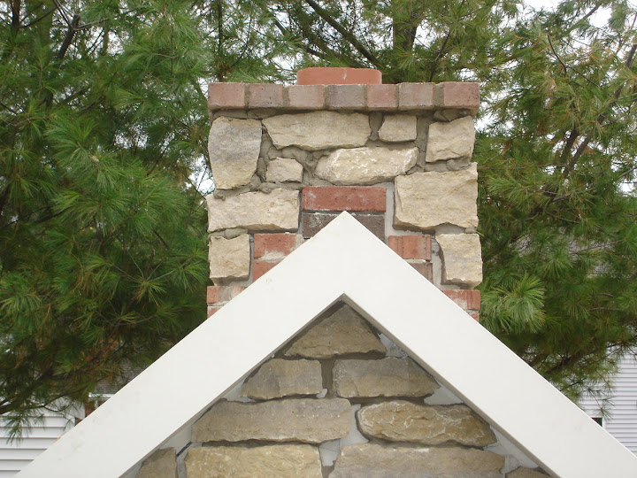

                          I worked out the flashing around the chimney. Here was my approach. The dilemma I had was tucking flashing in around irregularly shaped stone. The step flashing is likely easier with brick chimneys. Since the stone was costly, and I was I was afraid I'd run out anyway, I didn't want to put up stone just to cover it with copper.
                          I had some extra brick around. I used the brick saw to cut them in thin pieces, 1.5 inches (same average thickness as the stone). I mortared them on the cement board chimney surround for areas I planned to put the step flashing.
                          I then put stone on the rest of the chimney, as well as a decorative brick cap.

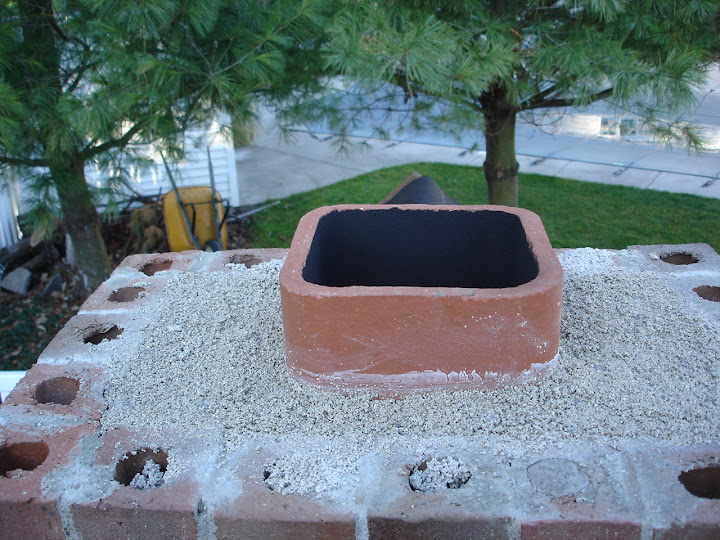

                            I filled in the gap between the flue tile and the chimney surround with vermiculite-concrete mix (I thought that would give some flexibility for expansion).
                            I then put on a concrete "cap" to keep the water out, and put on a flue cap. I'll caulk the gap, still.

                                I put the pre-bent overlapping pieces of step flashing over the brick, nailed to the roof, and grouted all the joints.
