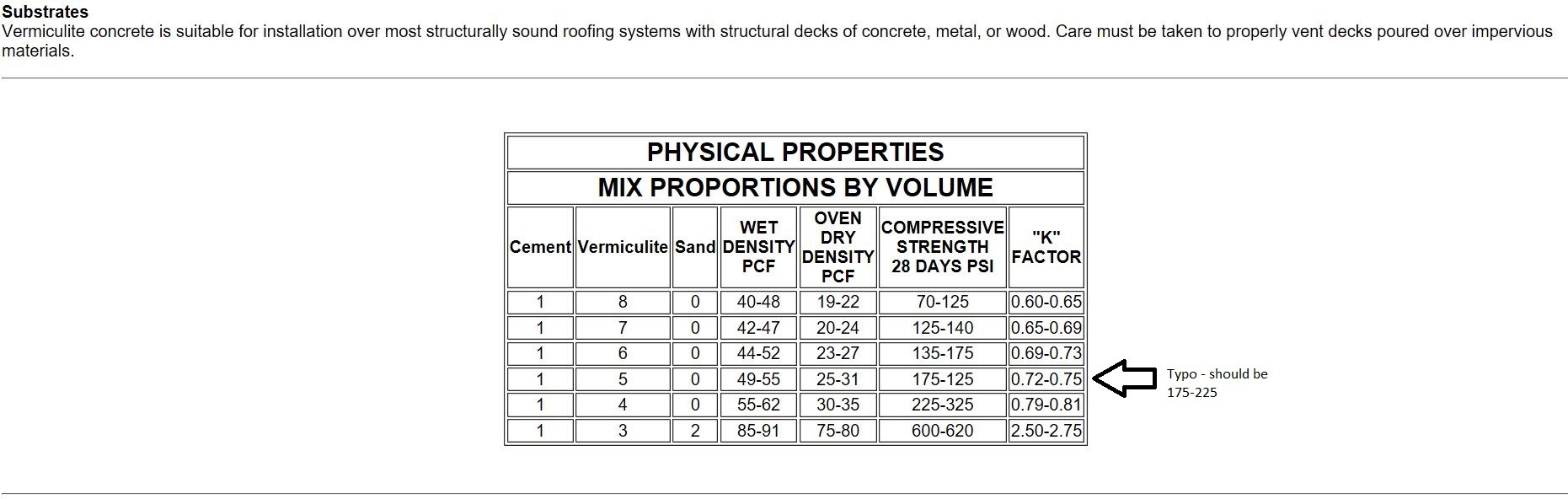

Name:	Vcrete K values.JPG
ID:	417566 8 to 10 to 1 vcrete is better for the dome, 5 to 1 vcrete is for under the floor. Attached are the K values of the different ratios. But since you are enclosing, is there a need for vcrete on the dome? I tapcon into the concrete hearth so I could tie wire the insulation down.
