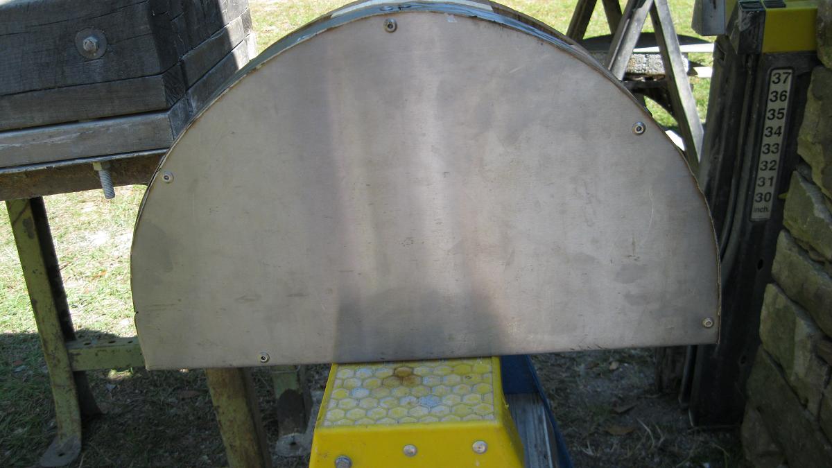

                              Originally posted by Rbhumbert
                              Thanks, The steel I used for the door is a little heavy duty, but it was what I found laying around. The plan all along was to have the rollers, so weight was not to big of a concern. The door is insulated with ceramic board and it does a decent job of holding in the heat.
                              Nice idea with the rollers Rbhumbert, my door weighs in at 15kg (33lbs) so I might try incorporate whilst I carry out some mods.
                              Here's my door based heavily on Greenmans design.
                              Insulated with 50mm calsil board and 50mm perlite render.
                              I have wooden handles to attach to the brass hex stand-offs but when fitted the door is too deep to angle through front arch without handles jamming, so I need to cut down the hex stand-offs to allow door to clear front arch whilst on an angle.
                              Liteceeper
                              My Build - http://www.fornobravo.com/forum/f51/...ide-19729.html
                              My Door - http://www.fornobravo.com/forum/9/sh...tml#post170496
                              "Not everything that can be counted counts, and not everything that counts can be counted." - Albert Einstein
                              • Liteceeper
                                • Jul 2013
                                • 90
                                #75
                                Re: Show us your Door Thread
                                Some more build photos.
                                Box spot welded 1.2mm stainless steel, aluminium front plate 4mm, timber panels screwed from back insulated with red fibre washers.
                                Insulation calsil left over bits & perlite cement.
