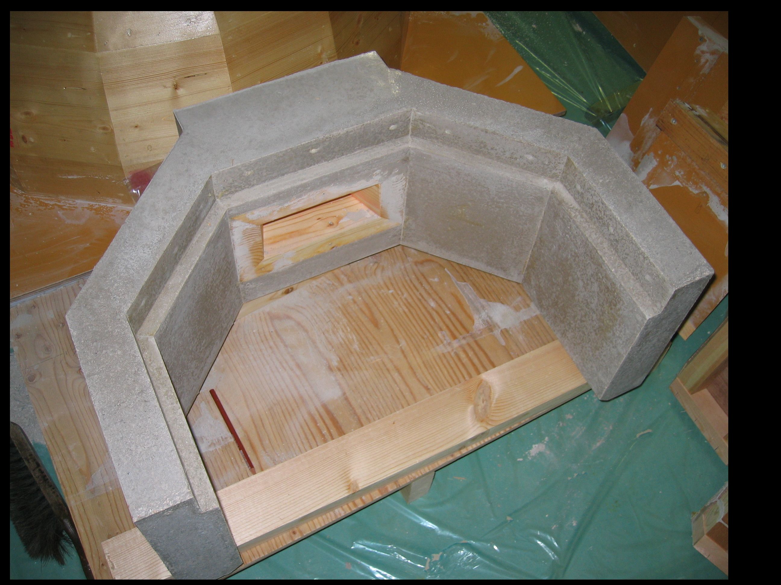

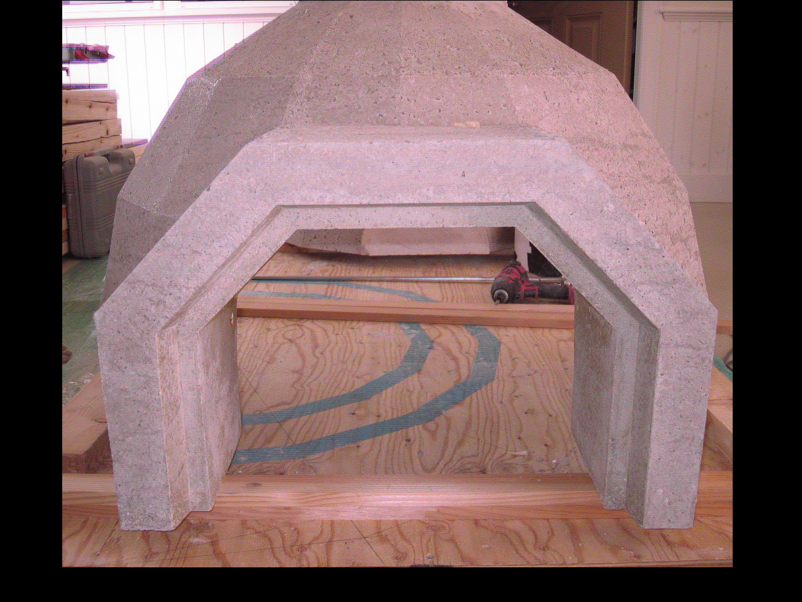

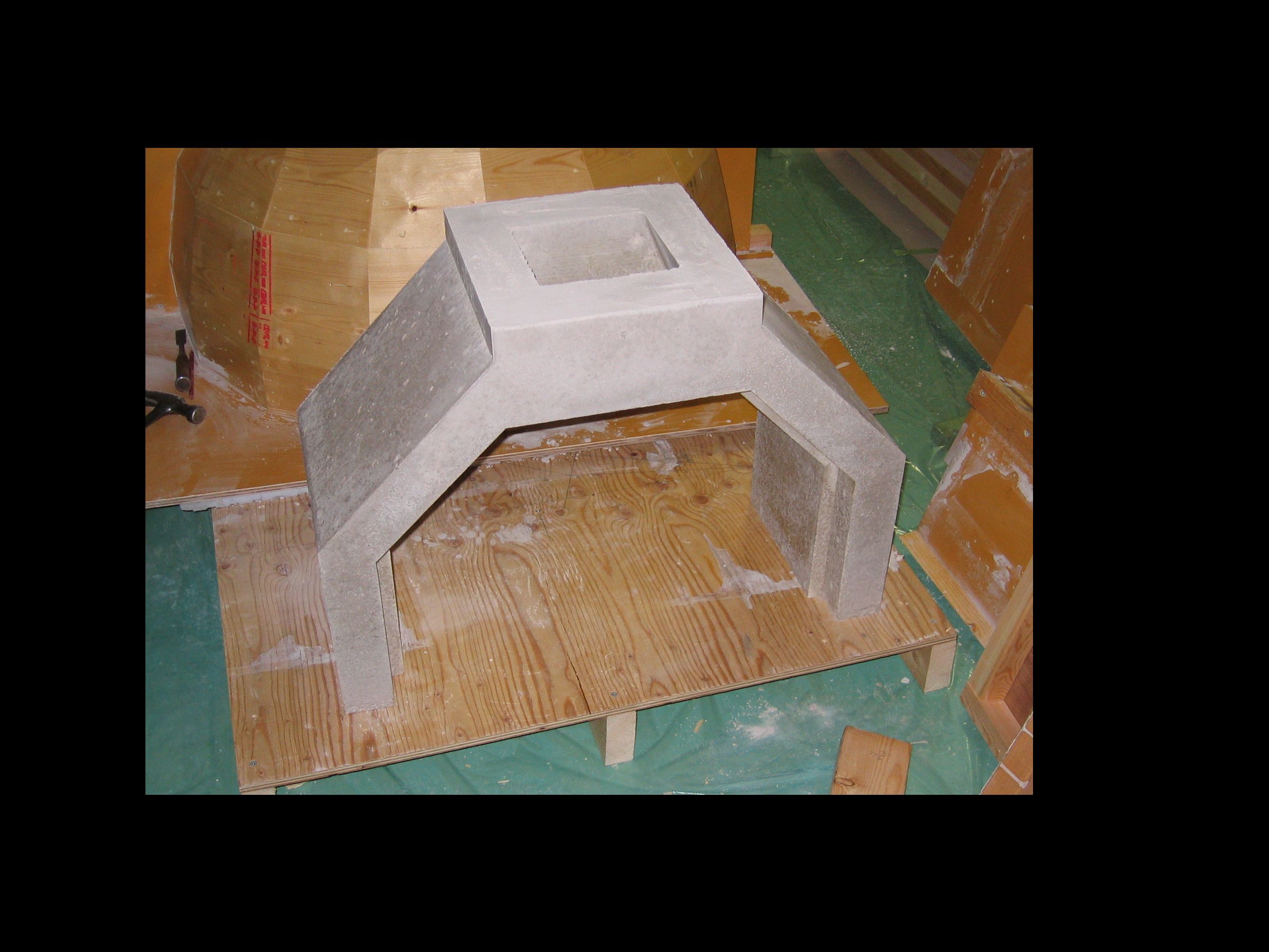

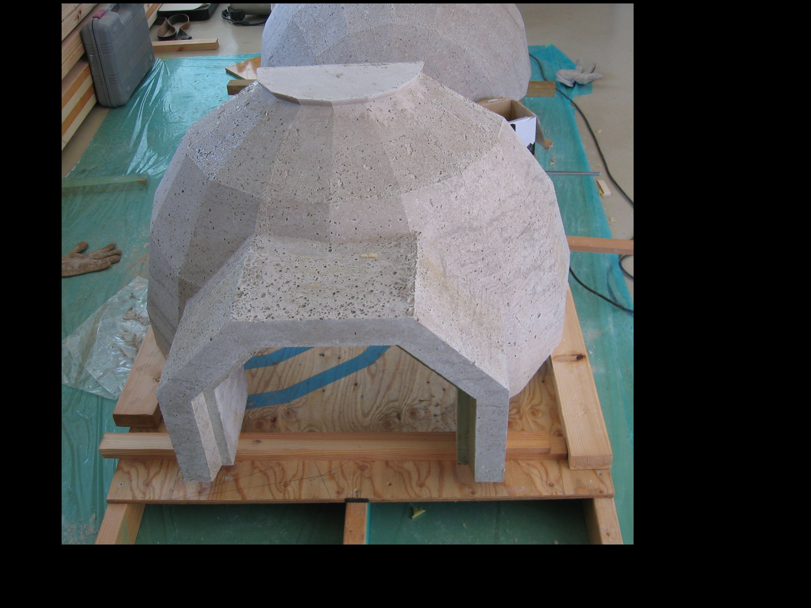

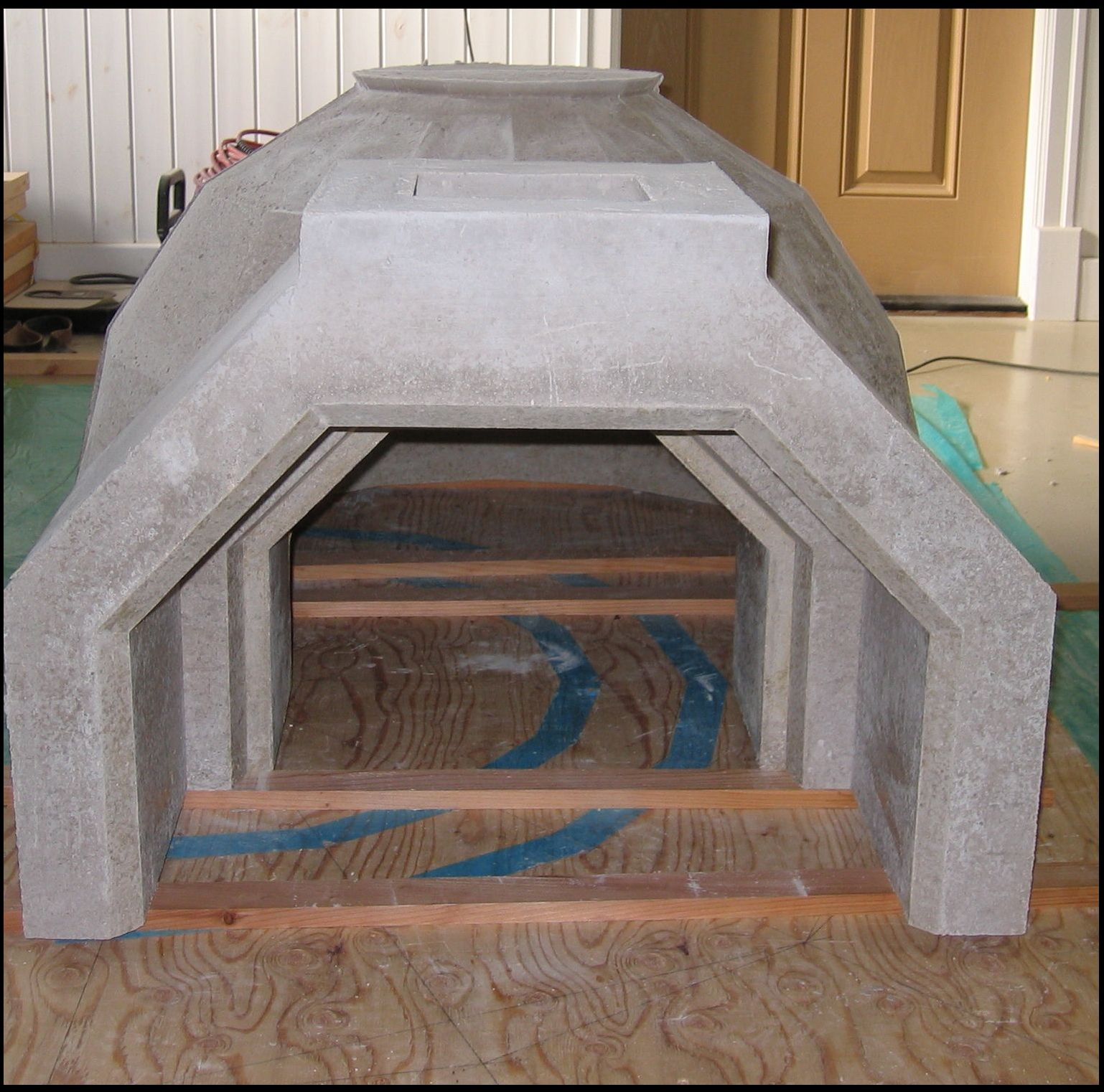

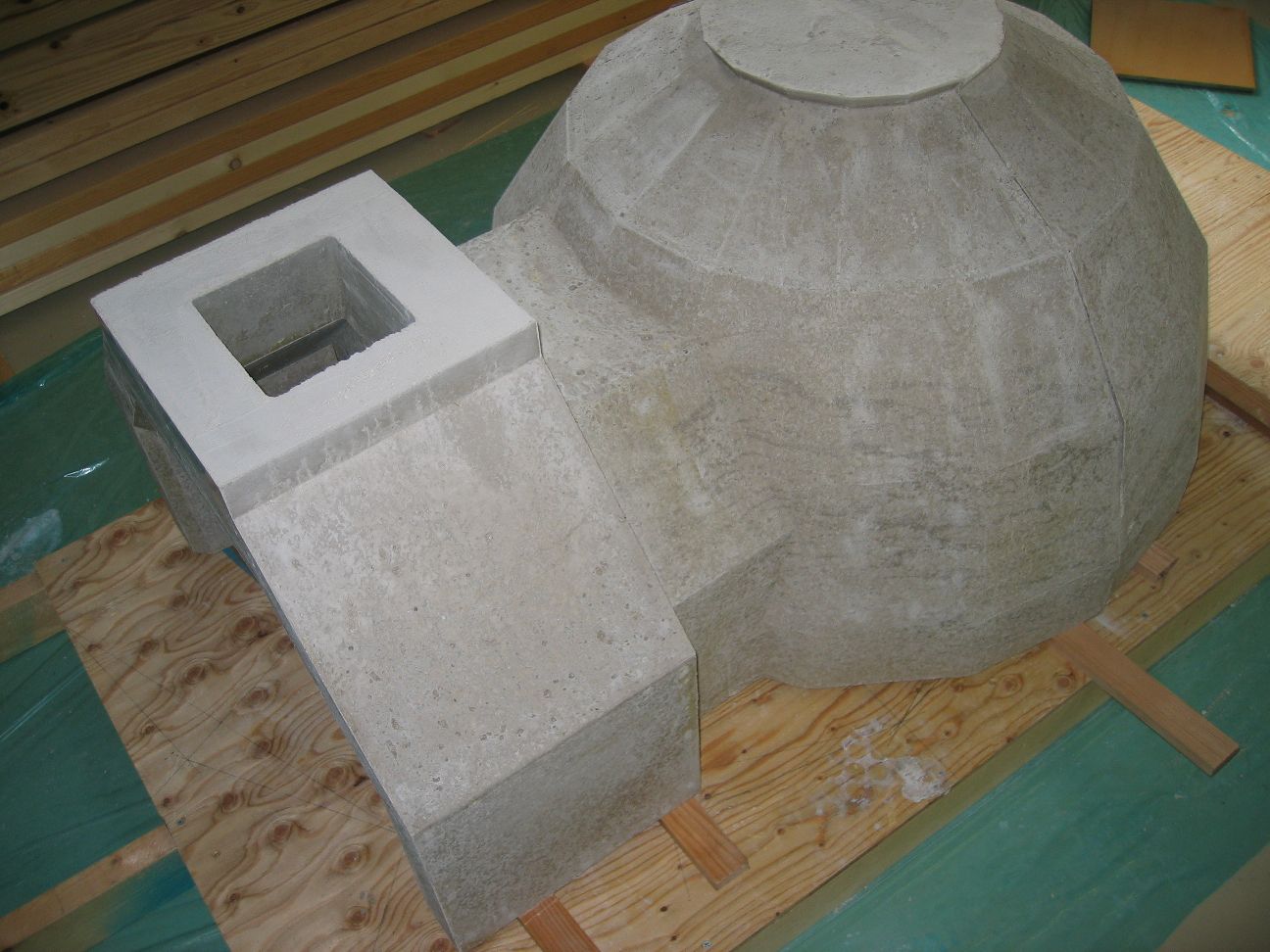

          I searched through casting photos, these give a pretty clear idea of the cast parts:
          Description:
          -first transition casting
          -another view of transition
          -front 1/2 dome section, showing oven entrance
          -another view
          -inside landing --transition to chimney.
          These are in response to : We need pictures!

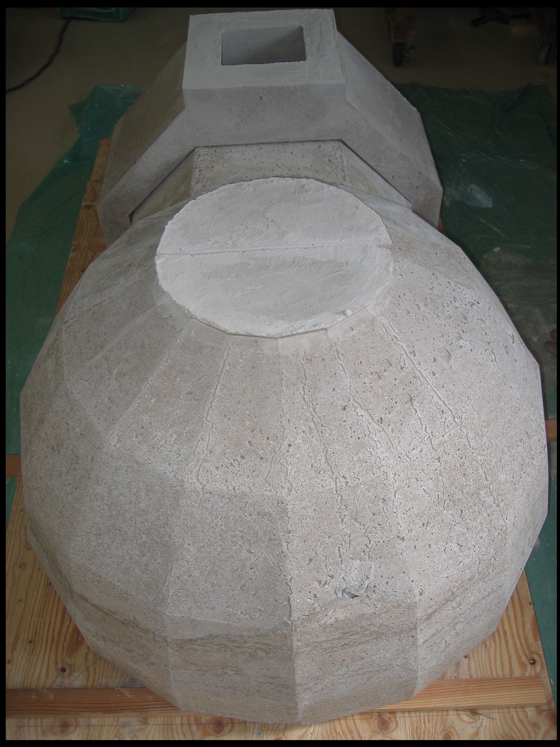

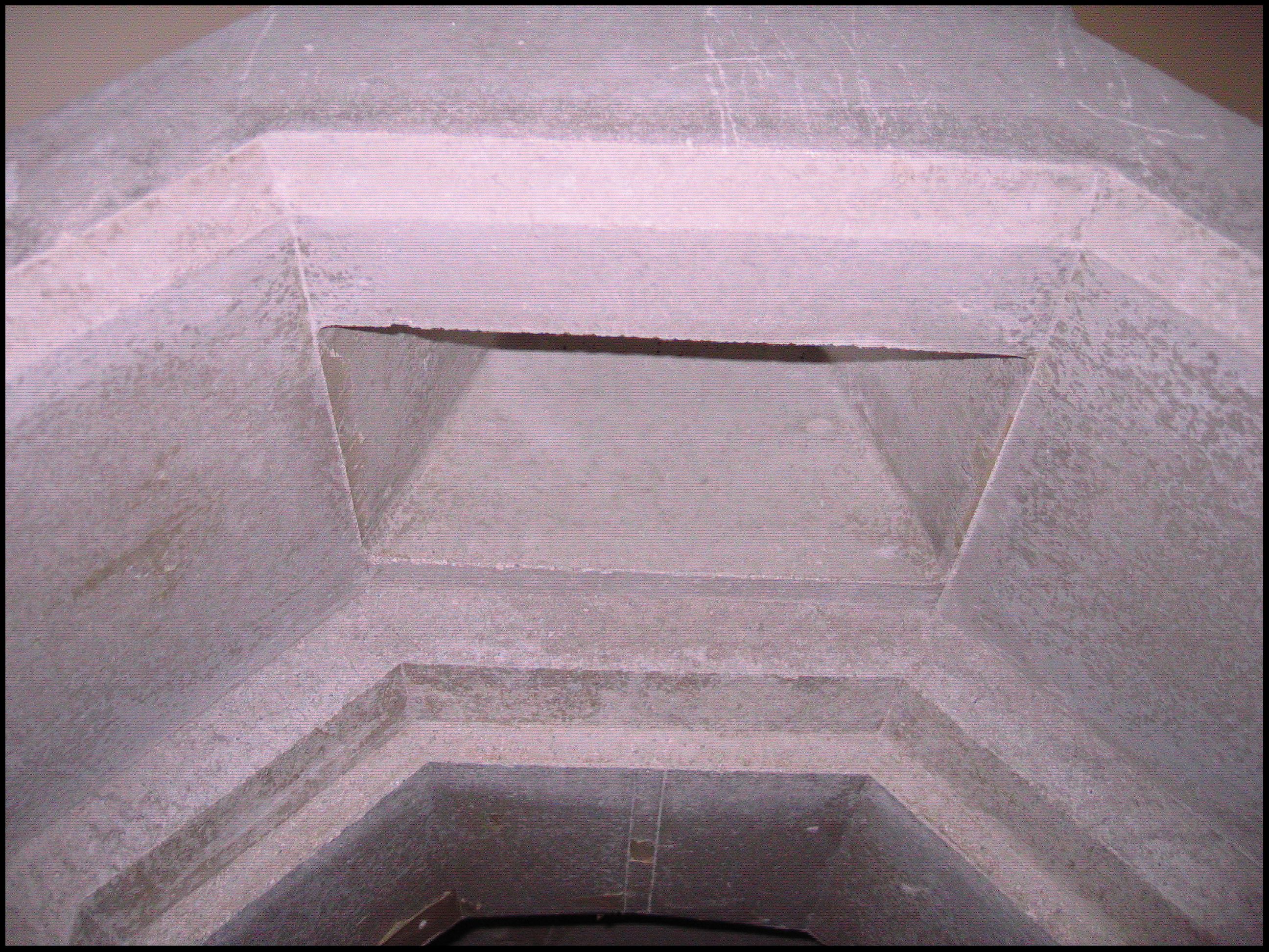

              Last casting photos:
              There is a definite difference in the finish of the casting between inside and outside, all molds were cast filling from the top. The air/water migrated upward when vibrated--leaving the somewhat course texture on the outside. The inside finish is glass smooth (or as smooth as the mold).

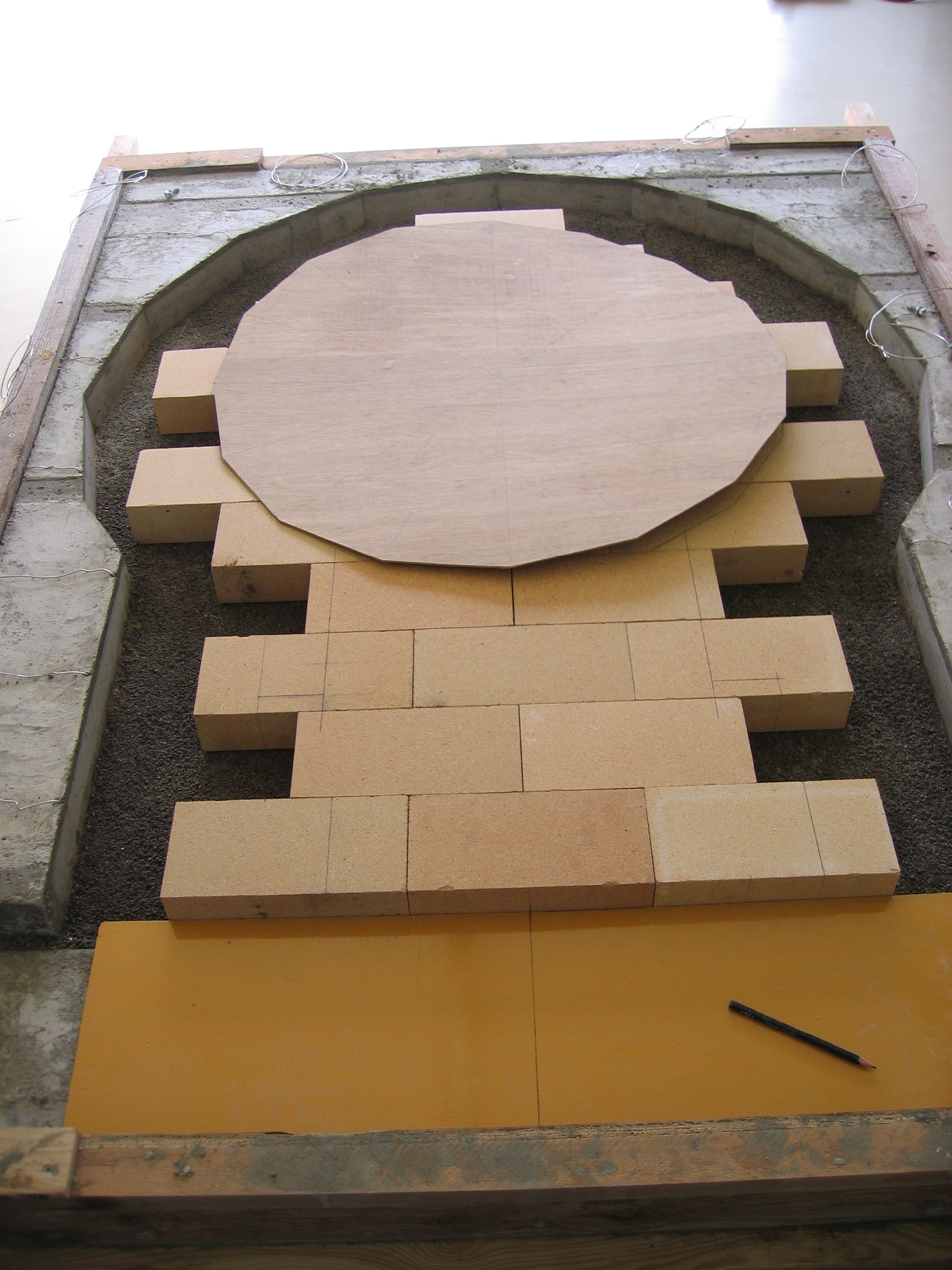

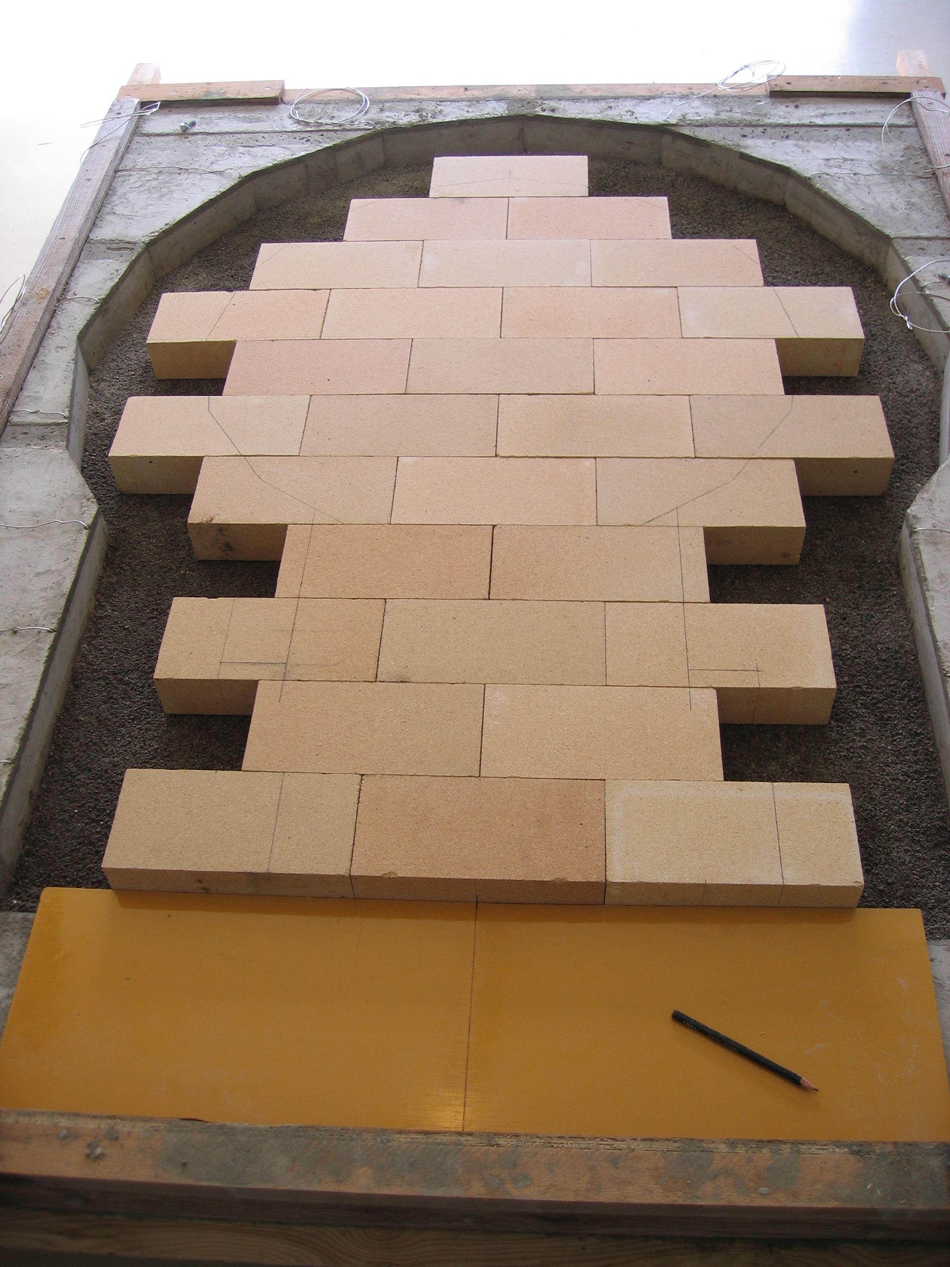

                      Russell, here are a few more pics.
                      I laid the hearth bricks out on a table, first for marking for cuts.
                      Then looked at the scale of this oven.. it is only 29 1/2" diameter (750mm).
                      I don't think I can reach inside to change bricks if damaged!
                      My wife would not have the upper body strength to do it either in such a cramped position either!
                      So, I am going to pick up an additional 6 brick, fill in the perimeter with some 1/2 cuts and place the dome on top!
                      If there is a problem in the future--options:
                      -live with it
                      -cut some tiles to fit on top of hearth
                      -tear down and rebuild
                      Any are not that big a deal!
                      Now I am thinking of some type of light weight enclosure-but plans change (daily!!)
                      These brick are laid directly on top of the pericrete layer without anything below, used a level to check straightness; swapped out one center brick and no rocking or spaces beneath the level --all directions! Think I'm going to leave it alone before making it worse!

                        Yes I am a native Utahn but travel a fair amount. A long way from the Great Lake region. Can't recall where anyone has actually had to remove a hearth brick so I think you have the right idea of placing dome on brick. Good luck.

                          Thanks-I am on my way to get the rest of the brick. Thinking now about using a very thin layer of plywood (1.5 to 2mm) to slide the castings over the brick. Then just leave it in place to burn away during the curing.
                          • #28
                            Re: Structural Slab for new WFO
                            Use could use some wood dowels and roll the oven in place the remove them one at time. Kind of like how they moved the volcanic sculptures on Easter Island. Will have to check you area out. BTW those JR Bullet trains are an engineering marvel.
