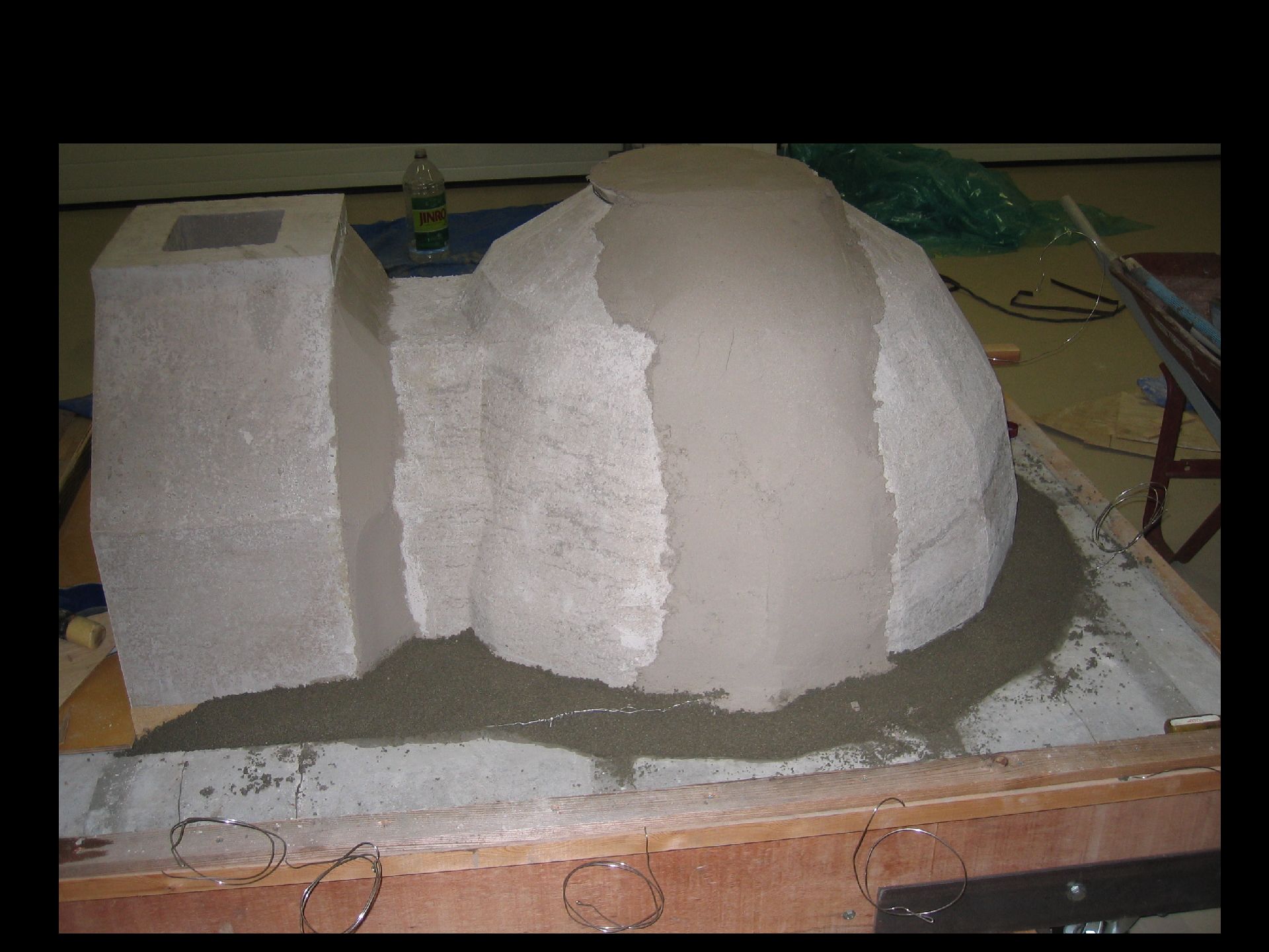

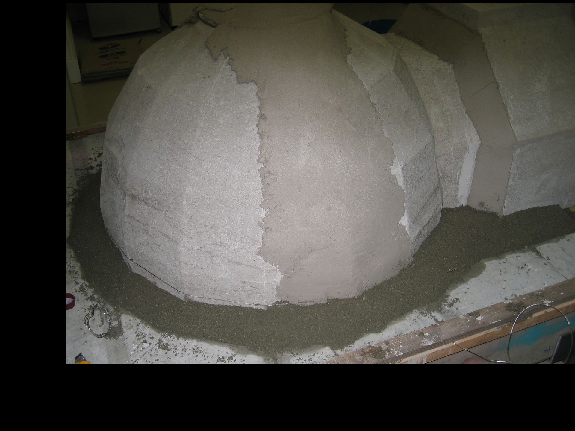

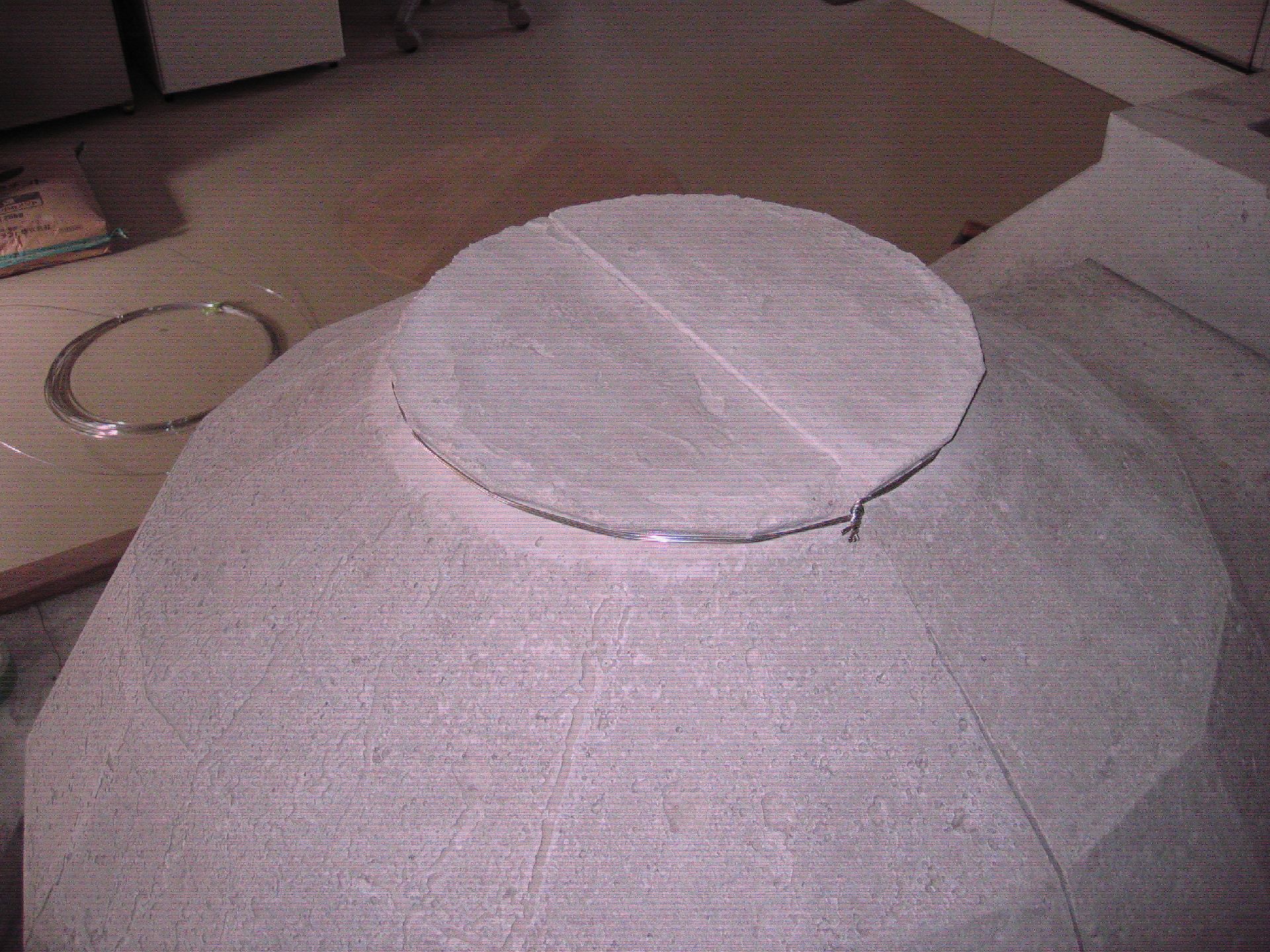

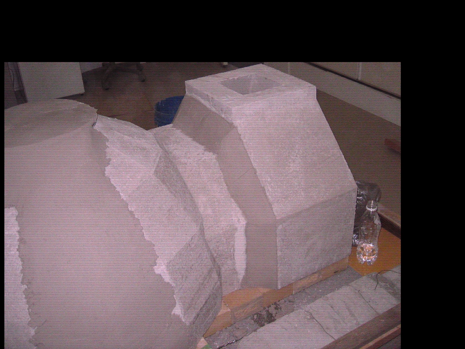

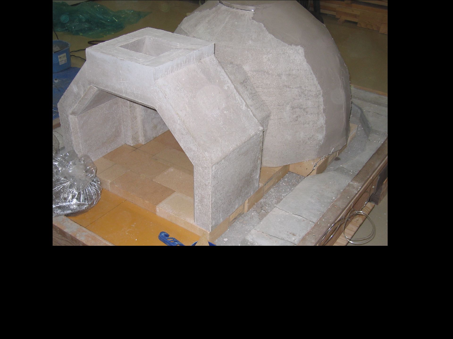

                    Ran into a snag a couple of days ago, when I altered the firebrick hearth from one that would sit inside to setting the dome on top...had to order a few more brick. Only 6! The shop that I ordered from was happy to take the order, but I did mention that the first bunch was thinner than the size they originally said they were supposed to be.. 61mm/vs 65. I told them it did not matter, EXCEPT, please make sure I get the same again. No communication problem--I heard him talk to the supplier--they said no problem- bla bla. A couple of days later when they arrived. Wrong thickness! 65 instead of 61! The "lady taking the order-swore they were the same!" So trot back to the house, photograph them, e-mail to store, store e-mails to supplier, supplier apologizes and sends a special truck with only 6 brick to the store! Got there at 6:30PM same day!!!
                    Special service! Wow! And I am in no way a big client at this store...just a regular walk-in sometimes customer. But I know the people by sight and everyone gets a chuckle at my rotten attempts at Nihongo- "the Japanese language".
                    So, today was my put things together day. Everything went great! Cut a few brick, this time dry. They were the right thickness-base was level --as is!
                    Did the "Egyptian-Pyramid Block-moving technique" with fine sand and got the other 1/2 dome section (100Kg) 220# set in place. Was able to do so without messing up the brick positions. Had pieces of thicker plywood on top of the brick, thin plywood that the block slid on top, then used a lever (made of wood) to raise the casting enough to get the plywood out. Worked like a charm!
                    I had a chance to communicate with my "special build consultant" for a bit and listened to his words of encouragement and advice. (Always appreciated!)
                    Friday, I received the trowelable castable --so today was also buttering up the joints on the dome??? Who knows if they will hold, but at least the cracks are filled. Even though I wet the dome sections, you could see right away that the water was being sucked out quickly. My hope is that at least a percentage of the trowelable will adhere properly and maybe the pericrete insulation will prevent the patches from falling anywhere when the firing/curing and future using occurs.
                    Lastly, had a little bit of perlite left over from below hearth insulation--so mixed that up 5:1 again to fill in the void between the firebricks and the structural slab.. This brings the outside practically level. This time, I did not have vermiculite to mix in. I do not know why, but the mixing required a lot more water than before. Over 50% more if I calculated correctly. I tried to get it to a consistency that it would retain its shape when squeezed and still not be able to squeeze any water out. What it actually looked like this time---was like a good mix of beach sand and water... suitable for sand castle building.
                    I really do not know how the 10:1 mix will work for dome insulation but probably just a little fluffier. If it is the intent when mixing cement into the perlite for the dome cover to simply provide a measure of adhesion and stability until a render coat can be applied, then probably this next job should be as dry as possible again!
                    Oh! Trouble now. The wife just called down and asked if I am "Still at the keyboard"!
                    Time for a few photos:
                    Sorry if my posts resemble a novel or short story... But just in case someone else right now is facing the same issues..maybe my long explanation can be helpful!
