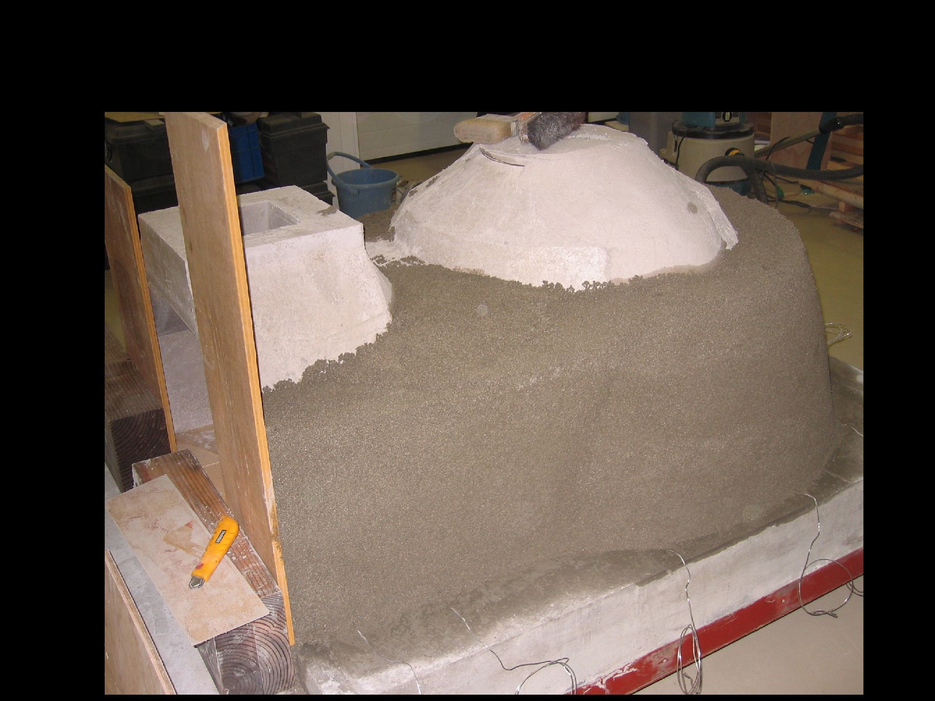

                            Progress on insulation.
                            That is far as I can go without a chimney!
                            Tried to make the top of the dome insulation thicker- but now it looks like one of the "cone heads"! A few bumps and dips--but better than I expected from eye-balling it only.
                            Just have to call it character!
                            I was surprised, this morning I was able to shave some of the edges using an OLFA cutter. The insulation is still very fragile, but it cut like styrofoam.
                            There are places where this stuff is over 6" thick--(near the inner door opening), lots of water to dry out!

                              Question time again:
                              1) I have been warned about getting all the water out of the insulation prior to rendering.
                              2) Today, the insulated pericrete dome when tapped returns a hollow type sound.
                              3) I did not clean out the wheelbarrow used for mixing yesterday--but the dry stuff left from yesterday shows no properties of firmness--simply crumbles if you roll it around in your hand. But that material was not pressed into place or tamped in any fashion.
                              4) Yesterday, when adding the second level to the dome, I wet the dome--and you could visibly see it absorbed into the refractory... the water placed on the previous days pericrete--simply disappeared with no sign of color change from absorption.
                              Here are the questions:
                              1) Does this pericrete reach an "ultimate strength" after a certain number of days?
                              2) If so--by experience, how many? Like concrete approx. 28 days?
                              3) Will it develop a structure where I do not have to be careful about bumping it without fear of it crumbling to powder?
                              4) Given the fact that this material is extremely porous, and that a render coat will re-introduce a significant amount of water... and the strength of the render will be dependant upon a slower dry (for hydration)... would it not make sense to do the render sooner, rather than later BUT leave a significant opening...like Gulf describes for venting moisture?
                              5) I am dealing with a slightly mobile build--I worry about jacking up the slab to install the wheels--and any vibration to the slab by moving... I really don't want a chunk of this insulation to fall off like an egg shell!
                              6) The other upcoming event will be a curing fire--so far "done outdoors" unless I use the "propane fire ring" technique or "heat beads" with the garage doors open. Both techniques, however, require a final burn using wood to get the high temps. This would involve moving everything outdoors via forklift and possible-bumping, twisting, etc. forces---that a render might protect!
                              My structural slab is quite rigid--visibly at least, if the base is not supported equally, it will rock rather than flex.. But this pericrete seems very brittle!
                              Only someone who has worked with pericrete can answer these questions because they have actually observed the characteristics of a 10:1 mix as it is installed and as it ages!
                              I can see no reason for anyone to build up pericrete in 1" layers over a dome!
                              I saw on another website, someone advocating the use of lime with portland & vermiculite/perlite --only reason I can see would for it to adhere easier in thin coats...But this would also decrease the insulative properties?
                              Sorry for the "longwindedness" but a lot of questions requiring answers.
                              Also must evaluate risks vs advantages in the build!

                                1.Because perlcrete or vermicrete is made with portland cement it continues to increase in strength over time. One week is generally sufficient. A vermicrete mix contains about double the water needed for hydration so there is plenty of moisture there for this stage.
                                2. Only if you are making a ferrocement boat or high strength concrete would you require 28 days. the difference is minimal (look at a strength vs time graph of concrete strength)
                                3.No it will always be weak. But it only needs to be strong enough to stand up vertically and be firm enough to render over. The more cement you put into the mix the stronger it will be, but you drastically reduce its insulating value if you do.
                                4.There is some sense in this , but water left in this layer presents problems in removal. I take the view that it is better to dry the insuation layer completely, render over it ,then seal the render layer for a week using cling wrap.
                                5. If any falls off it's easy enough to patch it up.
                                6.The reason I advocate doing the vermicrete in 1" layers is so it has a better chance to dry. If you do it all in one layer it is much slower to dry the stuff that is buried deeper.
