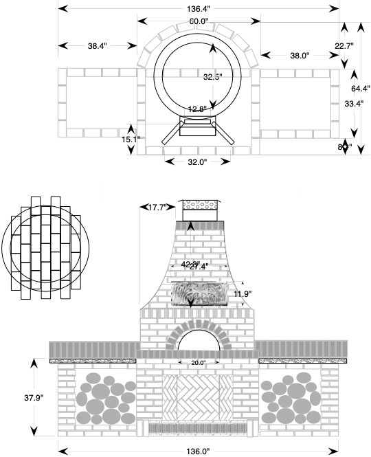

              Anyone tried to build a fireplace with a pizza oven on top? If so, was it successful? I have thought of this idea for a long time, but got sceptical to my design after reading comments on the topic. I am most worried for smoke exiting the fireplace in the front. I do not need an oven in restaurant quality and it does not need to be hot for many hours. Any comments on my design?
              Hi. I want to build a combined outdoor fireplace and pizza oven, but i'm not sure if my design will be successful. The oven will be made out of cinder blocks, firebrick and a metal flue pipe. The gap between the open fireplace and pizza oven can be closed with additional firebrick. The chimney opening will

                #22
                This is a very clever Finnish design for soapstone heater/fireplace with bake oven. Fires can be placed in either firebox. Bake oven is a bit small but beautiful stoves. Maybe the design could be adapted for your purposes

                  #23
                  Don’t know why fireplace glue couldn’t enter pizza oven from rear and exit through pizza oven flue. Could be a two door system , one that closes off flue and one further out to allow fireplace fumes to go up pizza oven flue. Could be used as a smoker cooker maybe?
