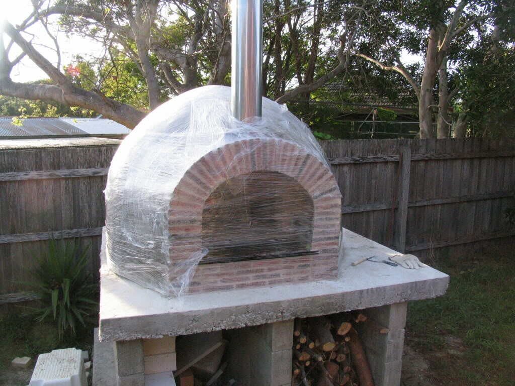

    G'day
    An example
    Always seems a bit in undignified thing to do ...., but it works

              I've just wrapped my entire oven with industrial cling wrap, can I now put the tarp back over it to keep any rain out?
                #142
                Re: new build in Brisbane - Vibrok Caminetti
                The cling wrap should be enough to seal in any moisture. Leave it for a week then wait until the outer shell is really dry (I do 10 fires) before any acrylic coat. If you do the acrylic coat too soon you can end up with moisture blisters between the render and the acrylic coat.

                        If it were me I'd be leaving that chimney unsealed for the moisture to escape whilst you drying things out. Like others have pointed out you'll be cooking before you will be sealing everything.
