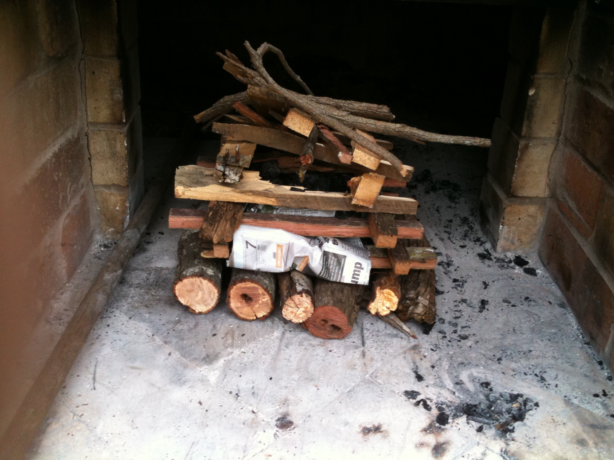

          I can see your concern with that gape between the oven shell and the entrance piece. Is it an overlapping fit like you dome?
          If you were to seal it I'm not sure what would suit. Your high temp silicon sealer? A lime sand mix? I'm only sure that a Portland one would not be suitable.
          Would Davids give us an insite?
          Regards Dave
          Ps "don't go over to the dark side young Luke" stick at the top down method. You'll be a one match bushie in no time

                Unlike the dome, there is no overlap between the dome and the entrance.
                If it needs sealing I think I would use the same high temp silicon I bought for sealing the flue - though it will be hotter there so maybe I should use that flueseal product I linked back a page or two - if the consensus is that it needs to be sealed. It seems David-s thinks it will not be a problem.
                As for my firing - no plans to deviate from the top down method, I just need to get more heat in there to start the fire which a propane torch will do quite happily

                          #117
                          Re: new build in Brisbane - Vibrok Caminetti
                          G'day
                          Splash a bit of metho ( denatured alcohol ) on to some charcoal left over from a previous fire ..... Instant firefighters no Kero smell!. My problem is finding newspaper sometimes we only get the Sunday paper and I've got to hide it before the child bride throws it out. The funny colours in the flames coming out of the advertising phamplets disturbs me a bit.
