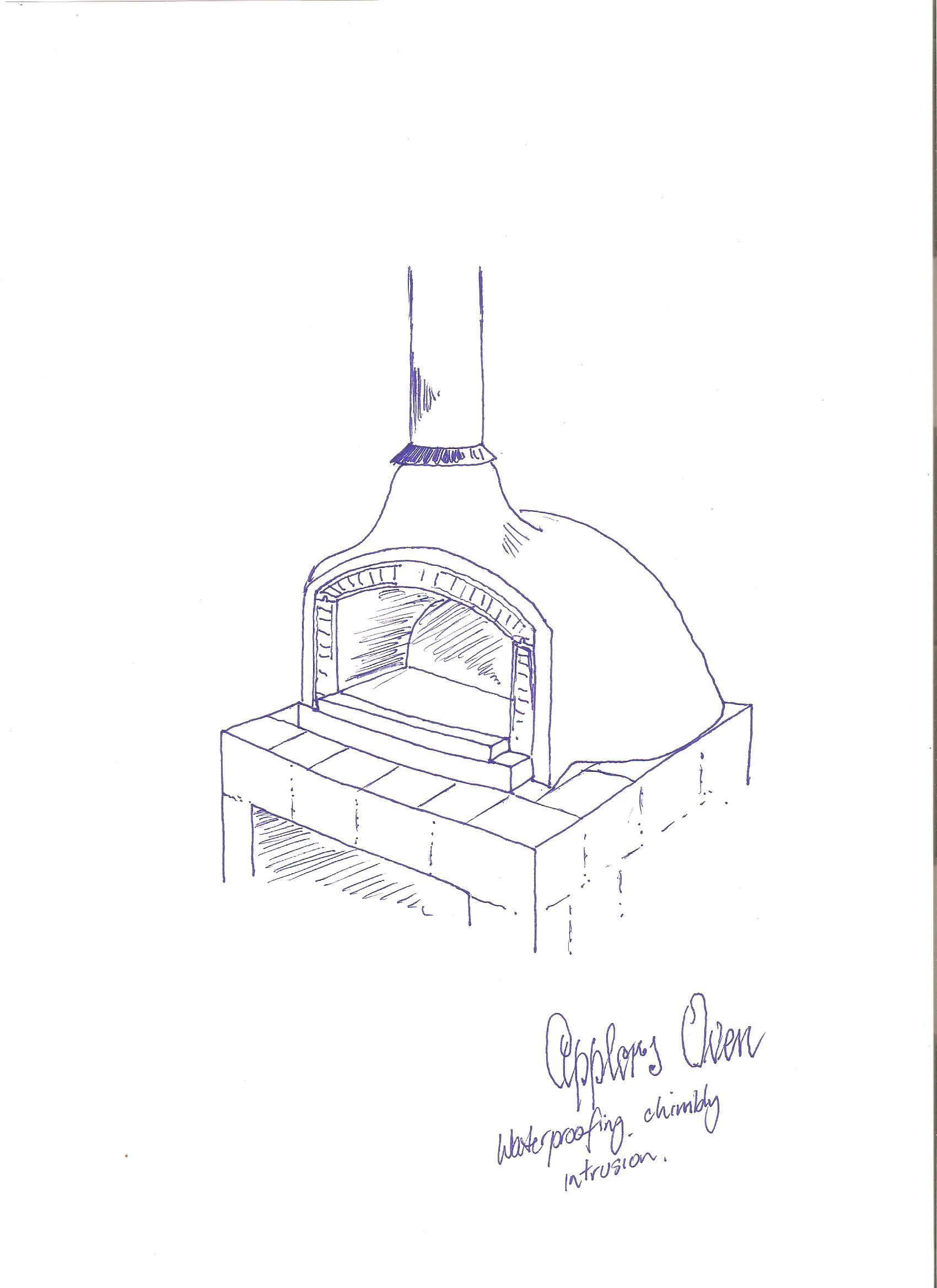

            G'day Gulf
            I agree except with the positioning of the overhanging shield, it can be right down the metal chimney
Name:	applors oven 001.jpg
            Davids has mentioned this before as its going to crack around the union put a piece of cardboard when rendering up to the pipe. This leaves a gape to the insulation layer that is shielded from the wheather ......and there you have a built in vent to release any water from the insulation layer! And its conveniently located at the top point of the oven. Bonus.
            Now the tricky bit, is such a shield piece available? couldn't find much in Queensland and of course had no idea on size.
            So plan B is to make one.
            Googled The Hospitality Super Store in the "valley" and sure enough in the serving trays section there are a heap of different sized stainless steel trays with the sloped edge. $10 to $20 bucks depending on size. Recon any competent metal shop sound be able to fit that to the current chimney.
            regards Dave

              Re: new build in Brisbane - Vibrok Caminetti
              Thanks for the advice (and pic guys. Just wondering though could I not just leave a gap using cardboard and then fill the gap with a silicon sealant of some sort to waterproof/seal it and act as an expansion?

                G'day
                Yes you could but silicon sealers will not take that sort of heat. My doors stuck together with that but is due to it being used at 300C minus that it works at the back of the insulation!
                Their are high temp sealers available, but will they survive the 600C that will be going up that chimney? And for how long?
                Davids build ovens ... He never mentions that ... But he still puts a lot of input here. Good solid advice. That comes from experience and care in what he does.
                So if you do go with the high temp sealer please report back on your experience.
                      Thanks Gianni, tho I think you give me too much credit lol!
                      David/dave - thanks for the info. If high temp silicon holds up okay, I don't see why i'd bother with a cap as well when the silicon will seal it and keep it waterproof.
                      I will use cardboard as a spacer around the flue when I render. I am a little concerned I won't be able to remove the cardboard afterwards tho:/
