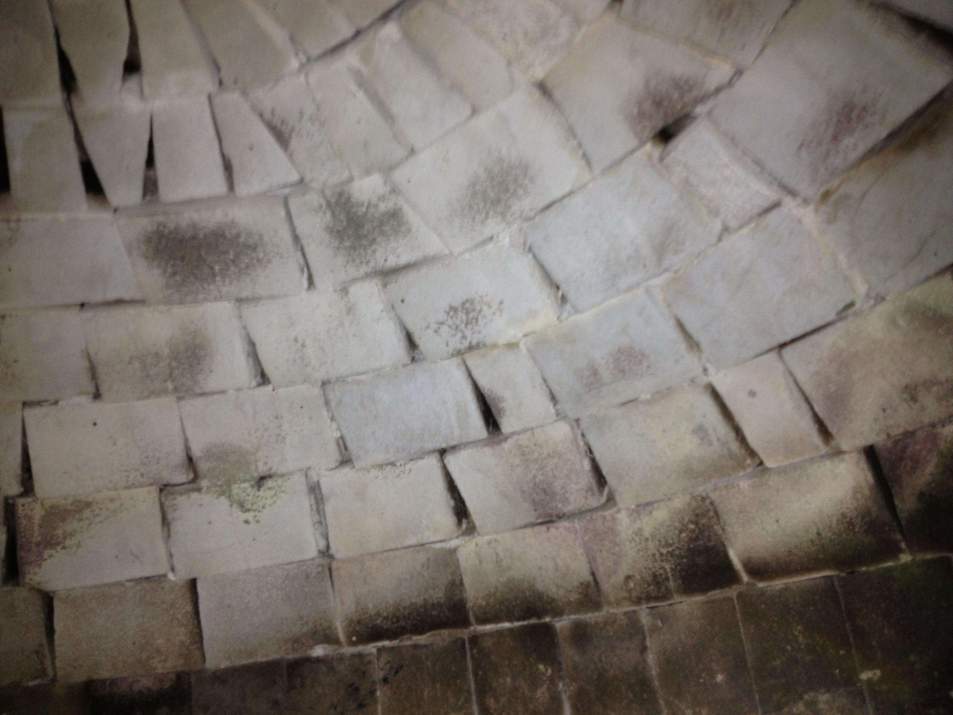

                I put off starting the arch and worked on the sixth chain. As those inverted V's pop up...how important is it to fill the voids on the inside of the dome? WHen I put on too much mortar, the bricks didn't line up/squish up right. Not enough mortar, and I get them voids. It gets messy filling the voids on the inside, so I'd rather leave them be if I can.
                Question #2, I got a brick that's not level, one corner is popped up about 1/4", which makes the next course out of level. Can I take a grinder to it, or will this possibly loosen up other bricks? Is it better to chisel it out and grind it down? Either way will disturb other mortar joints, I suppose.

                  Round ovens and square brick have been around long before bricksaws an other fancy stuff. Live with the dreaded Vs clean the mortar off the face and get on with it.

                  The mortar will be your glue till that last brick goes in the gravity take over and structure depends of gravity for its strength. The mortar now holds the bricks apart and be the cushion when the oven expands and cools.
                  That brick that pokes up a bit perhaps you would be better to adjust the bricks above rather than disturbing it and the surrounding brick.

                    I agree with Dave, shave off the 1 or 2 bricks above the one that is sticking up, no one. Will ever know but you and it will keep every thing below nice and solid.
