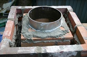

                          That SS sleeve is quite thick at 1/8" it will have enormous power when it heats up faster than its surrounding brickwork and could fracture your brick courses. Or is that ceramic blanket you have surrounded it with, pre-empting the problem? I cracked castable refractory on two ovens a few years ago using SS at 1.2 mm thick and casting directly up to it. They both cracked in the same place.The vermicrete is ok because it has some elasticity.
                          Dave
                          Hi Gulf,
                          As I am about to finish the chimney, I would like to ask you behind the reason for insulating around the flue chimney when it is completely separated from the dome. The Chimney chamber doesn't have any thermal bridge connected to the dome. So why the insulation? Thanks

                            It wasn't done to retain heat in the oven. My roof over the oven is wood framed. Wood framing was thought to be sort of "taboo" at the time of my build. But wood construction is what I'm most comfortable with. The code was for 8" of masonry for a chimney. I wanted to narrow that down to save weight and dimensions. I cut it down to 6" by cutting the outer face brick down to 2" and then filling with vcrete. That was an overall savings of 4 " diameter of heavy masonry. More work and time on my part but the IF thermometer readings and the moss growing on the side of my chimney says that it's efficient
