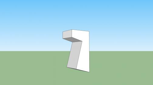

        Kind of like that, but a little longer to give a "wedge" for the arch at the bottom
        Cuz I love sketchup soooo much, here's a picture of what I was thinking:

          That looks good from here (here where I can't touch the actual oven or know if that shape cut from one 9 inch brick will be tall enough to do the job).

            DJ and DVM, I may end up using a cut like that to fill in the gap between the arches.
