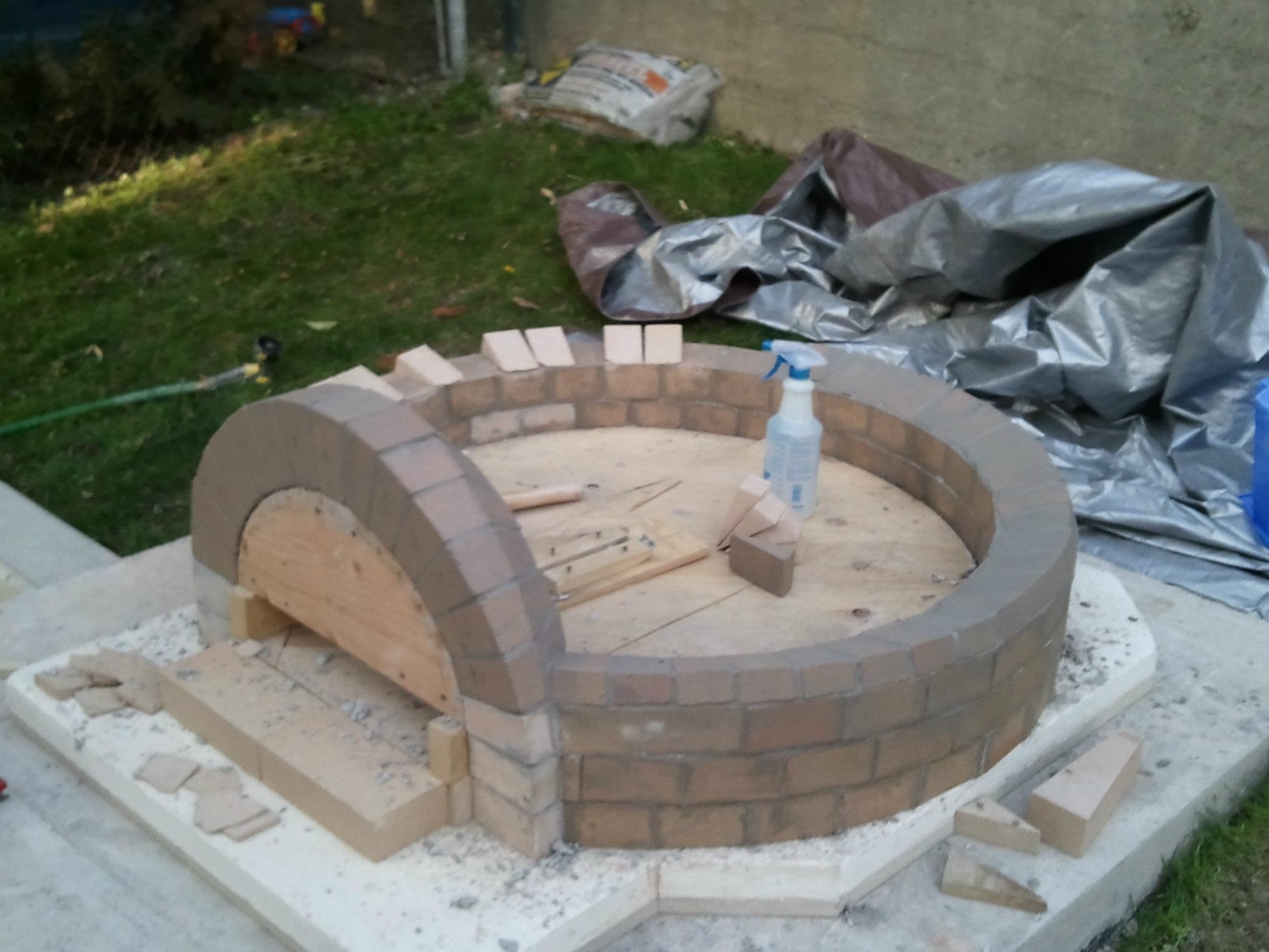

                          Inner arch, what is the minimum and maximum thickness?
                          I assume you mean depth? you want it to project maybe an inch beyond your dome at the bottom. At the top it will probably be 3-4 inches.
                          Once you set where you want the face of the arch to be, that dictates the depth if you are building it the way Russel, John, Amac, myself and others did.

                            Yes I did mean depth.... So if I started at 1" beyond dome wall at the bottom....I should be less the 1 full brick 9" at the top with a 4.5" dome wall......I was concerned it would be more than 1 brick at the top.....Looking at your picture it looks like it should be less than 1 brick, although yours looks like your dome has a few courses of level bricks before your began your dome. Looks like I may need to play a little more with my IT to confirm if I start the dome after the first course?? Thanks for your input?? like they say a your picture is worth a thousand words .
