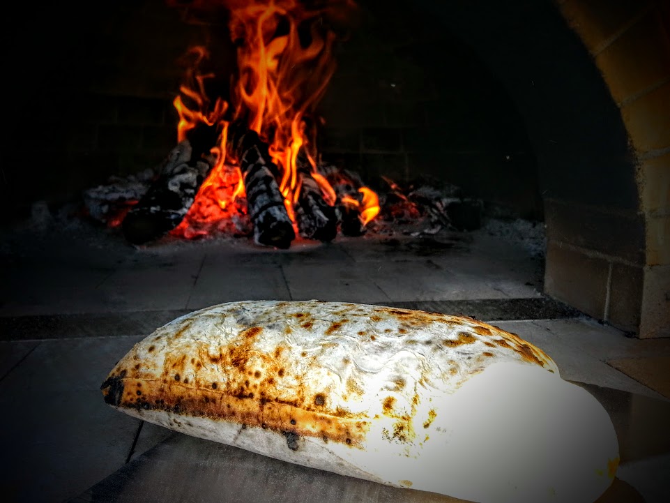

Lots of good progress!
So am I correct in thinking that the outside arch is going to be lower than the current opening? As it stands, you're going to get a lot of smoke coming out the front of your oven. But I am guessing your plan is another row of bricks that will act as a constrictor on the throat of the entry?
...............I like the gothic arch.
