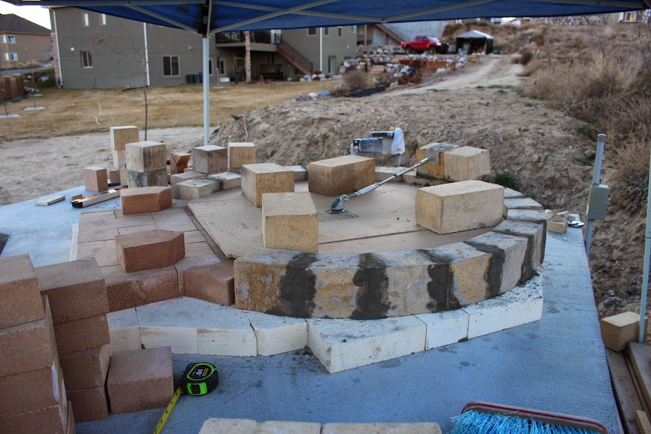

            So I moved the floor back 8" today and attempted to get working on the arch...
            I got a inner arch template from Russell but he used a different size of brick and I'm not certain I will be able to make them the same size. I do however have the standard size left but how should I go about making the taper. The 10" HF saw I have wont cut deep enough on one pass making it quite difficult to make the taper on the brick. Can I get away with no taper to the inner arch bricks?
            I did a home brew mortar using the fire clay from the cuts I've already made. What should the mortar consistency be? I read that for the 3:1:1:1 that you use about 2 parts water. That wasn't quite enough for me it seemed to dry so I added about 2 1/2 parts. It was a workable consistency not too dry and not soupy. Definitely seemed like I needed to apply it pretty quick though as it would dry fairly quick.
            As you can see I am using some Behemoth bricks. The first two courses I'm using these larger bricks and then I'll begin using the standard size.

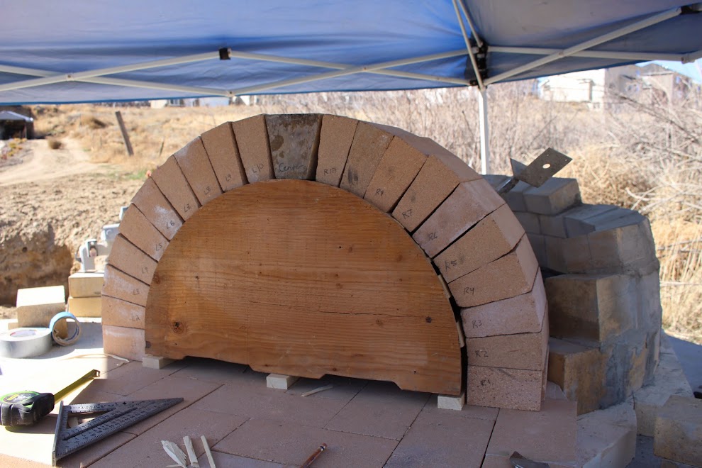

                Well. I got all my inner arch bricks tapered yesterday and then today I cut the inside dome portion of the inner arch bricks as well as where the top blocks will be sitting. I then began placing and making sure they would fit nicely.
                Things looked good and that center brick was a pain to cut because it was one of the behemoth bricks that are super high strength and very very hard!
                After mortar the big brick didn't even work so I ended up actually shaving down one of the normal size bricks and I think the front looks pretty decent.
                The back isn't quite as clean. Will it really matter though during dome construction?
                Let me know what you guys think but I think things will be just fine. I ended up floating the interior arch on top of the floor not mortaring it to the floor. Let me know what you guys think. Suggestions for corrections or tips for the next steps. Thanks!

                  Nice arch! the imperfections won't really matter as your dome joins the arch. If you have a 4" grinder (or bigger) you can smooth it some if you want, but not required. I built mine with the same technique (arch complete) as you and i think it is the best way. The dome comes right on up and you have tricky cuts where the dome meets the arch, but other than that, it goes smooth. Just watch the margins and keep the joints staggered. Good job.

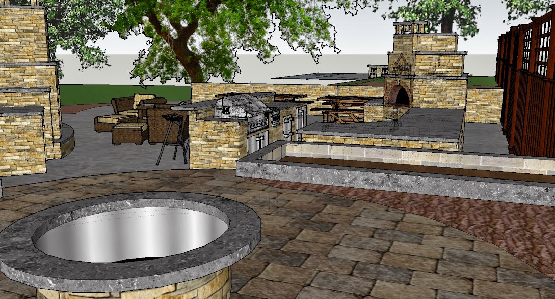

                          Thanks Rand. Looks like we'll have very poopy weather till Friday so in the mean time I've just been tinkering with design and renderings of the final product. I may have gone a little overboard and I haven't included the lighting yet but so far this is what I have.
                          I am going to have a ton of firebrick left over I think so I have been toying with the idea of a fireplace but we'll see how much I can actually do with what I have left when finished.
