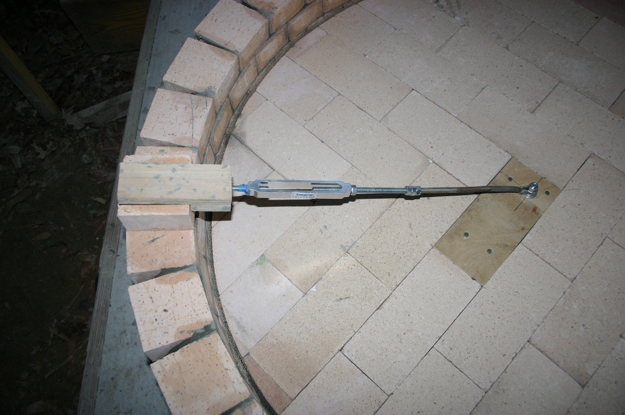

                I made a mistake and am using particle board of the cheapest kind for my floor attached to my IT.
                It flexes and twists with the heat.
                Should I go buy a real piece of plywood or something nice or simply leave it?

                  I replaced my "dead center" floor brick with a temporary "wooden" brick. Then covered the floor with cardboard.
                  That was after chunking the wobbly plywood floor for something more stable .
