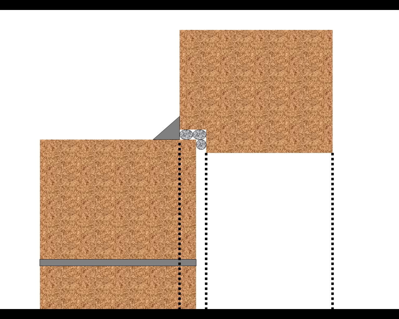

    Chip I have a question. For the heat break gap could I fill it with just blanket scraps or should I use ceramic rope? And what should I ask for for sealing the gap on the inside, so I know what to ask for at SS.

  • mrchipster
    replied
    Re: Randy's dreams do come true oven build
    Originally posted by gastagg
    OK, I have two questions on Chip's diagram, which I wrote on the diagram. I can be a slow learner...
    yes and yes

  • gastagg
    replied

    replied
    What ever method you choose, don't forget the reveal! One is not shown in your drawing as is in Chip's .

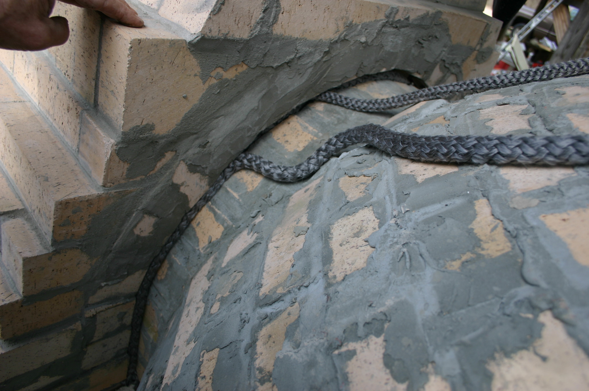

    does the rope go all the way around? if so, how?
    Yes, stuffed in from the back side. It is open as you build the flue arch.

  • mrchipster
    replied
    Here is what i did but please look at the earlier entries on this post for more details on the heat break.

    I would love to see an elevation drawing with a cut from front to back going through the floor and the arch of what you guys are talking about re the thermal break with some suggested dimensions showing where the rope, caulk, etc. goes.
