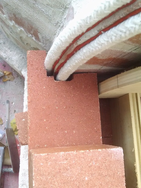

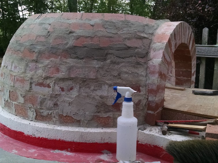

With my dome arch being 4-1/2" thick, you can see in the first photo that the arch bricks at the base of the arch project maybe 1-1/2" out from outside face of the dome. As the arch goes up in height, the dome curves away from the dome arch, increasing the amount of projection. The projection reaches its maximum with the top dead center arch brick.
At the base of the dome arch, the bricks don't have to project out at all. That would allow you to have a "less thick" dome arch, possibly saving you a couple of inches in your footprint.
The reason I built the way I did was based on how I wanted my vent arch bricks to integrate with the dome arch bricks. I wanted my vent arch bricks to wrap around the front face and side of the dome arch bricks, but I did not want to mortar them together as I wanted them to move independent of one another. I used two lengths of ceramic fiber rope to 'seal that gap'. You can see that in the second photo.
