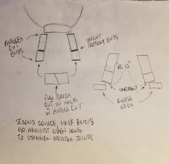

          2) My only real comment here is how are you detailing the finish surface of the landing arch opening? If you can successfully hide the angled brick ends at the front of your landing arch I don't see it as a factor at all. If those angled back brick ends will mess with any arch face geometry in terms of your finish detail? Meaning, will any part of those angling back arch bricks show as a reveal? If you have a reveal and the arch bricks angle back on the sides but not on the top, it might make for an uneven mortar gap which may or may not look sloppy and may or may not bother you. It might be easier to square everything up now. You know your finish details, so you can make that call.
          If your landing is 1-1/2 bricks deep, in general, ~13-1/2" deep? When you cut your bricks in half, cut them with a slight angled cut to provide two identical half-bricks each with an angled cut on one end. Use one angled half-brick with a full brick on the left side of the arch, the other angled half-brick on the right side also with a full brick. You'll cut an angle on one end of each of your whole bricks as well, just as shown in your first photo. There's your first course.
          With the sides of the landing arch being flared outwards a bit, and with the top of the arch being not flared, but flat/level? The length of the brick course will decrease slightly as you move towards top-dead-center of the landing arch, going from 'flared' to 'non-flared'. Not by much, just a fraction of an inch. No math calculations or measurements will be required though. Just keep the face of the landing arch bricks even with the face of your arch form. As long as the form itself is plumb/vertical, the face of your landing tunnel arch will be plumb/vertical. The top will be quite easy as the chimney vent hole will be there.
          I hope all that makes sense!
          EDIT to add a drawing. Hope that helps clarify my text. Left side of drawing shows full and half bricks with one end of each cut resulting in a clean face. Right side of drawing shows my concern, that an uneven gap may appear at the face of the landing arch, but that depends on your finishing detail.
