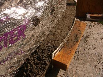

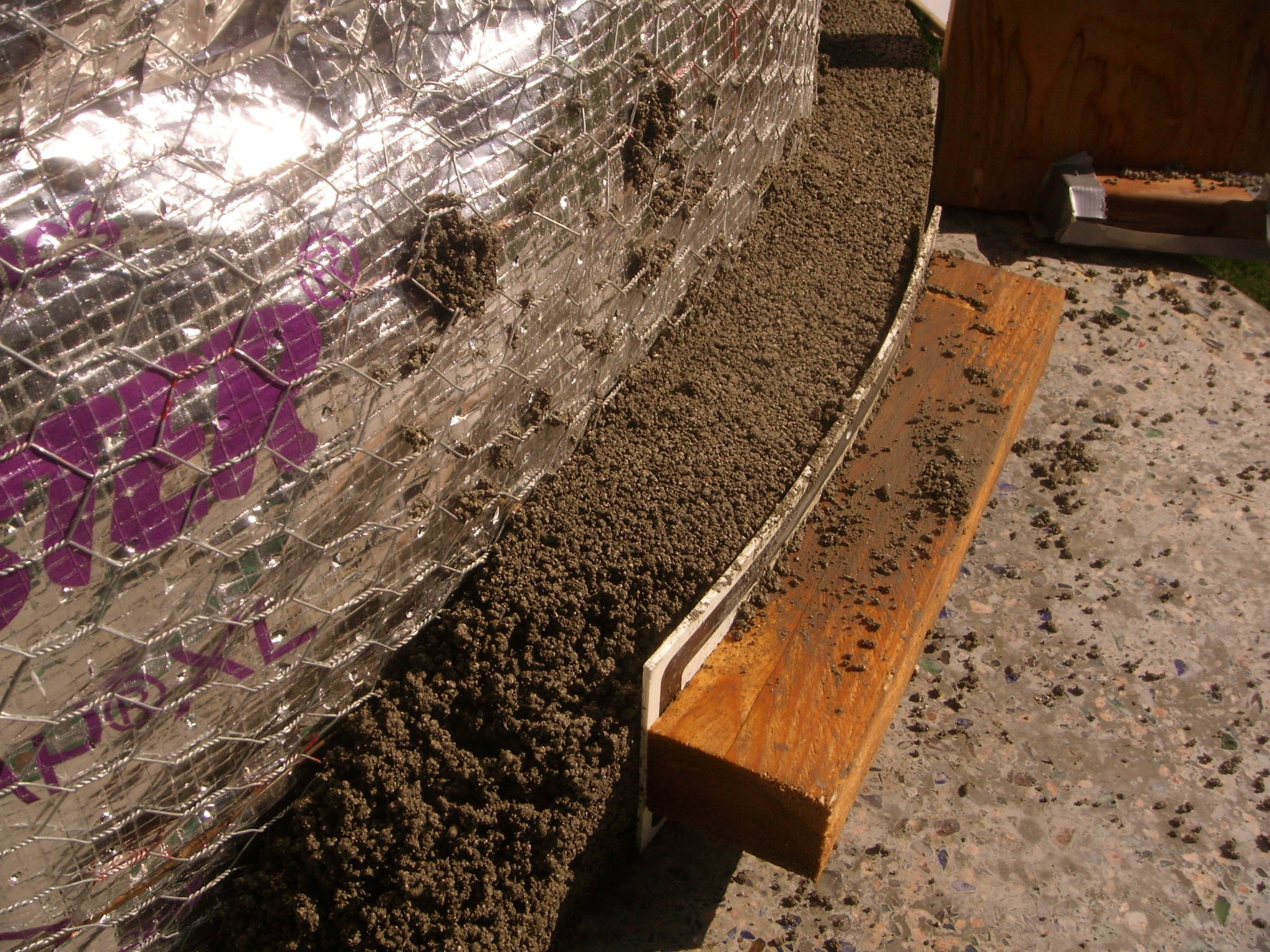

              • Make yourself a curved trowel to place the pcrete, it helps with forming and pressing the material. Click image for larger version

                • UtahBeehiver Thank you…I was wondering if they sold something like that or not…what is the material you made the curved part out of? A plastic?

                    • The curved part is just an old piece of scrap semi flexible plastic from a sign. I think Gulf made his from a piece of aluminum.
