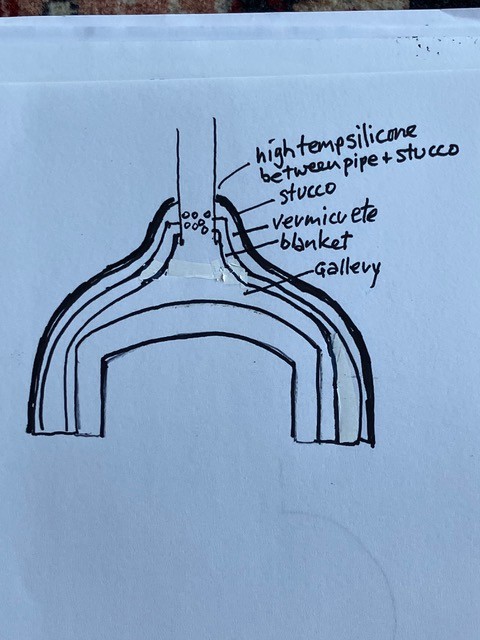

                      #205
                      Originally posted by david s
                      Another alternative to having an exposed vent at the top of the oven is to ask moisture to exit through the flue pipe. By drilling a number of holes in the base of the flue pipe that is surrounded by insulation, moisture will find its way to the base of the pipe and exit with the smoke. See pic for explanation
                      Wish I would have seen your post regarding this an hour ago. Just ordered some 1" copper pipe to construct a vent with china cap like this:guy https://www.youtube.com/watch?v=rqBkNOTdnUk
                      I do think there is some benefit to having the vent at the highest point of the dome as well, I think it would be wise to incorporate your idea as well
