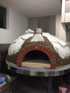

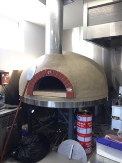

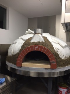

      • Up to you, but if you have the extra blanket, paid for it and have the room to install it, why not use it. It can be way thicker on top, which is where it will get hotter anyway. The vermicrete or perlcrete will even out the form of the uneven blanket. Here's an example of two layers of blanket on the sides, because that's all the room I had, but 4 or 5 layers on top.
