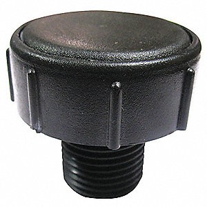

        Most auto supply stores or the Big A store carry what are called hydraulic breather caps with plastic ones around 10 bucks. The plastic will not melt, it is not exposed to high dome temps since it only needs to penetrate to the outer layer of the ceramic blanket.

          UtahBeehiver and Gulf Thank you…I ordered one from the Big A store and picked up the metal one from my auto parts store and just see which one I like better both from a cosmetic aspect and function and ease to lock into some chicken wire under my pcrete.

            I advise the plastic. In case there is an accident, of some kind, it could break away without causing damage to the oven's outer shell. Plastic can be painted for cosmetic reasons imo.

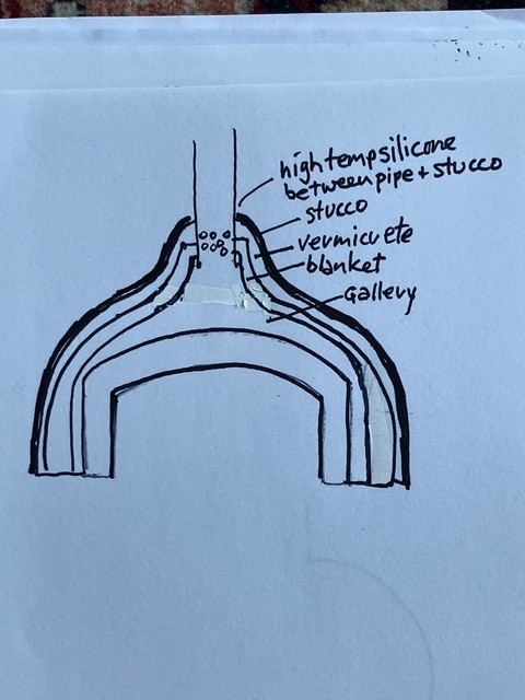

                    Another alternative to having an exposed vent at the top of the oven is to ask moisture to exit through the flue pipe. By drilling a number of holes in the base of the flue pipe that is surrounded by insulation, moisture will find its way to the base of the pipe and exit with the smoke. See pic for explanation
