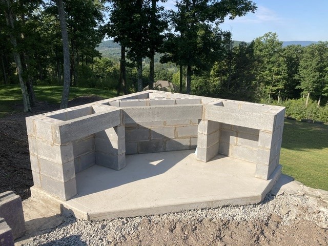

    david s.... I think you can see the four holes I drilled in one of the above pics. I marked where the rebar was before removing the forms so I wouldn't hit them with the drill bit. I'm sure it was much easier after three days instead of after the concrete has cured.

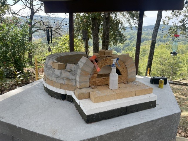

                    Life got busy and I had to put the oven on hold for a bit. Wasn't expecting it to be three years though I had to try to recall all the sage advice on these pages and bring myself back up to speed. The pics will show where we are now.

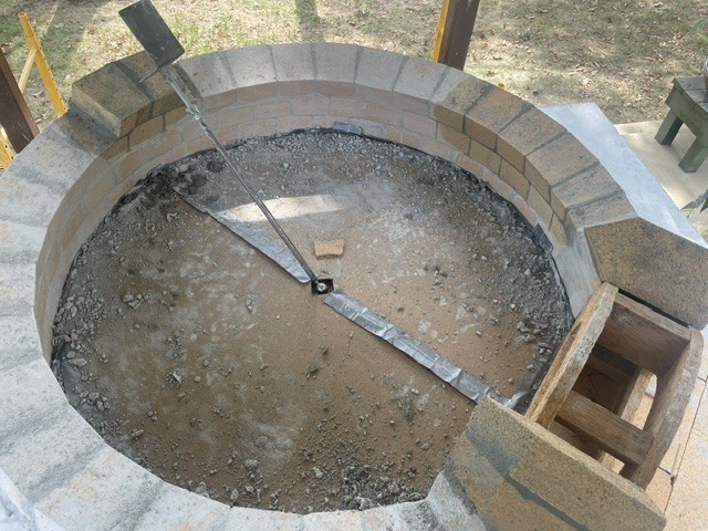

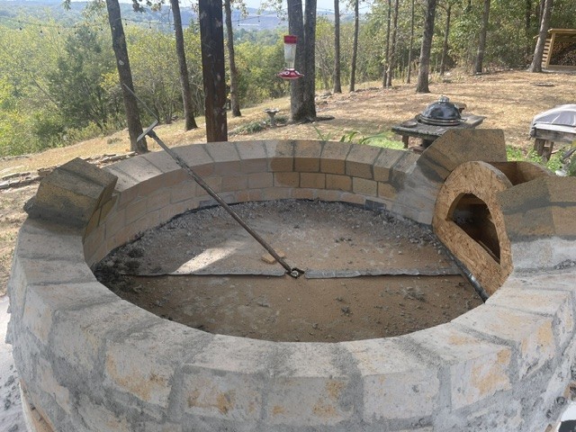

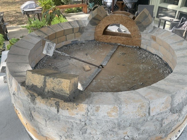

                            Finished the 3rd and 4th course. I'm painfully slow and had to stop when the extended heat wave was so bad in August and Sept. Better weather really improves my work ethic and the mortar is easier to keep hydrated. Please feel free to offer any thoughts or criticism of the work.

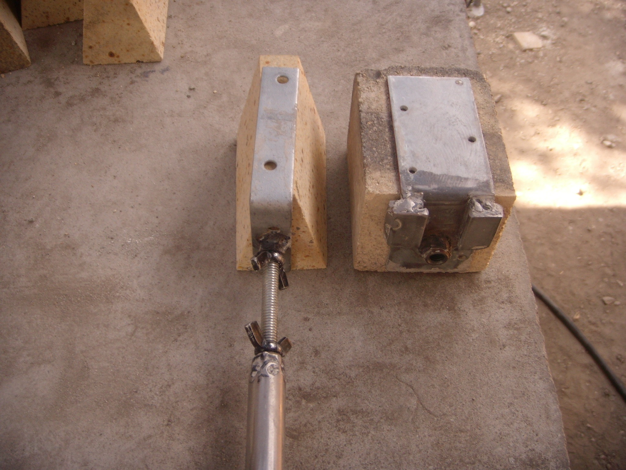

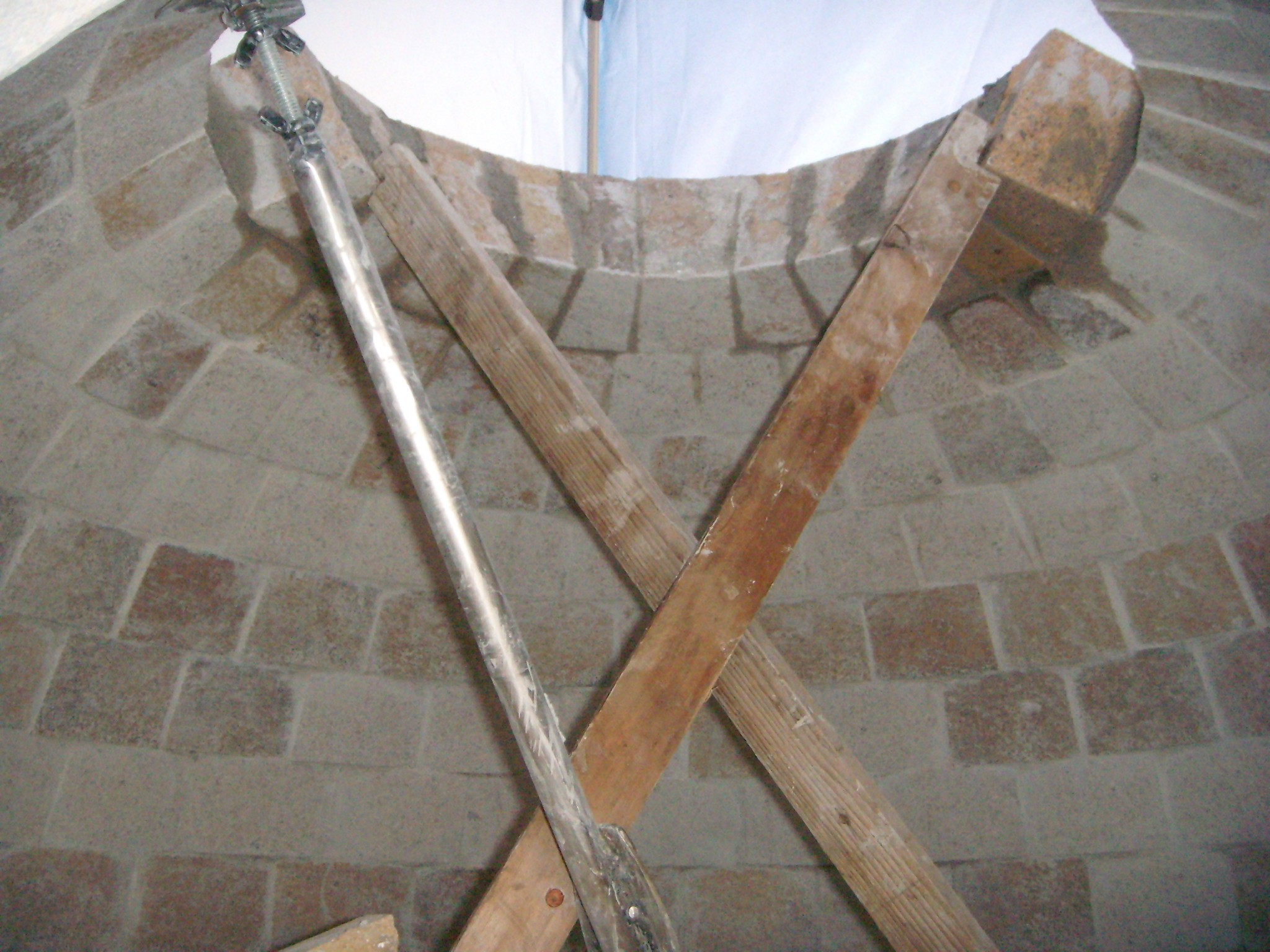

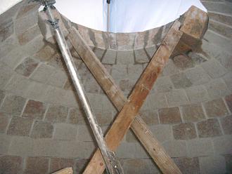

                                Looks like everything is well in hand. Nice job in tapered inner arch. Internal brick joints are staggered nicely. As you move up in courses and the bricks get smaller you may have to reduce the width of the end of the IT and or resort to using notched sticks to hold the bricks.
