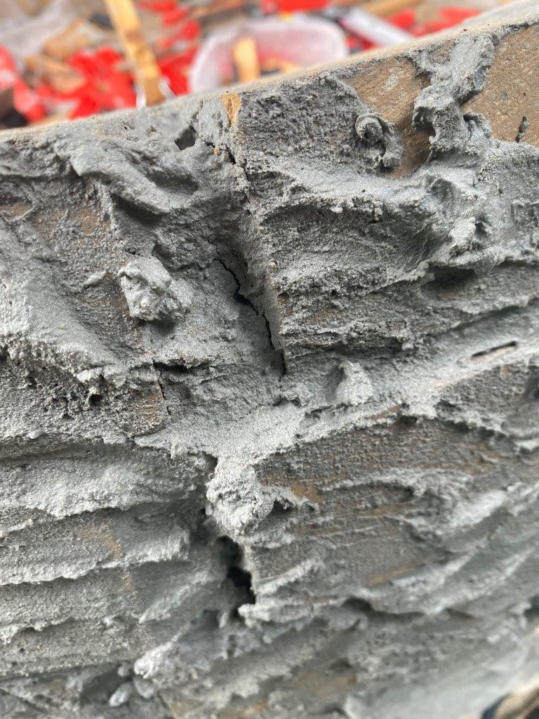

      Thanks for the homebrew advice, just finished lathering it all up
Name:	2022-06-24 08.32.54.jpg
ID:	447404 Click image for larger version
Name:	2022-06-24 08.32.51.jpg
      Works really well, but already at the drying, I noticed some cracks. I presume this is from not soaking it to much. I tried to soak them, but was doing this at the end of 2 warmest days of this year, I presume the bricks were really dry
Name:	2022-06-24 08.26.44.jpg
ID:	447402 Click image for larger version
Name:	2022-06-24 08.26.48.jpg
Name:	2022-06-24 08.26.42.jpg
      As it was not fully set, I just took out a sharp knife, and removed most of the ones that did not set. It was not a lot, but there were 3 on the entry arch, that I did not like. I will make sure to wet it completely, and than re-fill with the homebrew, does anyone have any other advice?

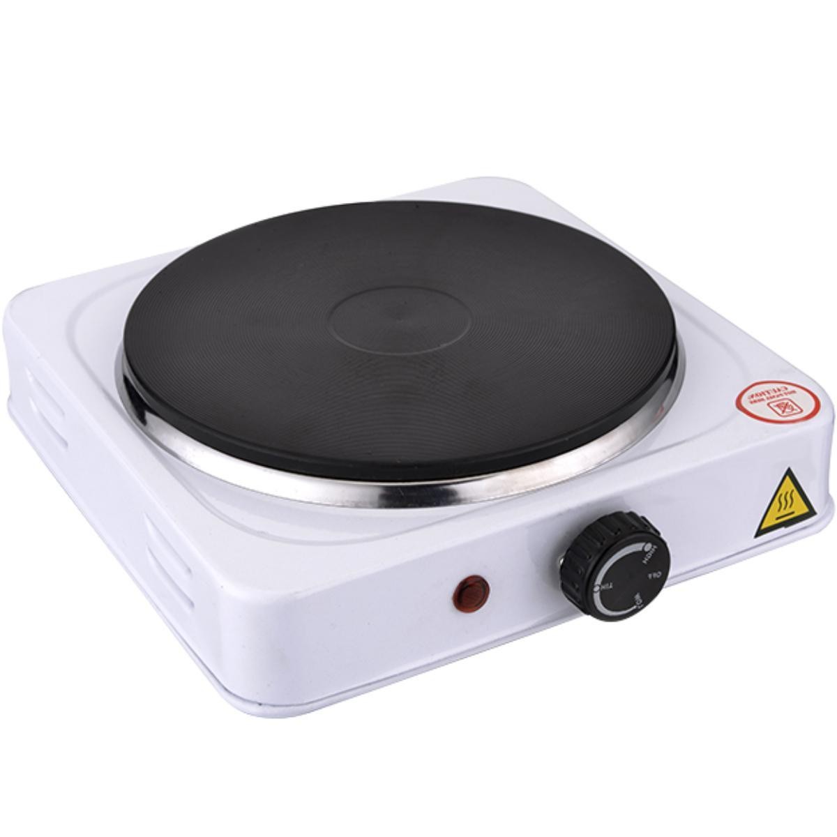

                          Another very idiotic question.
                          Has anyone ever tried to get a electric stove, like this,
                          or any other electric heater, and leave it in the oven for a week or so to cure the oven?
                          Is it to warm, or not warm enough, just wondering on this.
                          Regards

                                Bear in mind that this type of heater is not designed itself to withstand higher temperatures. Just the insulation on the wires and the lead are vulnerable.
                                Just as there are safety problems with using a home gas burner, the reason we've agreed not to discuss them, so to an electric heater that's not designed for this purpose. Far safer and more instructive to use wood. BBQ fuel which doesn't produce flames like wood is also useful for reducing flame impingement on the dome.
                                Here's the recommendation for the drying fires for my ovens, but bear in mind they smaller and are cast, not brick and therefore a lot thinner so the times and amount of fuel required will vary from oven to oven as well as the quantity of water that's required to be driven out.
