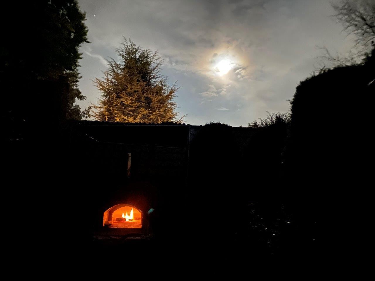

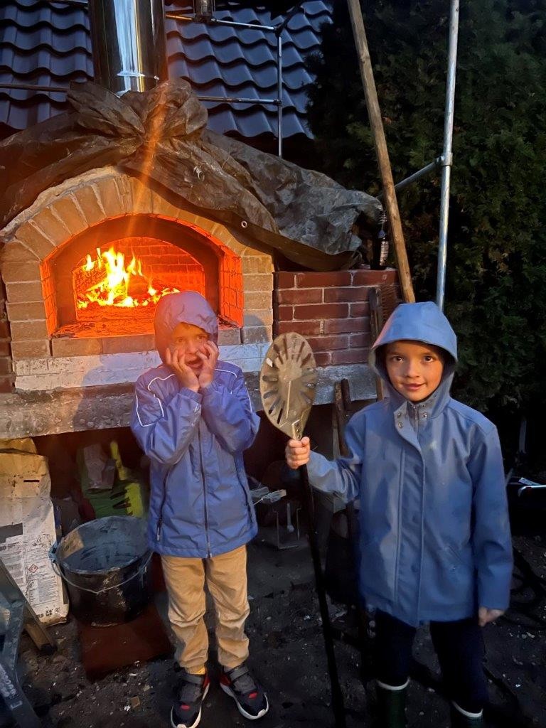

      I took it quite slow curing fires, and a couple of nights ago, I had a lovely full moon over the curing fire

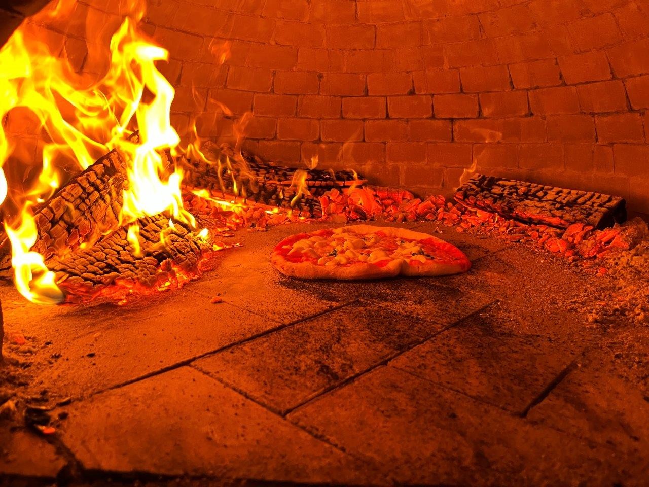

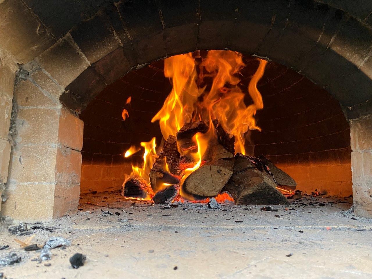

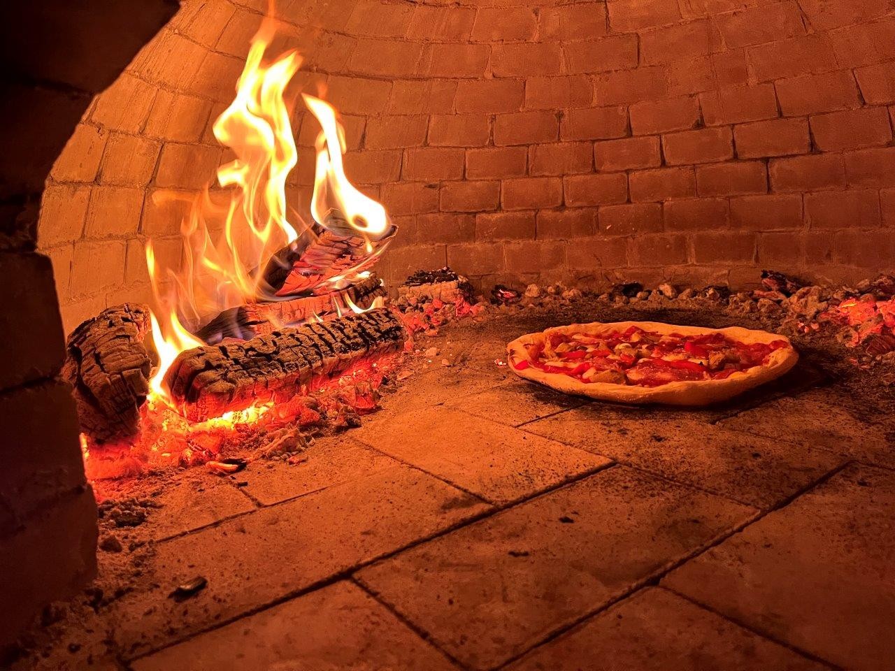

          I think the curing fires are complete, but still not finished with the enclosure. Approx two thirds of the work is complete.
          Luckily, I did some fires where I reached full temperature, to test it. This oven is really a magnificent thing.
Name:	2022-09-24 21.53.44.jpg
Name:	2022-09-24 21.54.57.jpg
ID:	449925 Click image for larger version
Name:	2022-09-24 19.00.43.jpg
Name:	2022-09-24 21.53.57.jpg
          The finished product was amazing!!! Followed the recipe of the pizzeria Da Michele, from Naples. We were there earlier this year, and it was magnificent. In all honesty, this thing that we made, was not a million miles away from what we tried in Naples. 24 hours of raising dough, good temperature, simple ingredients, cannot go wrong with that.

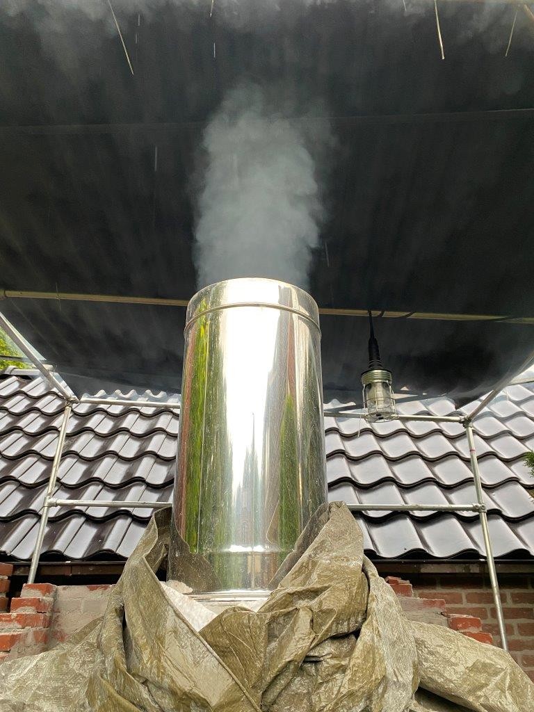

              • #82
                Originally posted by Sixto View Post
                My oven's location between the garage and the house seems to makes the chimney smoke swirl all over my backyard when any light wind comes across, and could be causing draft issues... maybe I need a taller chimney?
                I also saw the swirls sometime, so tried to put the extended chimney, and the smoke immediately cleared my garden, and the neighbours garden. The added chimney is one of the easiest ways to improve the WFO

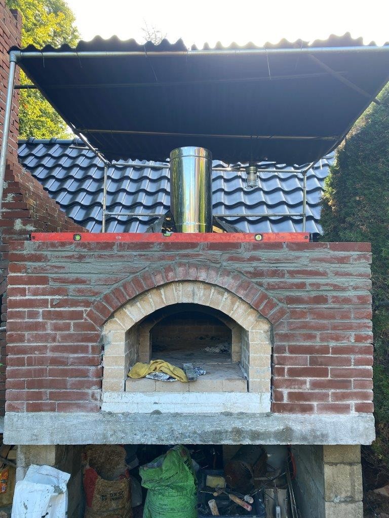

                      So, finally, the brickwork is done...
Name:	2022-10-08 12.22.15.jpg
                      Elements that I still need to make:
                      1. Next step is the roof, which will be a temporary one, as I will make a long roof over the pizza oven and some planned parts of the outdoor kitchen next to it.
                      I will make a wooden frame, on top of which I will put metal roof shingles.
                      2. Oven door - was looking at the door thread, excellent examples there. If the weight is not an issue, I would love to weld a door and put the remainders of the CalSil board in it. I would not like this to be too heavy for my wife to open it and use it. Additionally, when not in use, would like to make some hangers for the oven door, just below (close to that cement bag in the picture).
                      3. Tiles on the exposed firebricks, CalSil board and the below concrete slab, now looking for something colorful

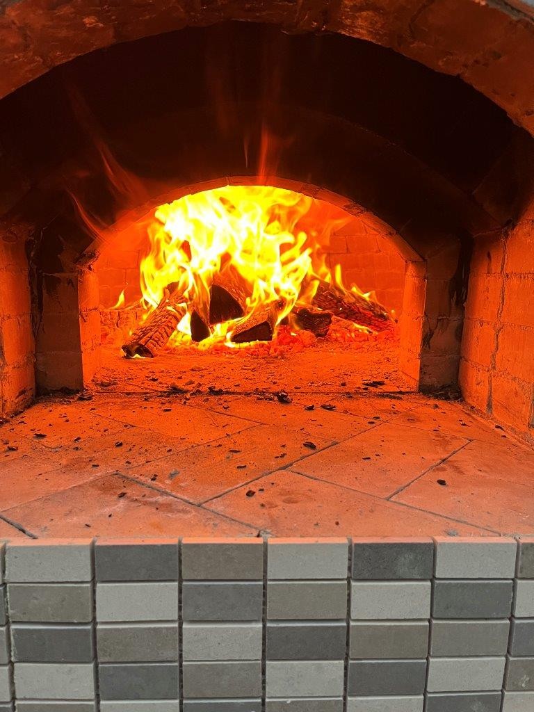

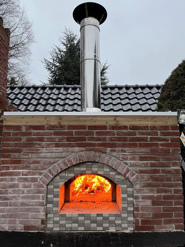

                          So, after a couple of months, it looks almost ready.
Name:	2023-02-12 17.44.59.jpg
                          I finalized the enclosure, built some roof, which was lined on top with some sort of EPDM cover, installed total of 1.5meters of chimney, and put some outdoor weather resistant tiles around the entrance of the oven
                          We are using it almost every weekend. This weekend was the first time we used it, that it was not dark.....
