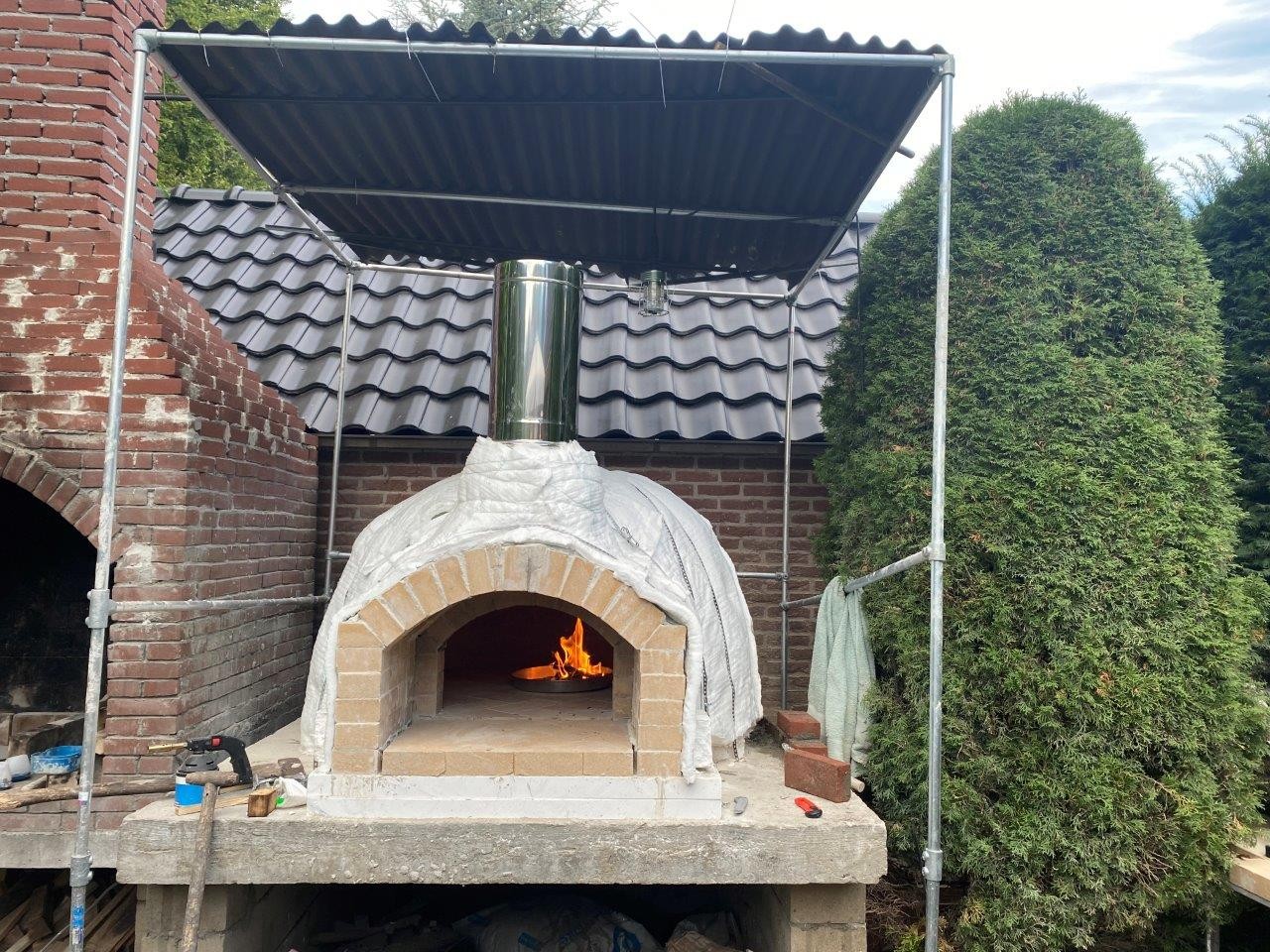

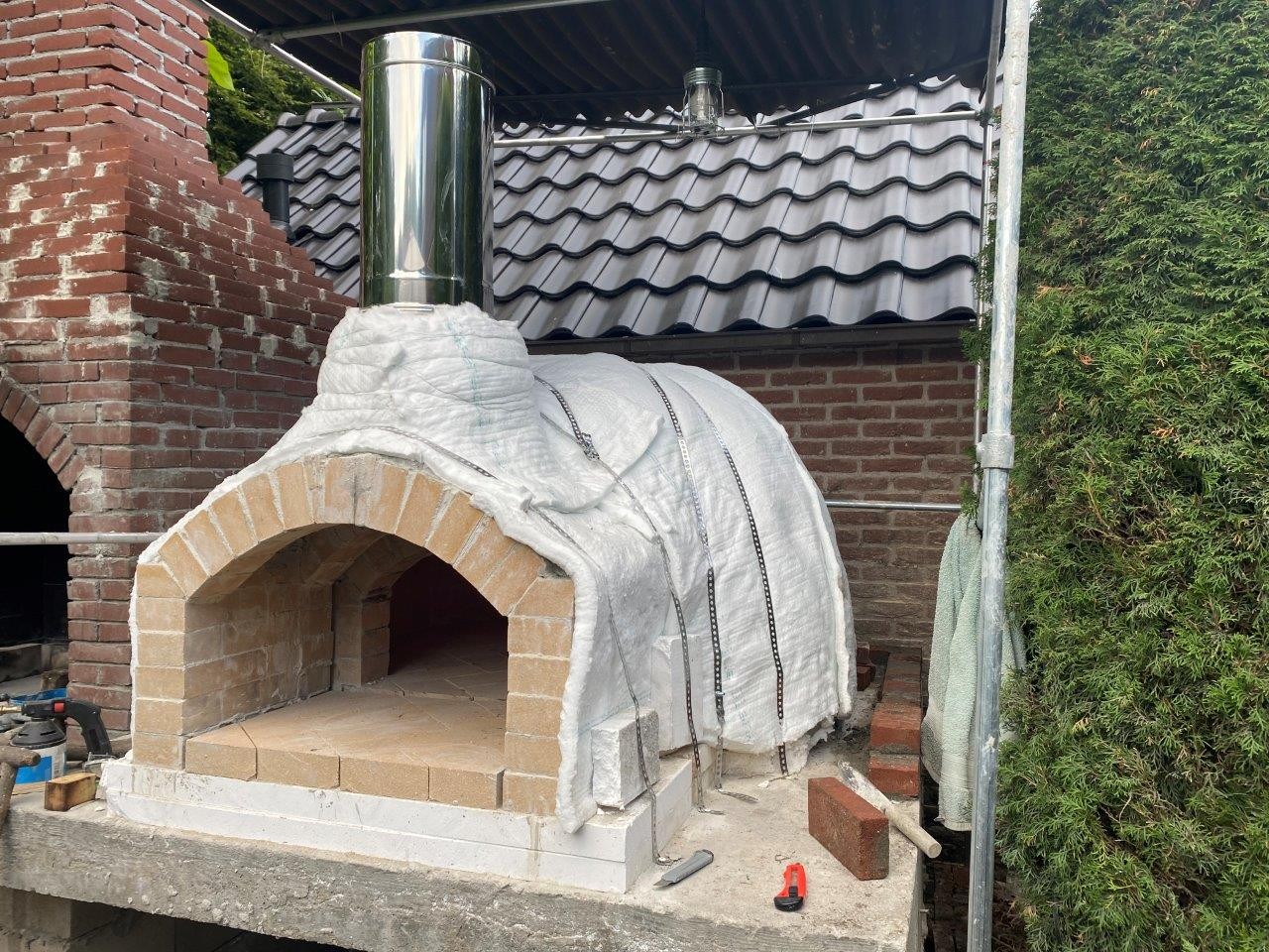

            The extra roll of the isolation blanket has been delivered, so I am putting the 4th layer, will put 2nd layer around the entry gallery and the flue. Will not put anything around the chimney, as that one is 2-walled, with some sort of isolation in between the walls of the chimney.
            I know that the downside to these extra layers of blankets is that my outer oven diameter is larger, so I will probably spend a lot of vermeculite to render the outside.

                    Started with the enclosure build last night. After adding the extra CFB layer, actually, not much more room left for the loose vermeculite on the sides, which is good, I thought I would need it much more. The wire mesh that is put to hold the CFB in place is not good enough, it is not holding quite ok.
                    The other issue I have is that the wire mesh is anchored by screws screwed in the CalSil board. I see that any long term tension will produce tear in the cal sil board. So, I will drill holes in the concrete top, just around the CalSil board. I will screw down the perforated flexible metal band strap to hold the CFB in place. That should outlast screws into the CalSil board.

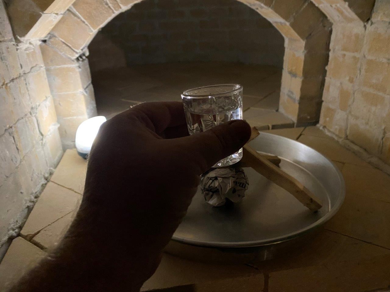

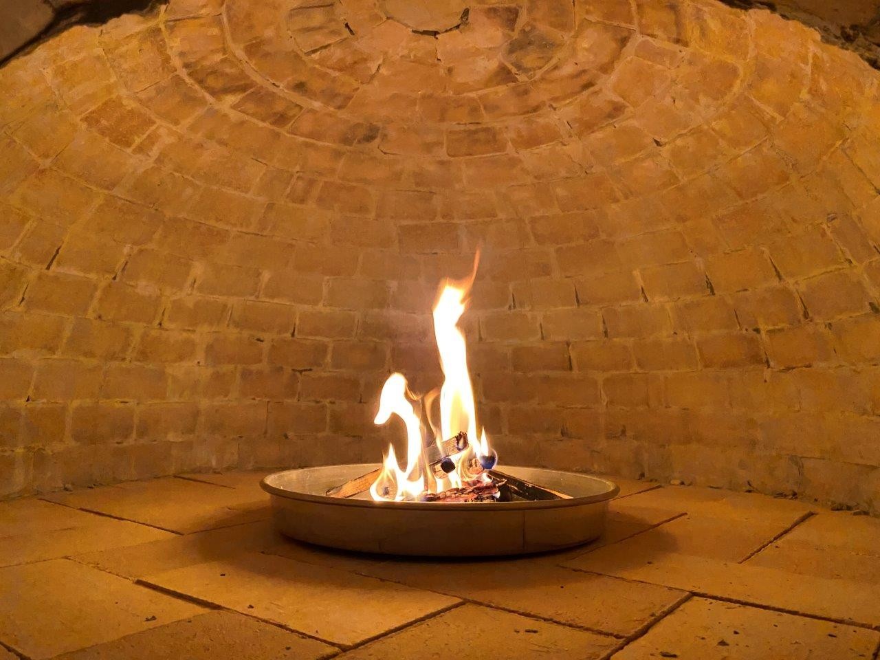

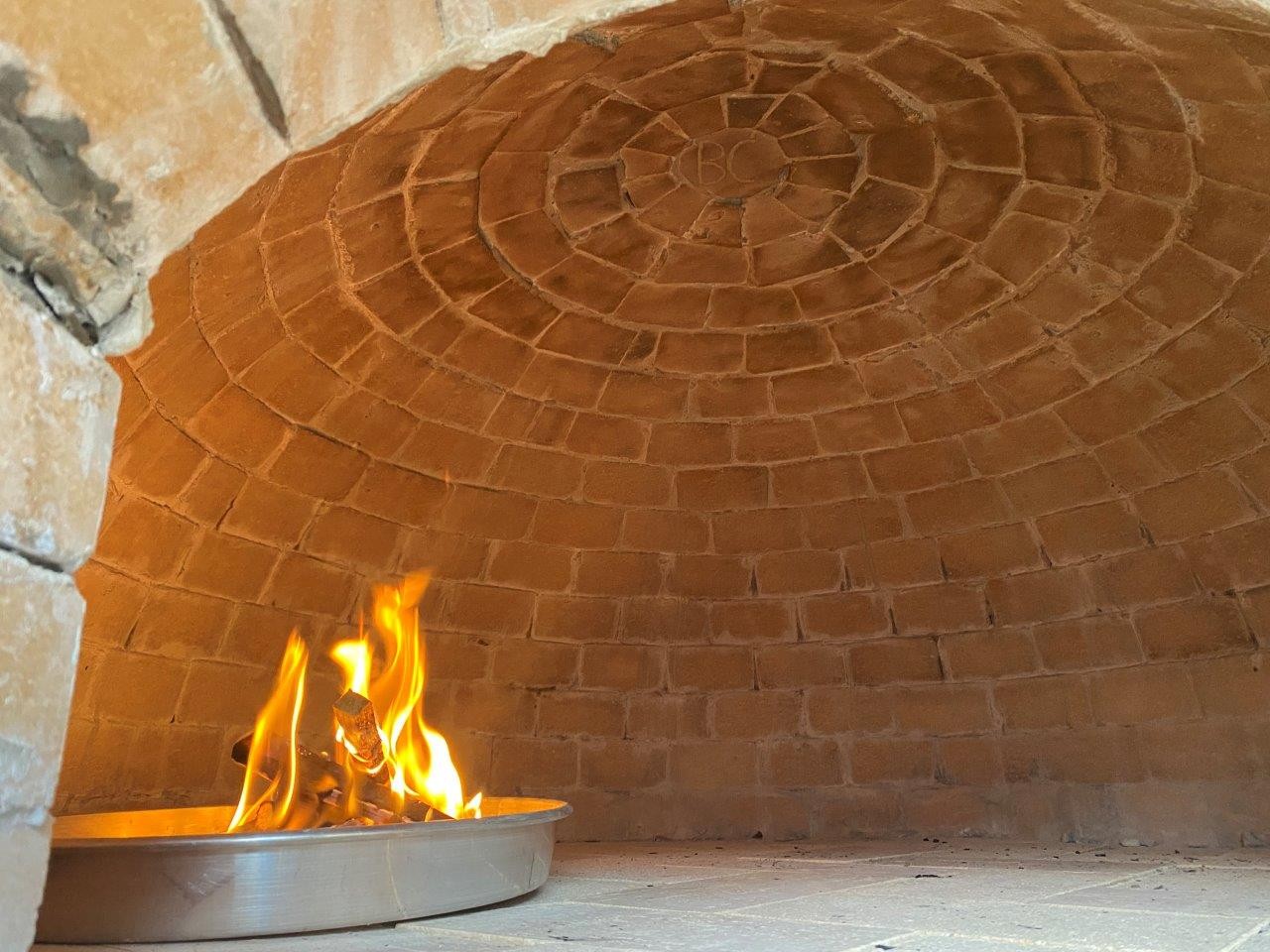

                      Hoorah!, we started the fires!
Name:	2022-09-04 00.19.45.jpg
                      Trying to follow the advice of David, in terms of the curing schedule.

                      Right now building an enclosure from red bricks, while also doing the curing. Should be all done in a couple of days

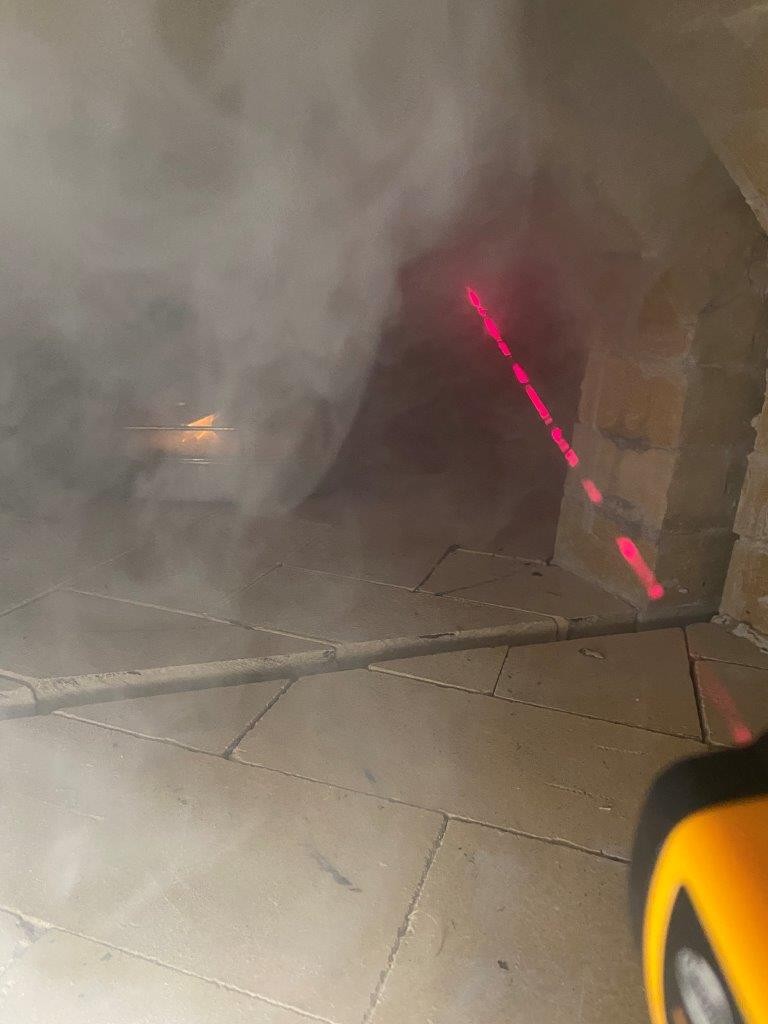

                        Looks great! How hot did you get with three sticks? What is the nice brick structure to the left?

                            Sorry, i meant 3 pieces of wood. When they are small like a thin branch we call them sticks. I was wondering how hot your first fire got since i see what looks like an infrared thermometer

                              Of course, yes. Well the first day fire was just the 3 small sticks, and I could not find my IR thermometer.
                              By the second day, I added some charcoal brikets, that is the photo with a lot of smoke. By that time, the themperature on the surrounding walls (on some places), was 37-40 degrees celsius.
                              By day 4 I am putting some larger quantities of brikets, and the temp reaches approx 50 degrees. Will keep it this way for some days more, I am still not doing anything with open flame in the oven
