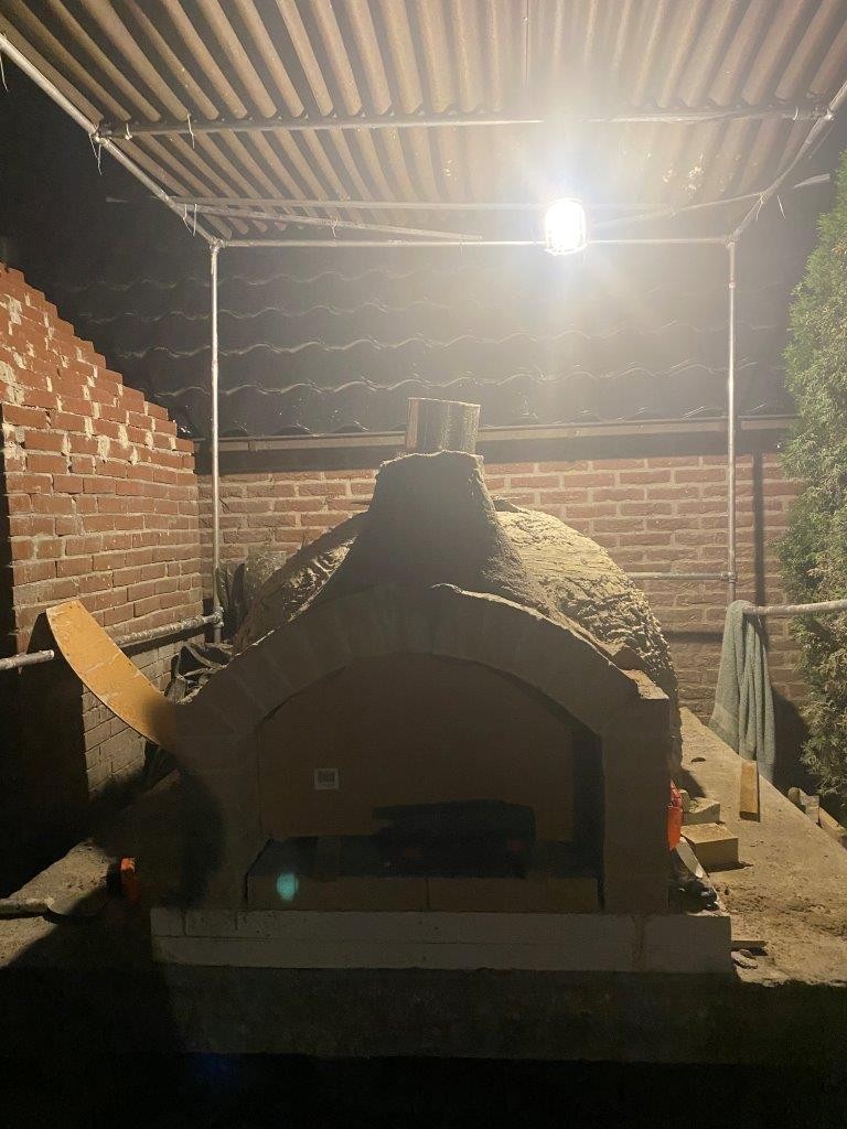

                      So, I noticed some cracks on the front arch. Let's just clean them a bit, so I can push some new mortar there.....
Name:	2022-08-18 19.20.24.jpg
                      Oh, there is another one somewhat towards the base..
Name:	2022-08-18 19.20.32.jpg
                      And before you know it:
Name:	2022-08-18 19.21.53.jpg
Name:	2022-08-18 19.21.59.jpg
                      One big chunk came off.
                      Nothing to it, I cleaned the mortar of the bricks, mixed some mortar and put it back together.
                      The issue is, I made the arch, and left for holidays. Maybe someone should have come and put some water over the arch.It did not fall apart when I removed the arch support. I just it is a bit loose, and could take it out with my hand. Even if I had not fixed it the fact that above it I would put mortar to cast the flue, it should have kept it in place. But, no sense in not repairing it now.
                      Anyhow, now it is fixed, tomorrow I am casting the flue. I could only find the bazalt AR fibres, not the normal AR fiberglass fibres. And got the normal PP fibres, so it will be an interesting experience.
                      Hope to finish it tomorrow!!!
                      Marko

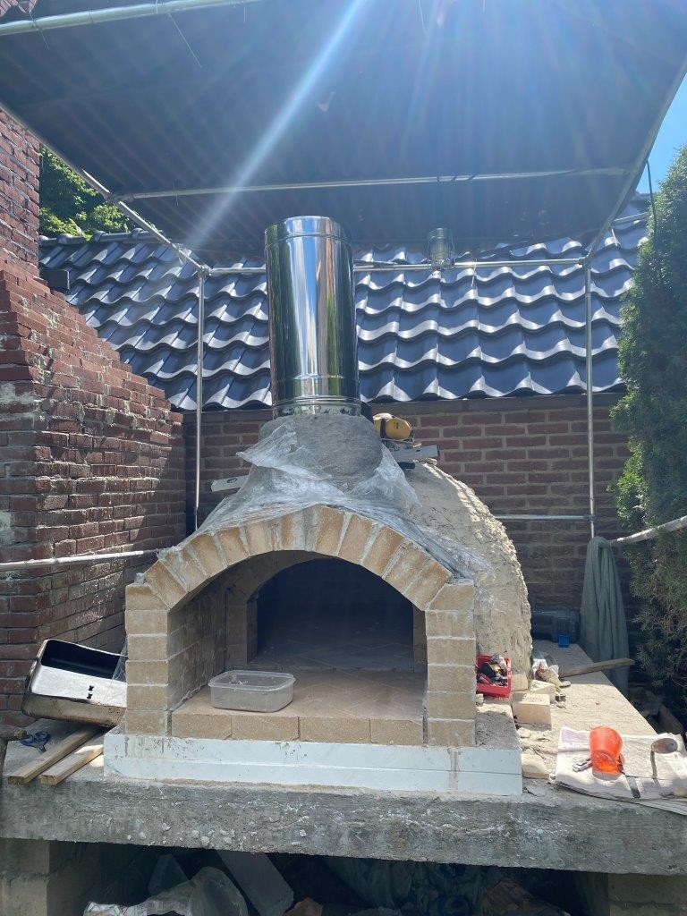

                      • #56
                        Was a bit busy with the removal of the arch form, cleaning the oven entry, and putting the arch for the flue mold. I than started building this form, out of sand. Never ever I did anything like this, so it took me a while to get the right consistency of the sand, so it can stay OK. I added a bit water (don't know if that is the route). Ended looking OK
Name:	2022-08-25 21.39.07.jpg
Name:	2022-08-25 22.11.58.jpg
                        Afterwards, covered it with wet newspaper. I see why this needs to be done. Otherwise, the concrete will embed a lot of the sand in the actual casted cement.
Name:	2022-08-26 07.22.49.jpg
                        At the end I put a chimney in the concrete, and than built the enclosure around it. This is to be able to have the cimney "sit" in a concrete opening with the right size. After some 1hour, I wrapped the entire thing in cling film, that is a good idea.
                        I got some bazalt fibers. The characteristics state that they are good up until 1,200 degrees celsius. The ration was approx 3% of the mass. I tried to determine this as much as closely possible, so for this amount I had to use approx 800 grams of the fibres. In addition, I put some PP fibres for steam spalling. Tried to use the guidance of quantity on that one as well. Not a lot was needed. The amount of concrete was approx 2/3 full wheelbarrow. I think it was enough. If not, I will add another layer, we will see how that goes.
                        So, following the excellent guidance of David s, I tried to do this. If it does not go through, I can always remove it, and build one from bricks, hopefully does not go there.
                        All of the isolation has arrived, I might finish this soon as well. Hopefully putting the blankets and vermicrete on sunday!!!
                        Marko
                        • #57
                          Great job. I think you'll be happy with the solution. That form would have been nigh on impossible to build with brick units and taken 10x as long.
                          • #58
                            Absolutely right. Just yesterday, I removed the sand and newspaper from the inside of the oven. Looks pretty smooth. I had the misfortune of putting the chimney bit wrong way around. So had to remove it, it was stuck super tight. After removing it, rotating it, I could attach the rest of the chimney.
Name:	2022-08-28 12.47.02.jpg
                            It is a bit crooked on this picture, but that is because it is not fixed. I put it just to see that the fittings match.
