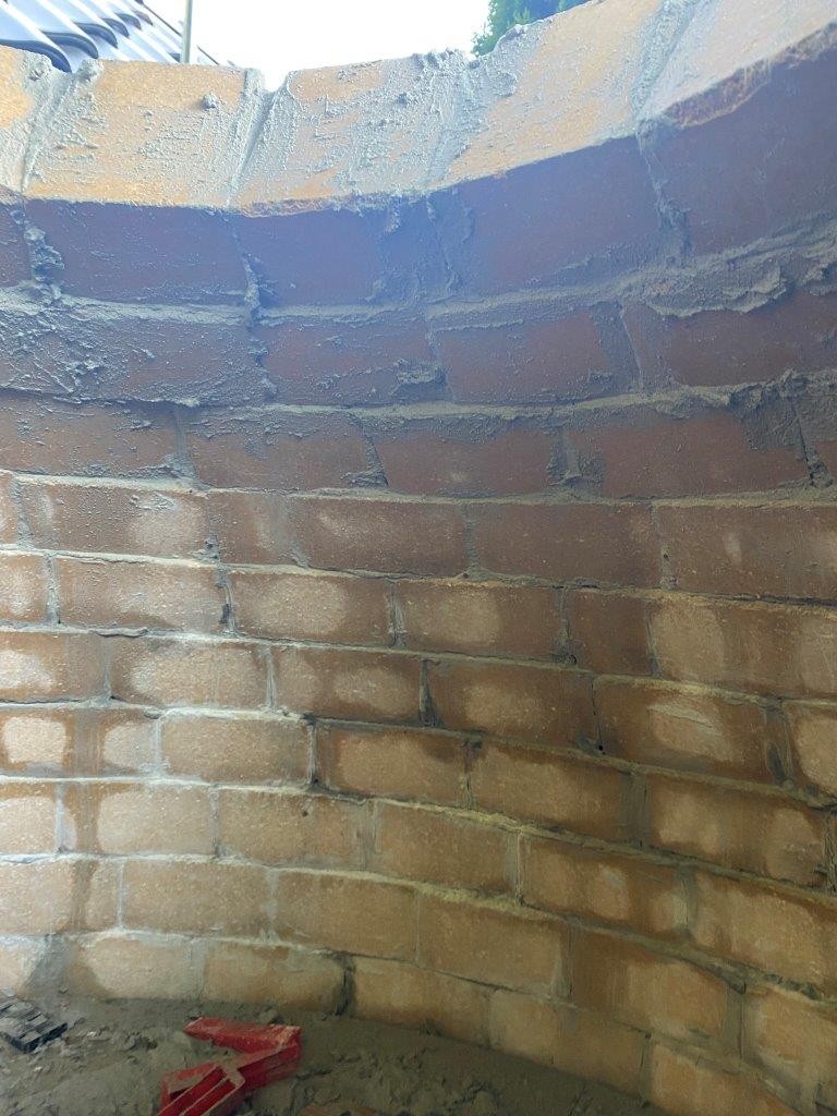

        The build is going great!. Yesterday was one of the most productive days.
        I used a wire wheel mounted on a drill to clean the inside walls, and managed to lay approx 2.5 rows (3 rows over the entrance arch, as there was a gap), plus 2 on the entire one
        Also started to taper the bricks, avoiding as much as possible the "wee" joints

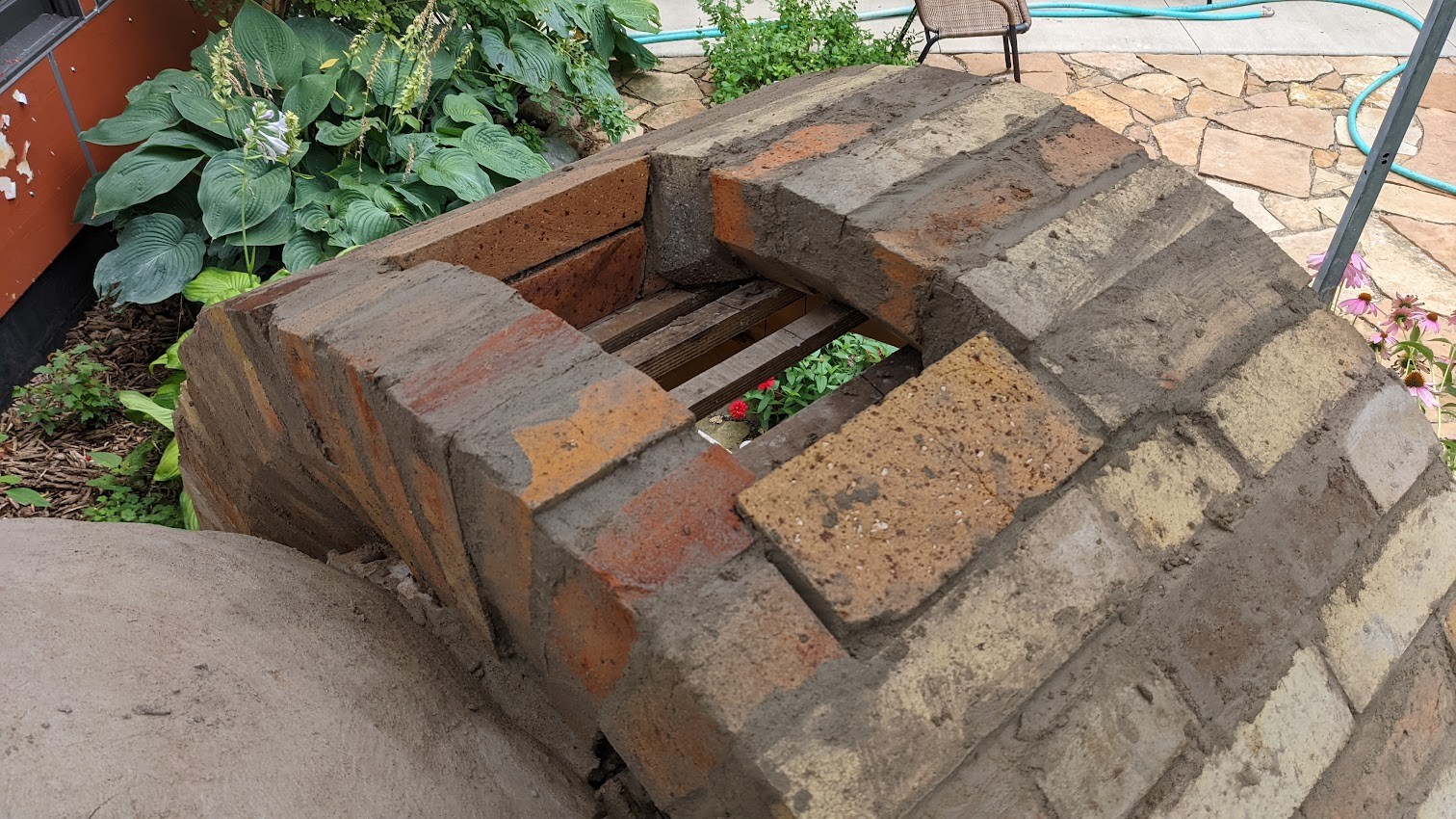

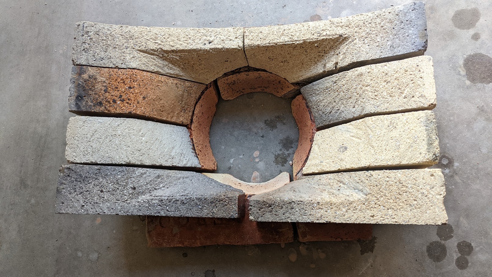

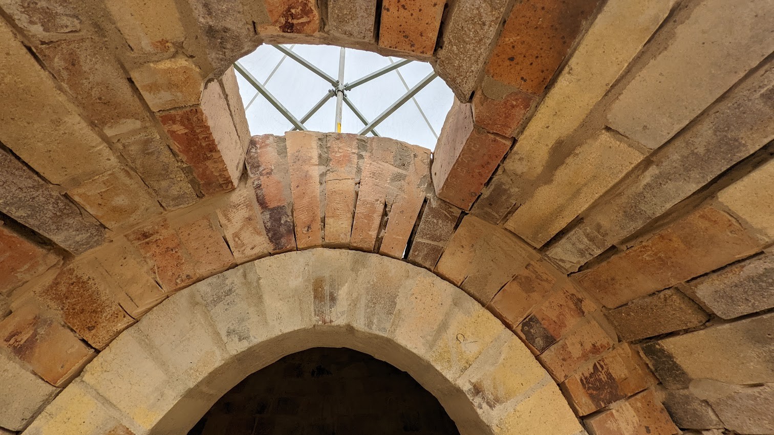

          • #35
            So, finally some progress, Actually, I need to catch up with posting

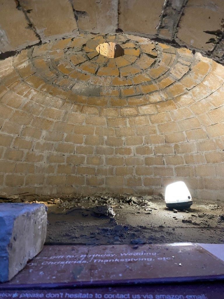

            • #36
              And, then, there was the dome completed!!!
              Click image for larger version  Name:	2022-07-26 22.19.37.jpg Views:	0 Size:	149.8 KB ID:	448804
              Click image for larger version  Name:	2022-07-26 22.19.47.jpg Views:	0 Size:	310.8 KB ID:	448805
              Click image for larger version  Name:	2022-07-26 22.19.57.jpg Views:	0 Size:	405.3 KB ID:	448806
              It was a tough one to complete, but all good!

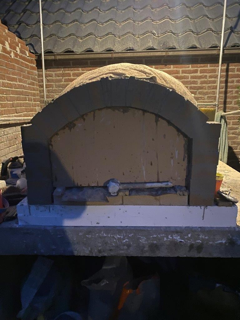

                • #38
                  I finished, the entry, and made it with the bricks going over the ege of the entry arch
Name:	2022-07-30 17.31.08.jpg

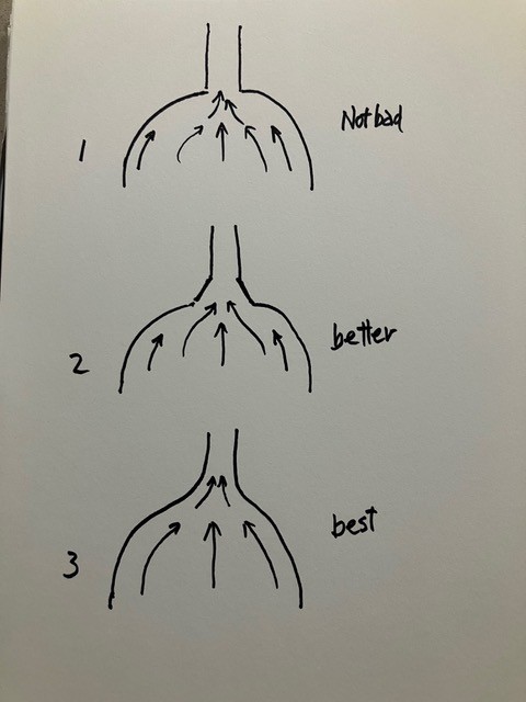

                      so, as I understand, the idea is that the chimney opening in the entry arch is 2X of the surface area of the chimney. In my case the opening for the chimney is some 3X of the surface area of the chimney pipe. Should I decrease it, by adding some bricks to the middle opening?
                      Hope to start with the chimney work tonight!!
                      • #41
                        What you have is fine. A smooth flow of smoke from the gallery to the flue pipe helps enormously. This is already partly achieved by the arch of your gallery, but a reduction of area between the gallery and the flue pipe to create a smoother flow is better. This is not as easy to achieve using brick units as it is by casting. Also bear in mind that placing too much more weight on top of the gallery increases the sideways thrust on its arch. Let the pics tell the story.

                          Thanks. Cannot delve now into casting, so will have to resort to using firebricks, although, casting would be my preferred route. I thought, as the funnel does not need any thermal mass, I can save on the width, and lay the bricks as shiner, instead of stretcher. I think I would make max two/three rows of shiners above the top of the arch of the gallery, in order to make the base for the anchor plate.
                          Is there any reason I should not do shiners. I see a lot of flue constructions with normal stretchers.
                          As regards the outward pressure on the arch, I might double the walls, as sort of buttressing
                              Beautiful work! I don't think you need to reduce the size, it won't probably improve the draft. For me it the solution was a compromise between minimizing weight on top of my arch, have a big enough opening, and being able to span the opening with shaped bricks to make the flow as smooth as possible. My arch is quite different than most (taller, wider, deeper) but here is how I shaped the bricks spanning the 12' x 8" opening in the arch....I am trying to do something like David's Option 3. Took me two days to cut/grind 12 bricks, I'm just showing the inner 8 ....the outer 4 just have a simple arch cut out. Each brick bears 3" on the arch, plus I'm hoping that by mortaring these 8 into 4 pairs, the installation will be easier, since the outer half of 4 of the bricks are not totally cantilevered into the opening..
                              Photos added for reference, (Center photo is quite distorted due to the wide angle shot) and yes I need to fill some major gaps

                                That looks like an excellent solution, although I’m not surprised it took you two days. Just to make you feel worse, it takes me 45 minutes to mix and lay up a flue gallery casting and because it’s one piece and fibre reinforced, is probably stronger than one made of individual bricks.
