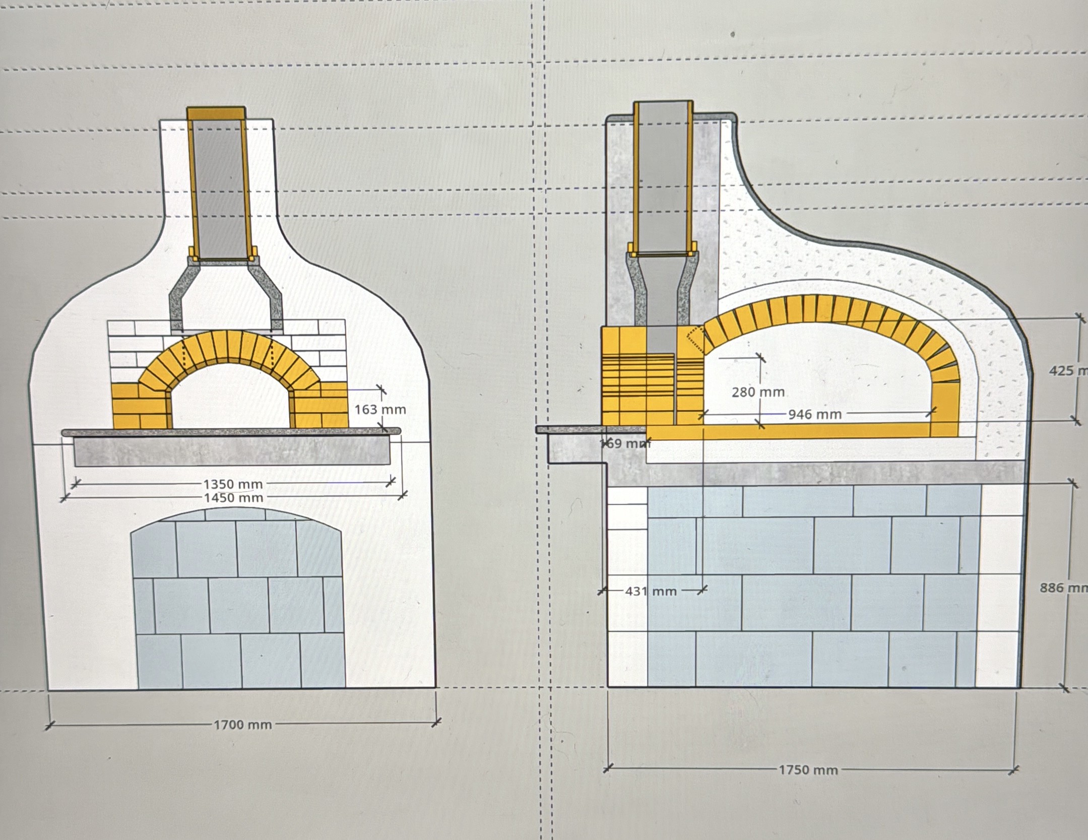

    • Originally posted by david s View Post
      To relieve pressure build up the position of the vent can be placed anywher. However, this pressure build up can also be utilized to help assist the removal of moisture.
      I'm convinced that efficient venting of dome insulation moisture (and under floor insulation moisture for that matter) is more efficient with the vents placed at the bottom of the oven for the following reasons.
      1. Heat rises by convection, so the fire in the chamber heats the crown of the inner dome faster than any other part of the inner chamber.
      2. Moisture travels away from any heat source.
      3. Gravity makes water fall.
      Pressure build up from steam or just expanding hot air forces moisture present to the outside of the insulation, away from the heat source, as well as down. Some of that moisture will condense against the inside of the cooler outer shell where it will run down or make its way to the base,
      Having observed this process firing a new empty kiln, as recommended by the ,amufacturere, I was surprised to see water dripping from the front corner when the kiln's internal temperature reached around 400C ( 750F), which is way above the temperature water turns to steam.
      I think the drawing explains the process. While a vent at the apex may seem the most logical, it is the build up of moisture lower down that is more problematic in creating a huge temperature differential and thereby thermal expansion issues. This problem is also evidenced by owners discovering the effidiency of venting the underfloor insulation.

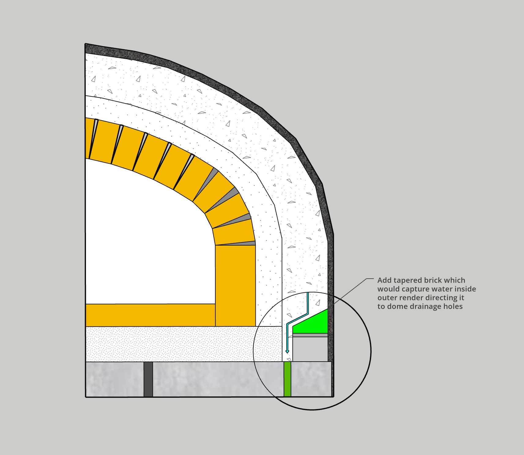

      That’s interesting and useful info David. I do have mosaic tile sheets turned upside down under the 10cm thick calcium silicate insulation which is under the oven dome and floor. That extends 10cm further than the diameter of the dome, with a min gap of then 30mm followed by a row of bricks. Any water that flows per your sketch should then flow back out under the floor insulation and through the hearth drainage holes.
      Addition: After contemplating your drawing, and theory about the steam condensation and flow of water inside outer render, I decided to add an additional course of bricks around the outside of the calcium silicate insulation. The additional course will have tapered tops so and condensation will flow down the bricks to to the floor, where I could add dome insulation weep holes per your sketch, or allow the water to flow under the insulation before draining through the existing floor insulation weep holes.
      A sketchup illustration integrating your knowledge.

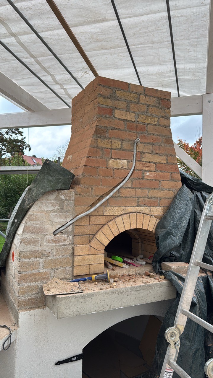

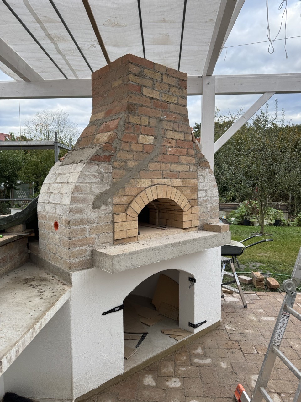

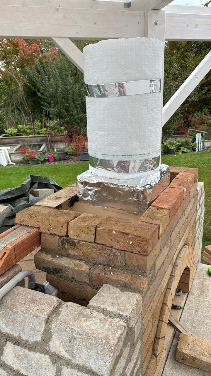

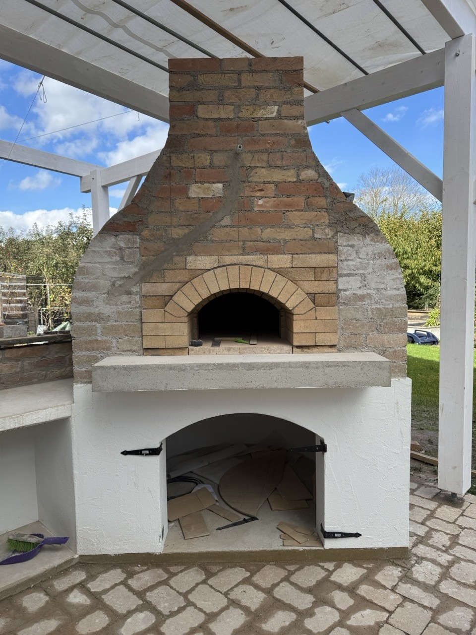

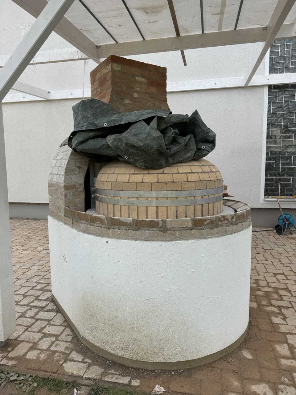

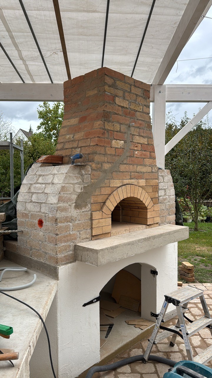

          I finished bricking up my chimney today. Yesterday I insulated the vent and flue with ceramic fibre blanket. The entire top of the arch in side the chimney is covered with ceramic fibre blanket, up to the top of the vent. Then 35mm of ceramic fibre blanket wrapped around the flu. Between the flue and the chimney wall from the vent up it is empty space, Which I guess is also good, but filling it with perlite or vermiculite would stop the walls of the chimney heating up. Your spreadsheet sounds intersting. I think i’ll understand it more when I finished this process of building my first oven.
          • Chimney insulated and brickwork almost finished.
            So racing against time to do what I while the weather allows.
            This last week the project at hand is working on the chimney. Monday I insulated the vent and flue as it wouldn‘t be possible when I brick it up. Got a deal on some ceramic fibre blanket which I got specifically to fill the chimney around the vent and the flue. Yesterday I finished the last course at the top of the chimney.
            I used hand made recycled bricks for the main chimney. Lots of cuts to form the curves I wanted, and a little complicated given the variance in sizes. The wet cutting saw was really handy to straighten some bricks when needed. Still was really difficult to keep my walls straight with some bricks bulging, twisting or curving, thicker one end than the other, or one side than the other. This morning I hit the brickwork with a concrete grinder disk to take out the bulges, and whilst super dusty, it came up really nice.
            I‘m adding a light to the front of the oven, so I cut a slit in the brickwork, installing cable conduit and a switch box in the brickwork. Backfilled with cement to fix the conduit inside the wall. Then clean up with the messy work done. So much dust.
            Lastly today, started bricking up the sides to finish the general curves in the side walls that I want. Ran out of cement with 2.2 bricks to fix in place to finish, so that will be first up tomorrow. Then I‘ll fill the empty space in the chimney with perlite, and move on to the back of the oven. One row of tapered bricks to add around the oven, along with some dome seep holes before starting on insulating the dome.

                Wonderful brickwork again man. Really jealous of the curves and angles, great job!
                The electricity conduit is kind of an eyesore, but I assume you will plaster/stucco across everything anyway? Too bad that you're hiding that beautiful masonry then, but it will match the bottom of course.

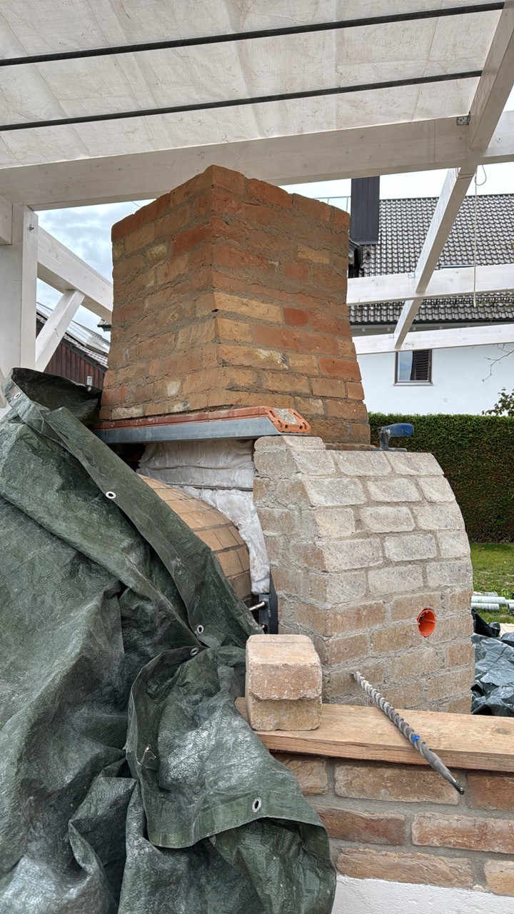

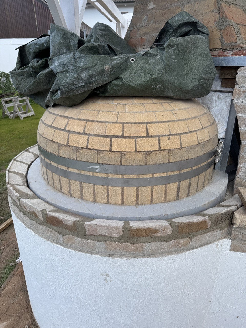

                    • Cut and set my last bricks, onto the dome insulation.
                      This morning I picked up more cement and set the last 2.2 bricks on side of the chimney.
                      Then I drilled 4 dome weep holes on the sides and back of the dome. 2 out of 4 I hit rebar. Luckily I had a good drill and it went through the rebar, although one of them took ages. From the position where I drilled the hole, I remember putting a extra thick on there.
                      Once the holes were drilled, I custom cut 16 concrete wall stones to taper the tops so I could lay them around the back of the dome insulation. These are inspired by david s who explained per his experience how water condenses and flows down the inside of the dome.
                      I‘ll give it a day or so to set and take a well earned breather, before jumping into putting the ceramic fibre blanket over the dome, followed by 4 x 35mm layers of v-p-crete.

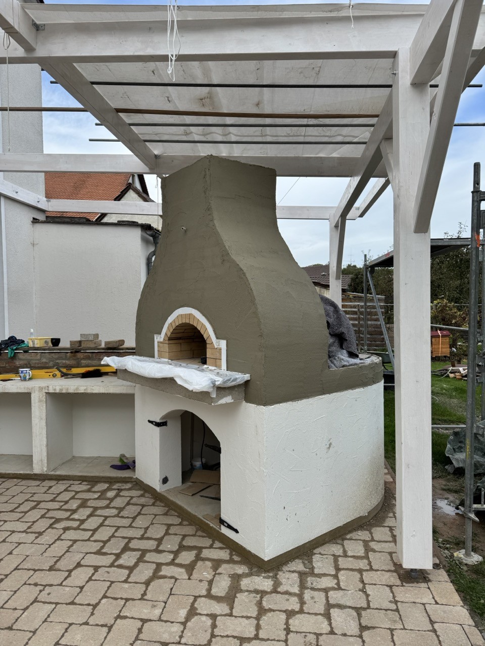

                          • Granite landing set, Chimney rendered
                            This morning I set the granite landing in place in front of the arch. Then completed the first coat of render on the chimney.
                            It‘s been a big week, and if I‘m honest, i‘ve surprised myself how much I was able to do. Good to have no concepts about limitations and to tackle tasks one at a time as they come. We had our first frost overnight, with a maximum of 14 today and for the next days, then next week it gets warm again, a 19-20C window which is perfect for adding the first layer of v-p-crete. That means tomorrow or Monday I‘ll add the ceramic fibre blanket over the dome. Possible on Monday i‘ll add the second layer of render over and around the chimney if the first layer is dry enough.
                            Whats nice now is that with the render added, its very clear that the visible space over the dome at the back of the chimney is where the insulation will be added.
                            As you can see my roof sheeting is still not delivered, but fingers crossed it‘ll be here in a couple of weeks and I‘ll be able to cover the terrace and pizza oven properly. Looking forward to that.

                            • Looks great, even though it seems like a shame to cover up all your lovely brick work!!
                              Also, it's amazing how the chimney ends up (temporarily) just dwarfing the actual oven dome. That's going to change with the insulation over the dome, but I am always surprised with how large the chimney structure ends up being, especially given that, strictly speaking, it is basically optional!
                              I also put my landing on today (slate), so blankets are next for me too.
                              • Originally posted by nlinva View Post
                                My plan per my design was to render. The chimney construction ended up consisting of Schamott bricks at the arch, left over concrete paving stones building up the sides, and 200 year old hand made recycled bricks above the arch. I do love exposed brickwork, but with the mix of bricks in didn’t think it was nice aesthetically. So was happy to render it and when painted it should look impressive.
                                The old bricks are 250x120x65mm on average. I cut the front bricks down down to 80mm thickness, and with a Schamott flue (ID Ø200mm, OD Ø240mm) the chimney ended up 600x700mm at the top. That’s with 35mm ceramic fibre blanket around the flue and approx 30mm space between the inner front and back wall so I could fill with perlite. Building with bricks, I think this is absolutely minimum and next time I would leave more clearance front and back of the flue. I’m keeping my fingers crossed that it will have sufficient insulation the keep the walls to an acceptable heat.
                                it’s also possible to put just a double walled insulated flue on the vent, and it would not be so imposing. In my case I wanted to to be imposing, a statement. Everyone who sees it is impressed. It is an authentic Neapolitan pizza oven, or meant to be.
                                I am my harshest critic, for good or bad. If I left the brickwork exposed as it was, I would have been unhappy every time I saw it.
