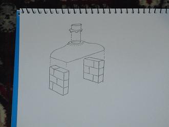

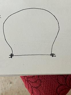

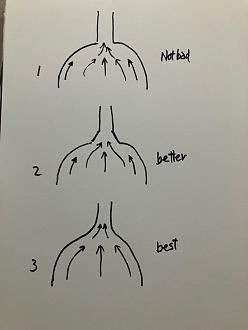

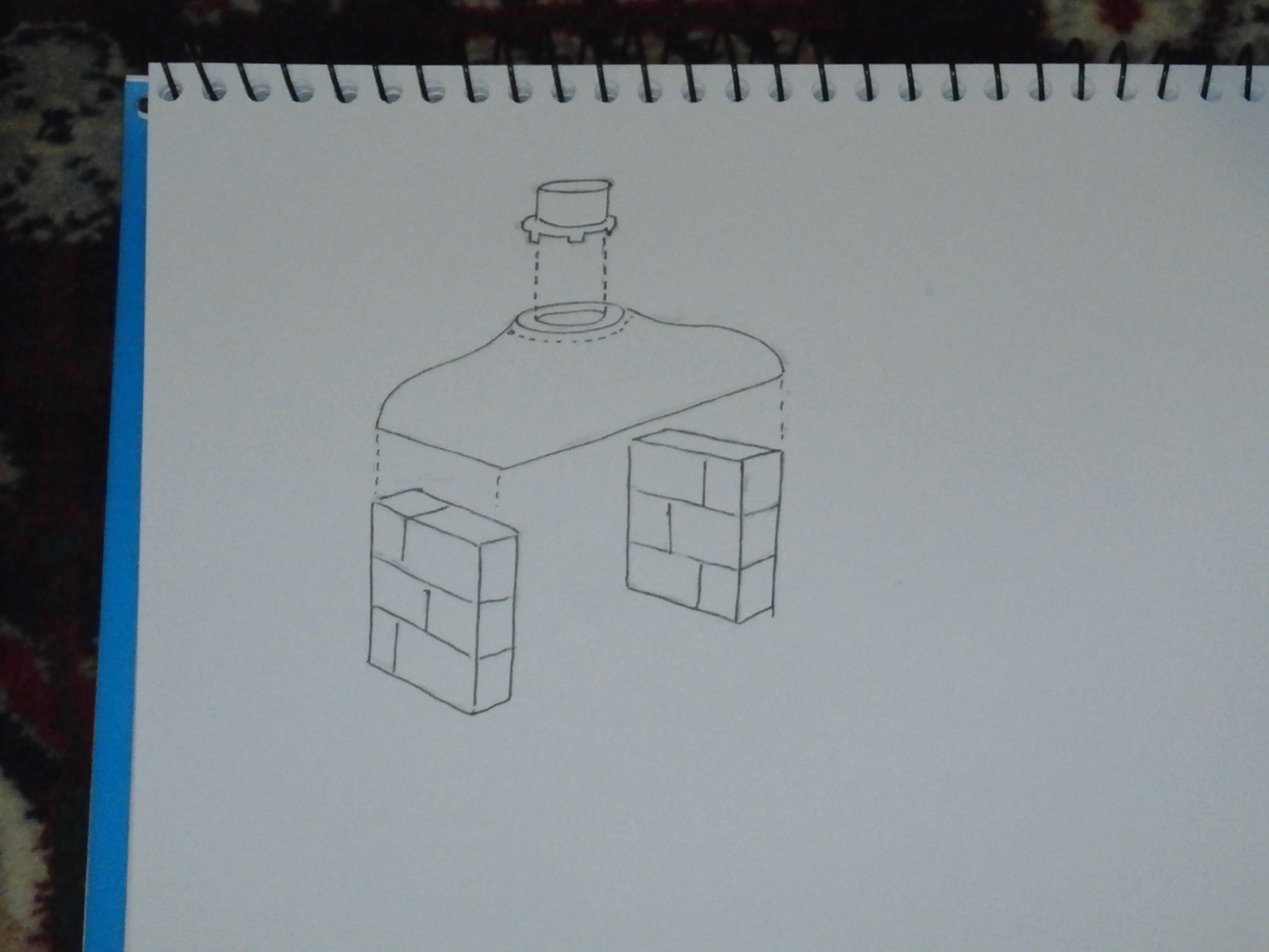

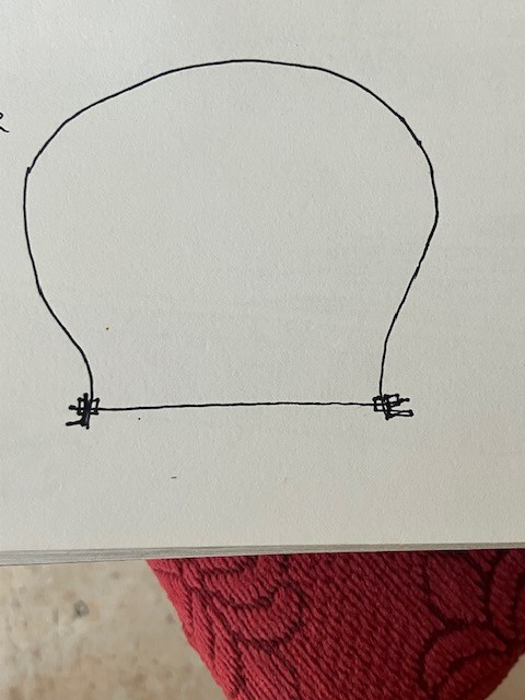

            I was looking through some old drawings and came across these ones that you might find helpful. Regarding the steel bracing of a low dome you may be interested in this method which does not require pinning the band to the supporting slab either side of the entry. Obviously you can't have the band across the front of the entry.
ID:	457184 Click image for larger version

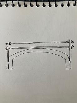

            • #36
              Click image for larger version  Name:	IMG_0894.jpg Views:	0 Size:	62.7 KB ID:	457184 Click image for larger version  Name:	IMG_0893.jpg Views:	0 Size:	57.8 KB ID:	457185
              There is so much I don’t know, but I’m never shy about asking questions when I don’t. I spent the whole day yesterday reading and researching. In searching the forum for more info about heat breaks, I came across Napolitian style 106cm build inside a hobbit house with images showing exactly as you illustrate. His brickwork is really a sight to see.
              I have options, that doesn’t look hard to do, the angle has threaded rod connecting the two oven the arch. He has two uprights to give support to any pull from the dome. Stainless band is available here and not expensive. What’s not clear yet is how he created tension in the strap. I was looking at metal pallet band last night, and how they fasten that. Yesterday I also looked at yachting stuff, for tensioning ropes to see if I could adapt that to this application. What he uses in his images I have seen before, but I’m not sure what it’s called, and I’m still googling to find out.
              I attached this image to show how i did a quick mock up with the angle at the side so the arch. On the left I did another mockup with a smaller opening for the flu, and a 10mm heat break between what would be the decorative arch in red and the outer arch. I have scraps of “Siebdruckplatte”, high quality ply with waterproof coating on it, which is great for making non stick formwork. Perfect for the oven vent.
              Last edited by daidensacha; 02-01-2024, 11:42 PM. Reason: Added a image with explanation
