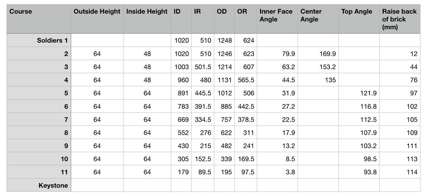

  • #16
    The chart I created with all needed measurements.

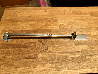

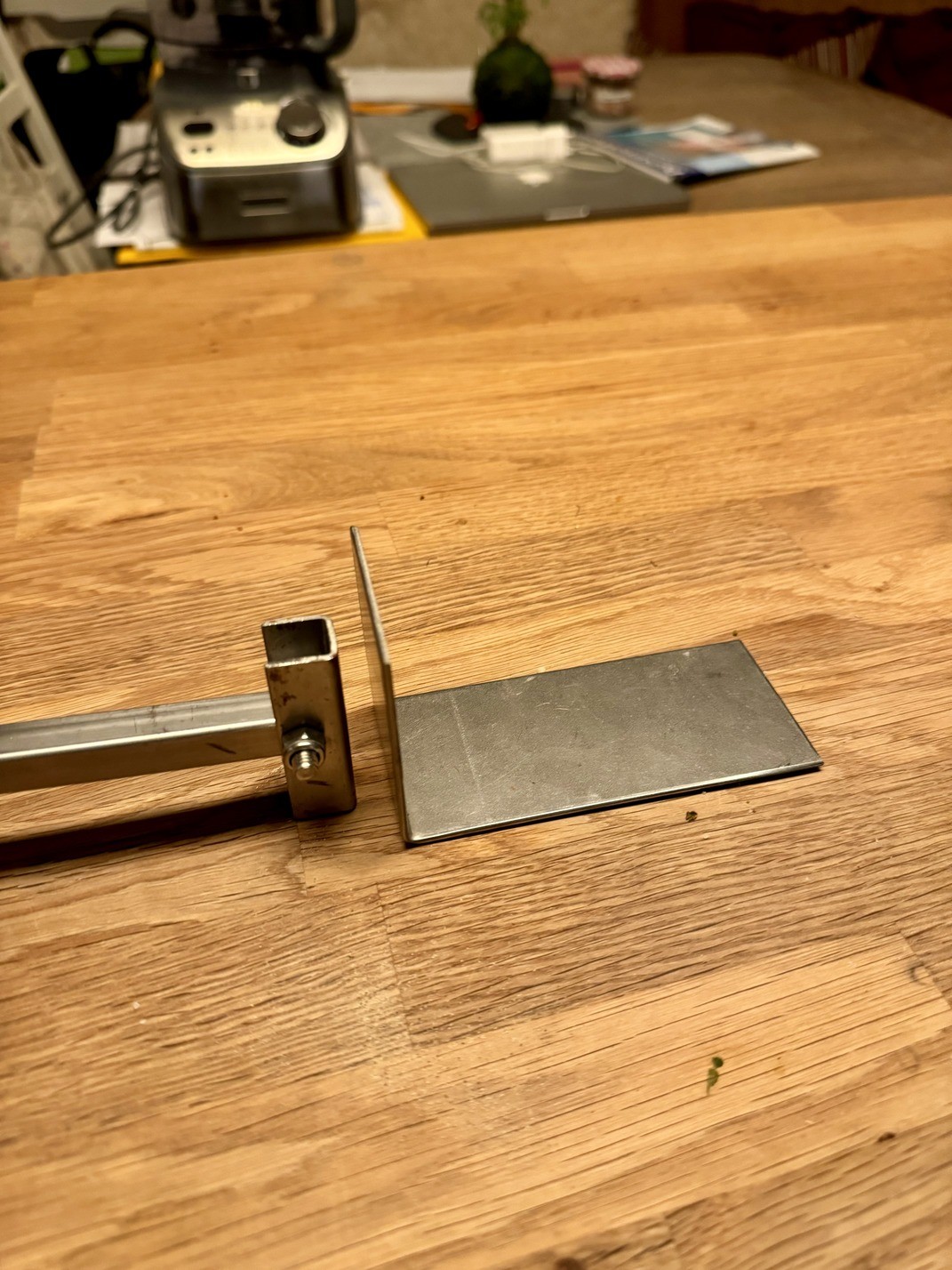

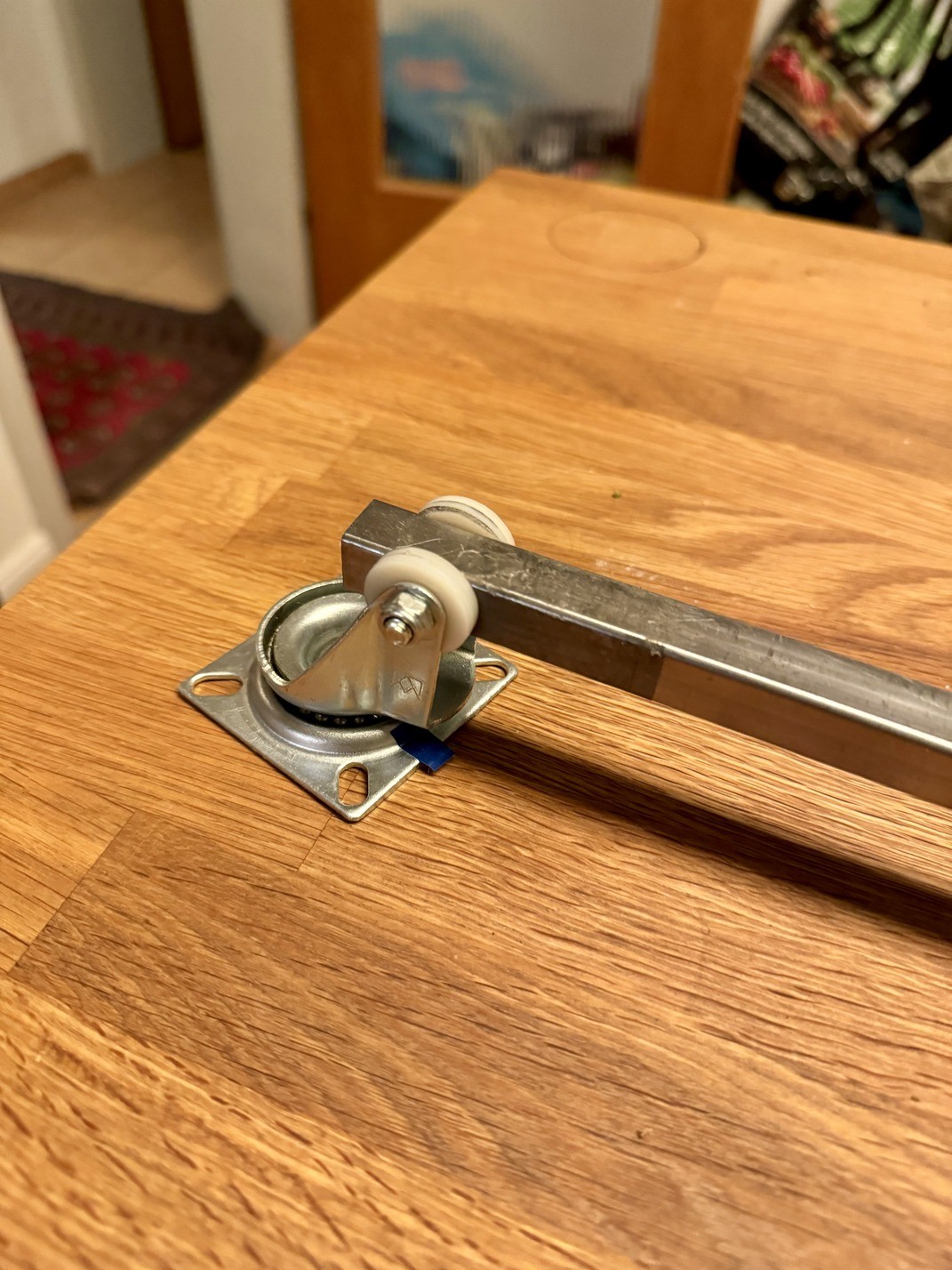

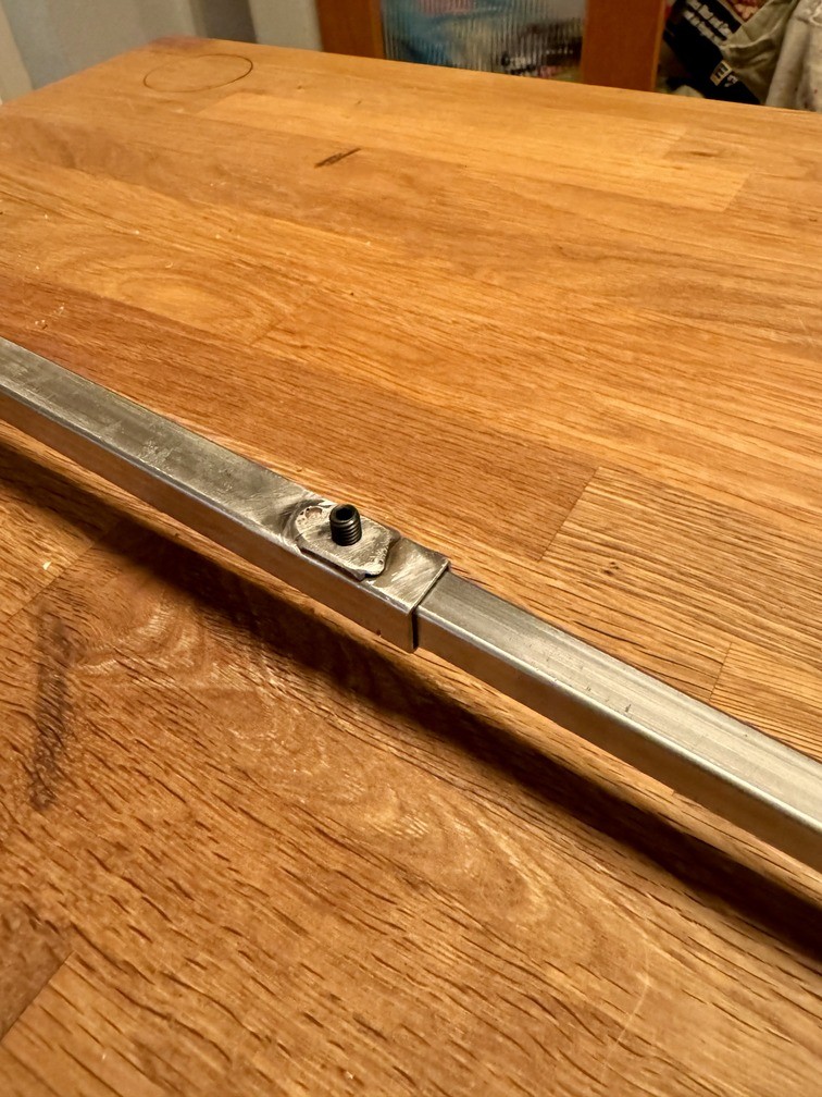

        • #19
          Indispensable tool.
          I started this last year, time to finish it in preparation for spring and starting the Neapolitan build.
          So I used a castor which was cheap and easy to adapt, with some mild steel rod. One rod inserts into the larger, with a nut spot welded to the tube so I can adjust the length of the arm. Crucial given the curve of the Neapolitan dome. I have to finish welding the bracket on the end, but made it so I can adjust the angel, also needed for this build as I want to set the angle for each course of the bricks so the dome goes to plan.
          Its light, sturdy, soon to be finished.

          • #20

            • #21
              Critical design component. From the pivot point along the center of the square tubing MUST intersect the center of the brick or the brick will not be perpendicular to the center of the floor and will see stepping of the lip of the brick courses as you move up. There error induced in cumulative so the higher you go the more error.
              Also, be aware, ideally the pivot point should be at floor level and at the center of the floor. By using a caster it dome height will change as you move up. Just something you need to be aware of and adjust the radius to suit your build.
              • #22
                UtahBeehiver Helpful, thanks. I will make a point of welding the bracket so the center of the square tubing lines up with the center of the bricks. When pivot the bracket to adjust for each course, I’ll also be checking the top angle and inner angle of the bricks when setting the bracket. I’ll have to watch that. I made a floor template out of 6mm ply and using this will make measurement markings on the square tube for the initial courses. I can also make measurement markings for each additional course as a check when I get to the higher courses.
                I did have a question, I have been reading through JRPizza build as you suggested. When you remove a brick to set the IT pivot at floor height in the center, how was it when setting that brick when removing the IT?
                I’m enjoying reading though JRPizza’s build. It’s making me aware of lots of stuff I will probably encounter and haven’t even thought about. It helps to be mindful and to check levels and to really pay attention to where the course bricks meet the dome arch. I have been playing in sketch-up with intersecting my drawings of the dome and the arch to see how they meet, and where the joins will be.

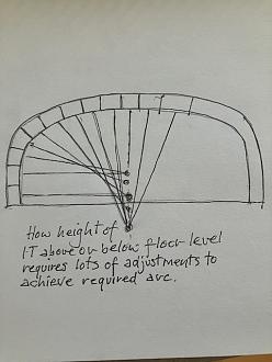

                • #23
                  You might be better off cutting a template of your required arc rather than using an IT.
                  Diagram explains why.
                  Click image for larger version  Name:	IMG_0890.jpg Views:	0 Size:	68.1 KB ID:	457146
