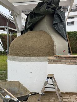

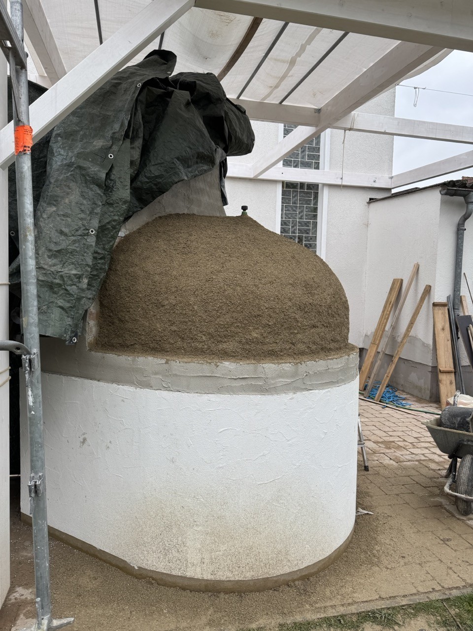

        • Oven Insulation Started
          I guess to much is better than not enough. When I ordered everything for my oven back before spring, I did some calculations and ordered 3 x 7.4m x 610mm x 25mm rolls of ceramic fibre blanket. Then I saw an offer a month ago and ordered 1 x 14m x 610mm x 13mm roll to use in the vent and chimney. I had about half the roll left when I finished insulating around the vent and flue in the chimney, and I filled the chimney from the arch up to over the vent.

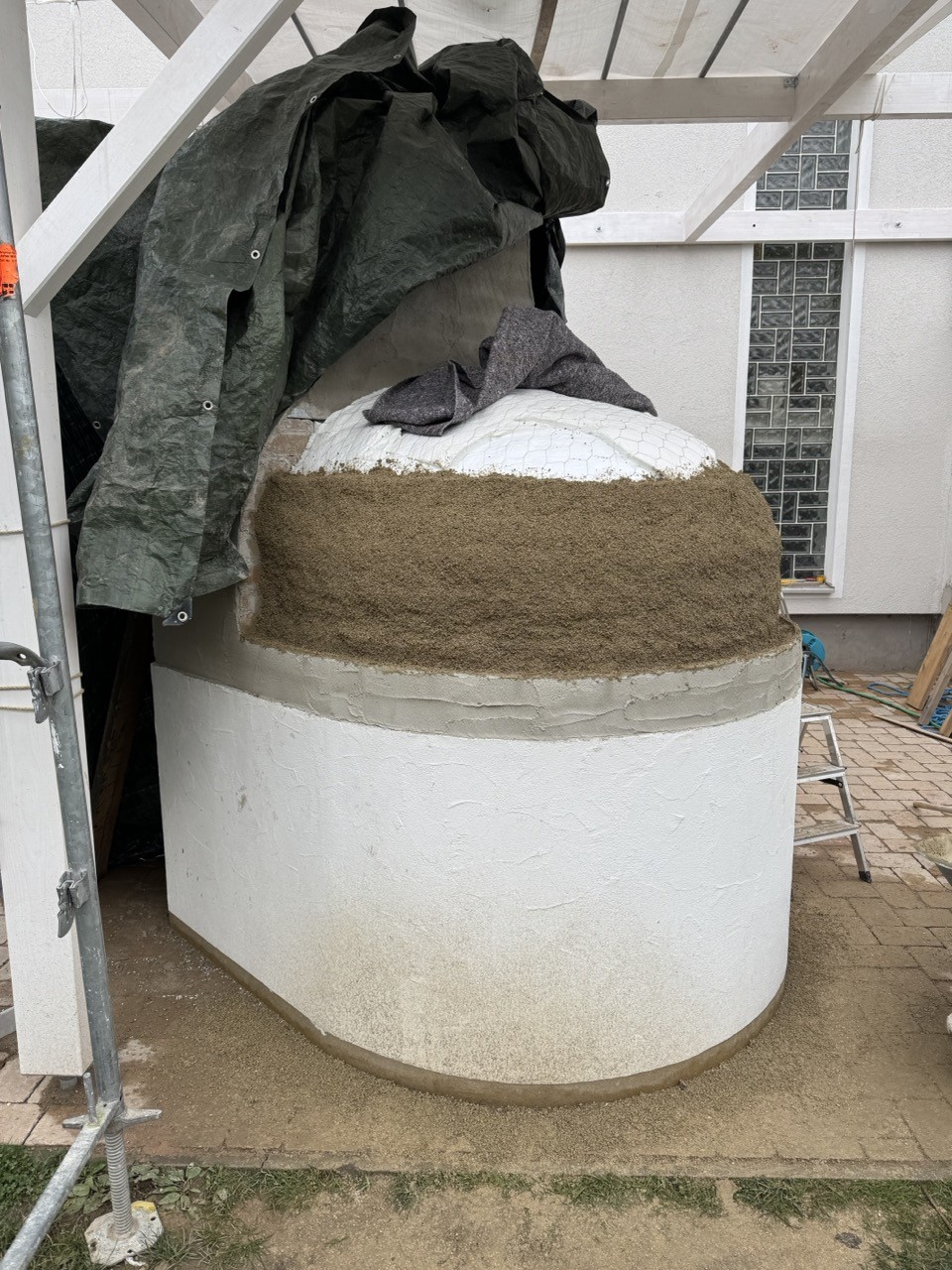

          So yesterday I got stuck into covering the dome with ceramic fibre blanket. After covering the dome with 4 layers, I had lots left over. So I added another 2 layers on top of the dome. It now has 100mm around the sides, and 150mm on the top, with about 200mm over dome where it meets the chimney. It wasn‘t planned to have so much, and maybe it’s overkill, but better than having it sitting in my garage and not using it. I covered it with a layer of chook wire, with screws into the calcium silicate under the dome to hold the wire.

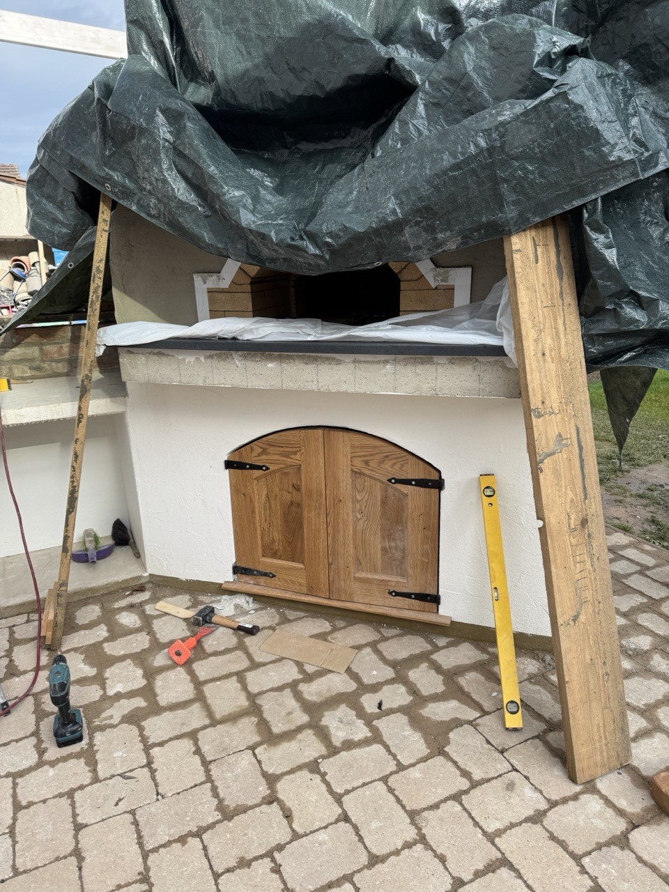

          In the afternoon I refitted one of the hinges for the doors, and they now fit flush with the door jam under also fitting. I need to patch some of the render around the hinges, and the door jam, but I‘ll do that when adding the final layer of render on the chimney.
          Today I started on the first layer of homebrew v-p-crete.
          Recipe: (parts
          1. 5 parts Vermiculite
          2. 5 parts Perlite
          3. 1 part cement
          4. 1 generous handful of clay powder per 1 liter of cement
          5. Water to mix by hand into the right consistency.
          I‘m no expert and my experience with this recipe is limited. The clay powder seems to make it easier to work with, besides making the mix a nice brown color. Theres a knack to adding it, and I got that pretty quick. Scoop up enough to fill both hands, then plonk it in place against the dome with one hand holding it against the dome, and the other patting it down flat on top. Adding horizontal layers one at a time until it curves over and on top of the dome. Then I poured a bucket load on top, spread it out, and patted it down to around 35mm thick. Possibly a little more in places. When finished, I scraped back the high points, and filled the low points to get s somewhat even shape over the dome. I put a vent in the top as well. A hydraulic vent (as described in the Forno Bravo forum) screwed into water pipe. It sits on the ceramic fibre blanket, and will give me peace of mind knowing if there is for whatever reason a buildup of pressure in between the dome and outer render then it has a release.
          Now the wait for it to dry so I can do the next layer.

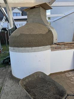

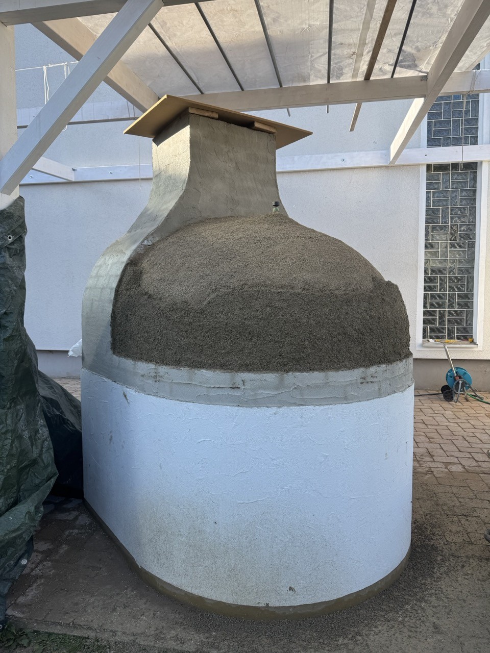

              • V-P-Crete one day on, drying nicely.
                I was shocked this morning when I went out and inspected the v-p-crete that I put on the dome yesterday. The outer layer dried overnight with no sign of water, although there is for sure water under the outer surface. To the touch it felt a little soft and crumbly, so I let it be. Tonight when I packed up and covered it again, it had set much harder. To the touch it feels solid, like one hard mass. I‘m really impressed.
                I already scraped it back to an acceptable shape yesterday, so letting it be now, but will follow david s tips when I do the final layer. I thought you (david) made a typo when you said “tapping the surface“, but I clicked a few moments ago and got what you mean. I tried troweling it yesterday but it wasn‘t stable enough with the blanket under it. I did put my hands on it with a little pressure to compact it as much as I could. With the final layer I‘ll use my trowel to lightly tap it to create a surface that I can add the mortar on.

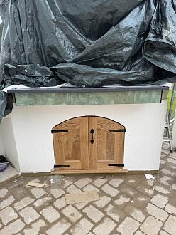

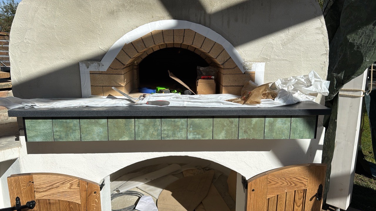

                Added tiles, door lock and handle.
                I did a little tiling under the landing this morning. Hand made Italian tiles. Will add the grout in a day or two.
                With my doors now in place, I fitted an inside lock on one door, and an old style door handle.

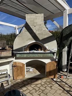

                • While waiting for v-p-crete to dry, refer to todo list and finish off odd jobs.
                  Today was 19C, sunny with blue sky and perfect weather to help the drying of the v-p-crete layer. If I wait a full week, then next Monday or Tuesday will be my next layer.
                  So I referred to my todo list, odd jobs and details to be finished.
                  1. I grouted the tiles, dark grey to match the granite and super happy with how it is looking.
                  2. Cleaned out around the render around the hinges in preparation for patching it up.

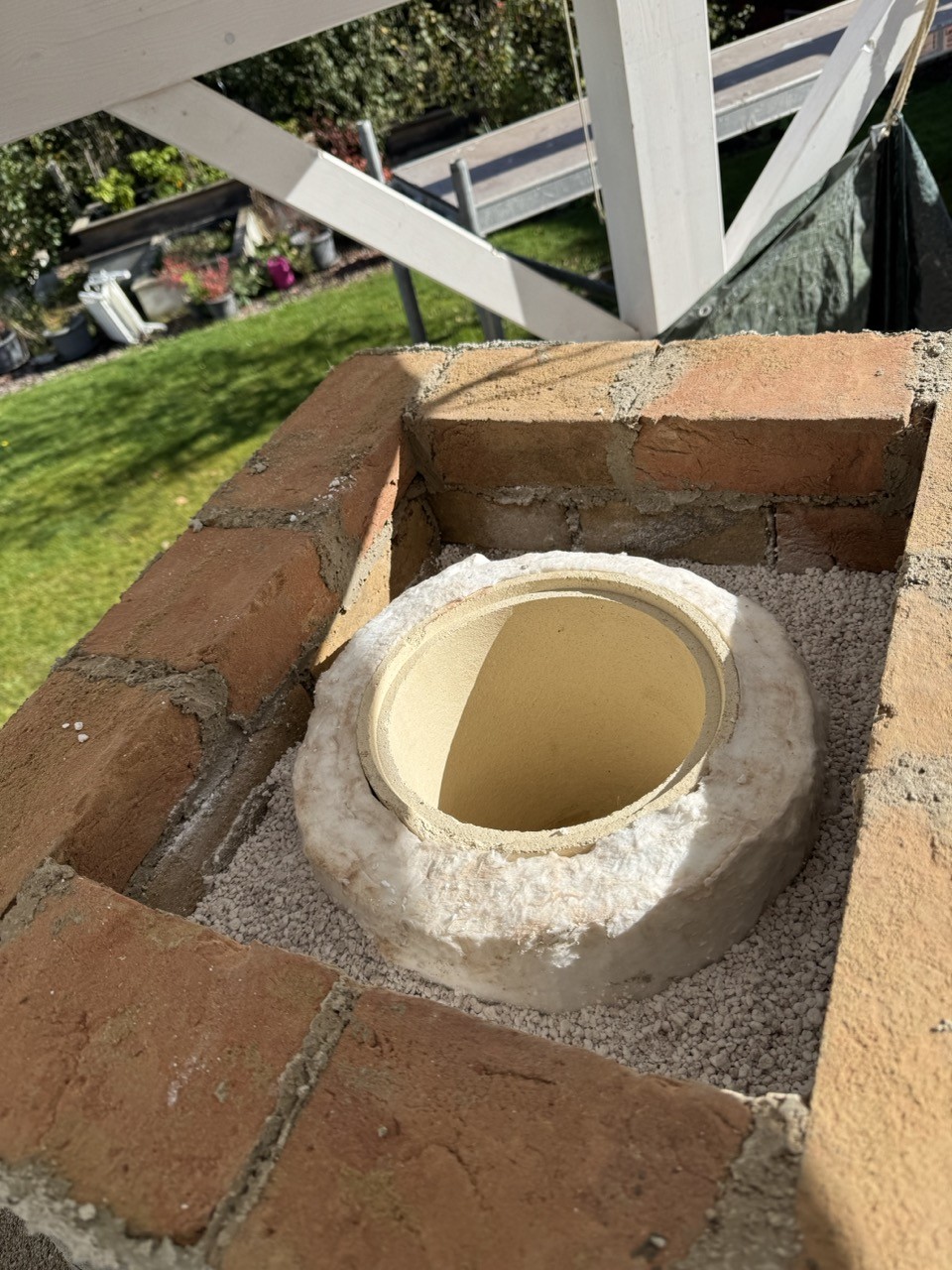

                  3. Filled the chimney space around the flue with perlite.
                  4. Swept off the loose v-p-crete pieces on the dome, leaving a nice hard shell that has set really well.
                  5. Prepared my gutter hooks for installation tomorrow, weather permitting. Could be a little rain in the afternoon.

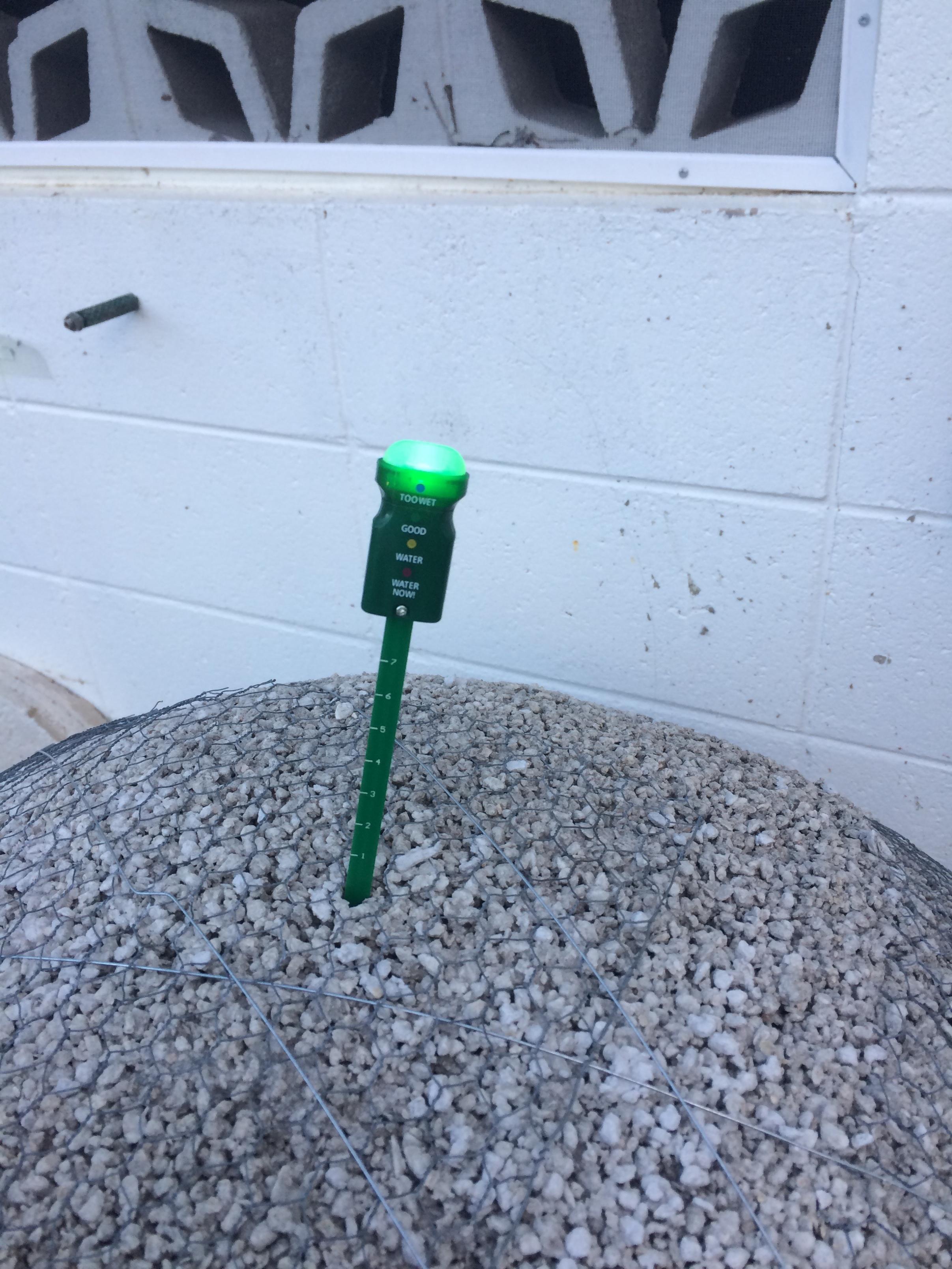

                    • This is a useful tool. A simple cheap garden moisture meter can indicate when the p/vcrete layer is dry.

                        I have one in my garage, somewhere. I’ll have a look for it, out of curiosity to check what reading it gives.
                        That said, yesterday was the first day I fully uncovered the oven for a few weeks. There was a lot of condensation inside the tarps. Although the chimney render is dry and hard, I can see brick shapes in it from moisture exiting, so I know the best thing to do is be patient and let it dry out.
                        When I knock on the v-p-Crete it’s sounds hollow like a hard shell. I know the ceramic fibre blanket would have also absorbed moisture.
                        I’ll wait till Tuesday (1week since adding) and check the moisture content then.

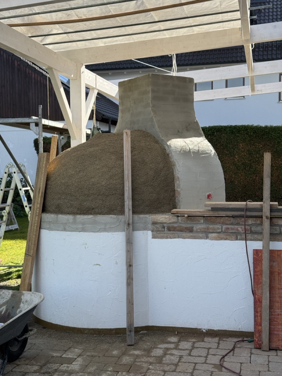

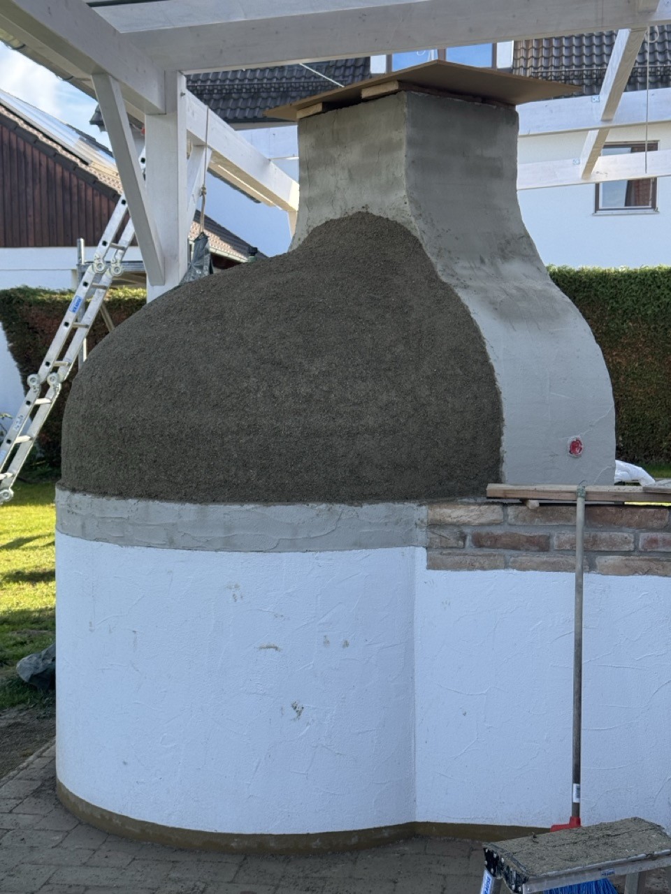

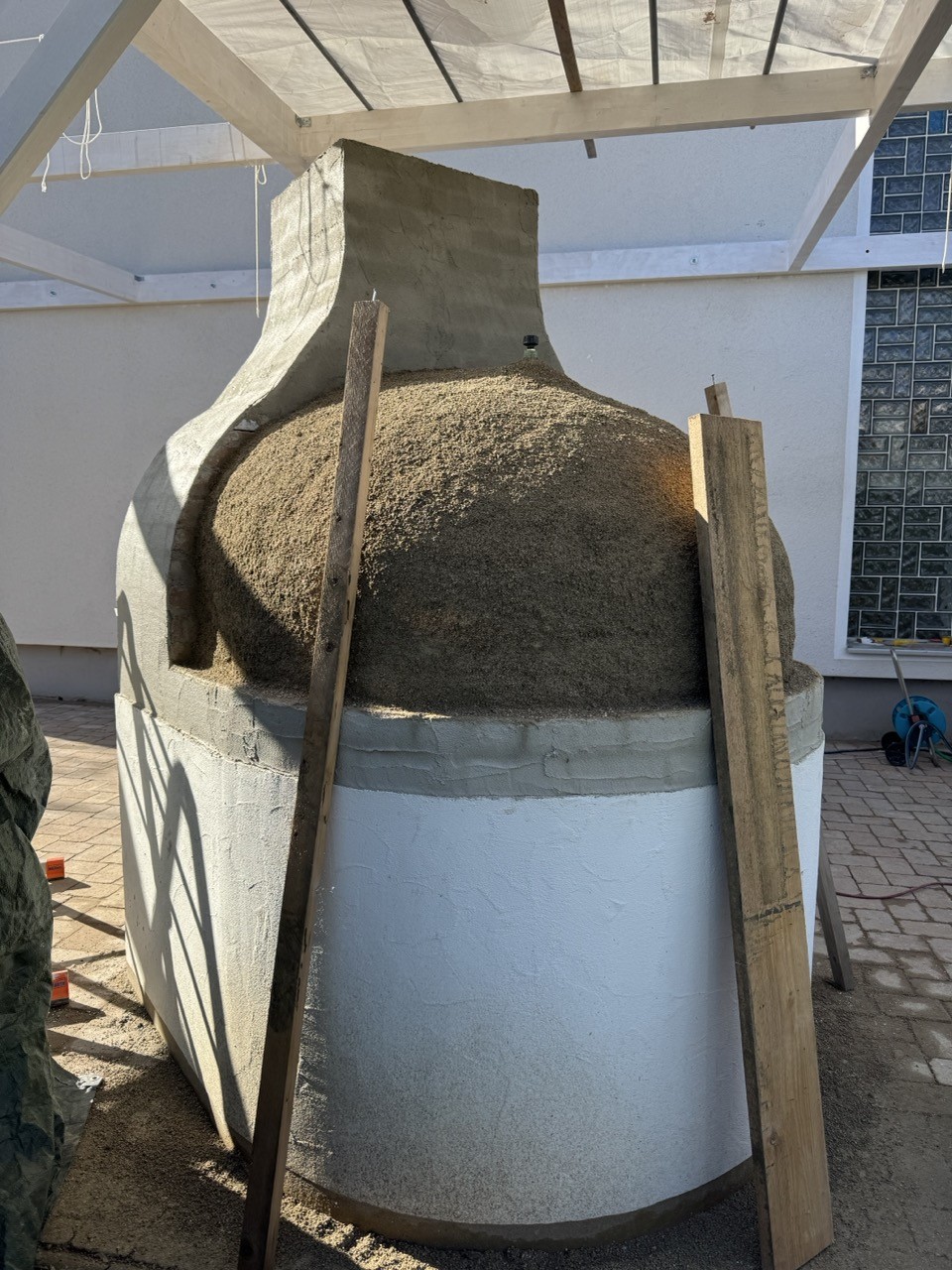

                        • Second and final layer of v-p-crete
                          The weather today was perfect, given it‘s coming into winter. 17C max, blue sky and sunshine the whole day. WIth some afternoon rain forecast for tomorrow, and a cold change in about a weeks time, I was out at 8.30am mixing v-p-crete to put the final layer. I did find my ph/moisture probe and tested the v-p-crete 3-4 days ago, and it was dry, or so the probe said. But I decided to wait a week before proceeding to be sure.
                          I‘m trying to find a balance with completing what I can while the weather is still allowing it, and pondering delaying work until next year if the weather doesn‘t allow me to finish.
                          With the final layer of v-p-crete insulation completed, I‘ll leave it for a week to dry before re-assessing my next steps.
                          I‘ve been researching double walled stainless steel flue, and what parts I need to extend the flue from the chimney through the new roof when its on. I‘ll order it tomorrow or rather next day. I need to consult with a chimney sweep, as its required by law in Germany that all flues that go through a roof are cleaned and maintained by a registered chimney sweep.
                          I want to start my drying fires soon, now the final layer of v-p-crete is on. The weather is getting colder next week, with max: 9-10C, min: 2-6C. I wont be able to rely on sunshine or warm days, although keeping fingers crossed some might still come.
                          I do have a question regarding the drying fires. Is it better to do them before adding the final render? With the weather, I need to know this to plan on whether to delay or wait for a day warm enough for it to set.

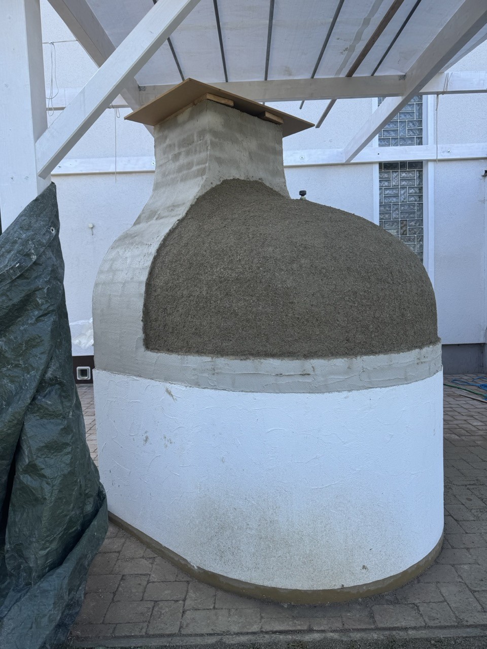

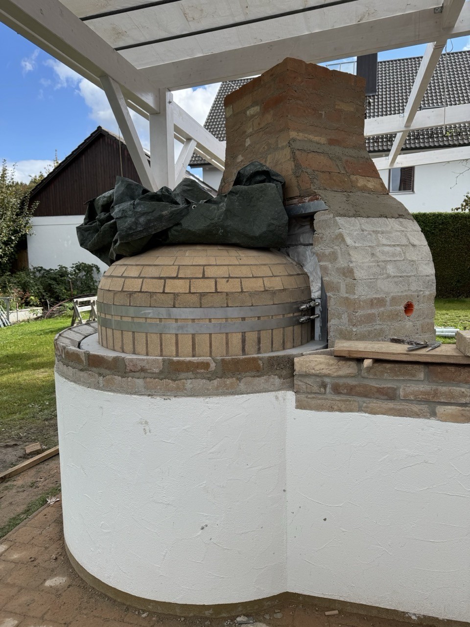

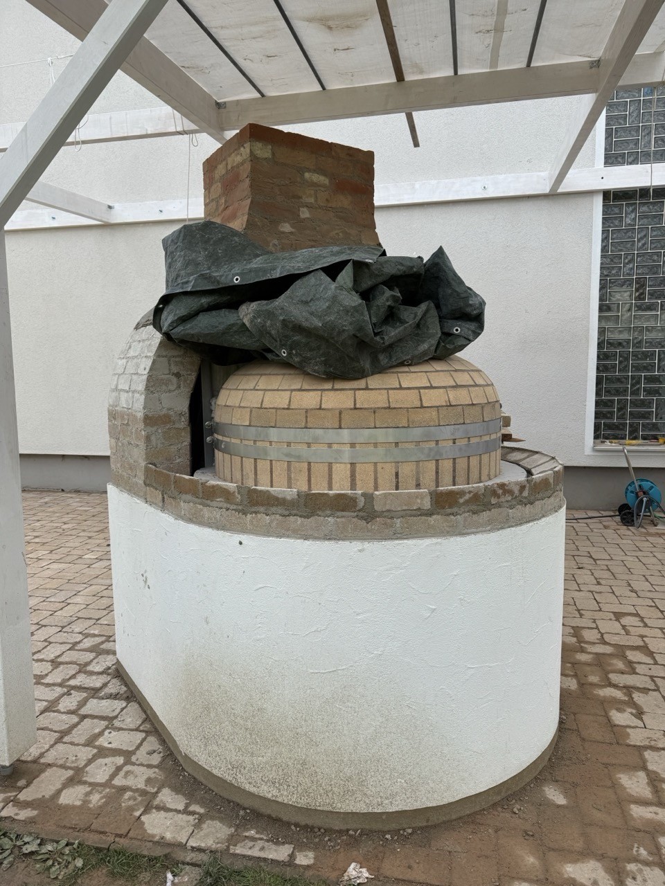

                          • Before and after insulation images.
                            I thought it’s interesting to see the before and after images to get a perspective of how much insulation is on the oven.

                            • Moisture driven out by fire and trapped in the insulation layers (blanket and p/vcrete) has a much better chance of finding its way into the atmosphere if it’s not held back by a hard rendered shell on the outside. Coupled with the assistance of sun and wind to dry the outer surface at the same time, so yes, the drying fires are best done before final render coats.
                              This then creates a problem of applying the outer render to a dry surface. My remedy for this is to cover the whole oven with clingwrap after completing the outer render so moisture is then retained in that layer for a week. Considerable strength improvement is achieved if it’s damp cured for a week.
                              • Originally posted by david s View Post
                                I‘m just so impressed by how hard and how quickly the v-p-crete sets. I cover it at night to prevent it getting added moisture from dew, and go out to uncover it first thing so it can dry out throughout the day. This morning I was pleasantly surprised to find the surface of the v-p-crete dry, and by days end it became really hard. When mixing it, it is hard to imaging how solid it becomes. Looking forward to the next stage of drying fires.
