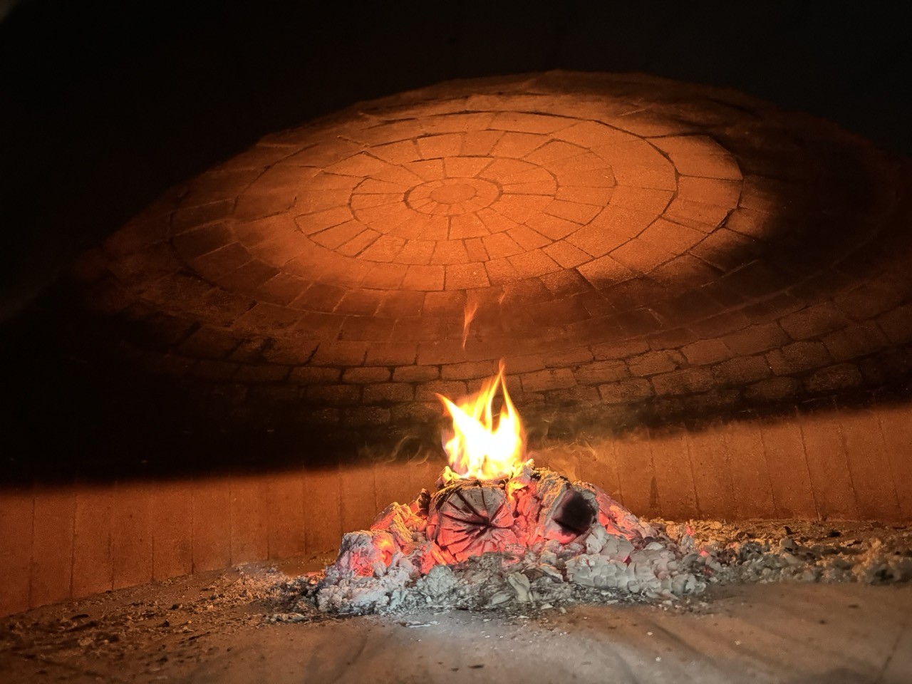

        Reading the dome vs IR Thermometer
        I’ve been using an IR thermometer to measure the temperature, which gives me a temp albeit only the surface temp at that spot. I’m watching the dome with interest, and have started to realise I can’t trust the IR thermometer 100%. It gives me different readings depending on where I point it, top hottest, then floor, then the dome from the top center down to the sides gradually decreasing temperatures The top of the dome reads hotter when the flames are touching it, and cooler as soon as the wood burns down.
        Russel mentioned a while back that the oven is ready for pizza when the dome is clean of soot. Or that’s what I understood anyway. My fires are getting hotter each day, and I noticed yesterday a spot in the top of the dome above the fire that was clear of soot when the fire is burning clean and hot. Today that spot was bigger, so I put my phone in to take a picture, and was surprised how beautiful it looked. Sharing that image with you below.
        Looking at this image, I measured the dome and it was 400C. Hotter again than I wanted but my oven has been drying now for a few months covered and protected. While there is moisture in the dome under the v-p-crete, I’m pretty confident now that the bricks are getting dry. Last night with the door on the oven retaining heat, I noticed this morning that moisture had been venting from the inserted vent in the top of the dome. Seems to happen more when the heat evenly disperses in the dome. I don’t notice any moisture venting when I have the fire going, but it was there in the morning.
        I’ll be honest and share I was on edge the first days wondering if the dome was going to crack. 4 days of fires later it has well tested and has held up perfectly so far.

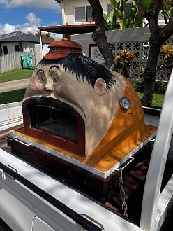

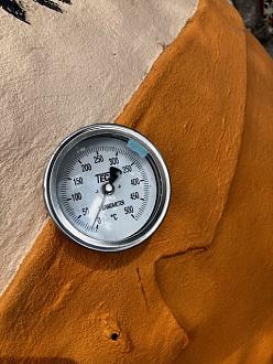

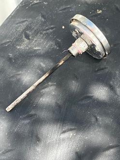

                              • 9211
                              #254
                              They are available online far cheaper and with different sized probes, but avoid the cheaper ones with very small (45mm) dials, they don't last long.
                              I have one on my mobile oven that I hire out, because folk renting it have no, or little experience working a WFO. I prefer my own senses for my home oven.
                              The probe should be flush with the inside surface of the dome. I have mine 1/2 way up the side of the dome. If there's flame directly under the probe, obviously it reads a bit higher. The probe should sit in a sleeve, mine is stainless which is epoxyed into a standard brass pipe fitting which the thermometer screws into.
                              Click image for larger version  Name:	IMG_1485.jpg Views:	0 Size:	100.2 KB ID:	462888 Click image for larger version  Name:	IMG_1486.jpg Views:	0 Size:	110.2 KB ID:	462889 Click image for larger version  Name:	IMG_1487.jpg Views:	0 Size:	157.8 KB ID:	462890 Click image for larger version  Name:	IMG_1488.jpg Views:	0 Size:	104.2 KB ID:	462891

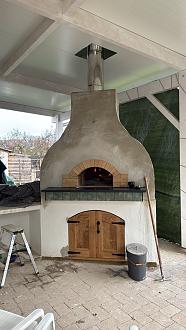

                                I put the insulated stainless steel door in last night, while there were still coals burning. This morning when I opened it the dome temp was 357C, and there were still read coals in the ash. Hot enough that when I put kindling on the pile of ash it spontaneously ignited. I got the next fire going for the day, put the door in the front of the arch to slow down the combustion, and retain more of the heat in the dome.
                                Referring to your input on the door, it’s holding up well so far. This morning I noticed the inner face had expanded and buckled a little, but straightened out as it cooled and returned to a flat surface. The sides and welds are holding well and they haven’t buckled at all. The front of the door this morning was 24C, not hot but warm, and the handles cold.
                                With a warm window of weather for the week, I took advantage and finished rendering the front of the oven, and put a layer of render on the dome. Very happy this morning to see it set up well. I will do two more coats when I’m happy this coat has totally dried and the weather permits.
                                This morning the oven dome is totally clear of soot, and not taking more soot as I burn wood, yet. It’s the hottest it’s been so far. It’s really beautiful to see. The cleanest I have seen the dome, not only burnt away soot, but all other dirt as well. Hallelujah!!
                                My biga has been fermenting for almost 48 hours, so making up the dough tonight and plan on baking it tomorrow.
