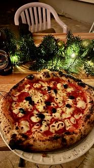

          Yesterday was my second bake. I made some changes, to the dough, the heating of the oven, and the baking of the pizza.
          The Dough - 100% Biga 70% Hydration
          I made up a spreadsheet to formulate recipes for biga dough, and yesterday it was a 100% 24 hour preferment Biga, with the final dough being 70% hydration, with 6 hours second rise after balling. The dough was perfect, very light and soft, and alive, easy to form into pizzas and not sticky. Rose beautifully in the oven, and tasted super.

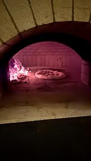

          Heating the oven
          I purposely started my fire later, with a goal to see how it would go to try an heat the oven in 2 hours. I started it about 30 mins earlier than planned, slowly building it to build up the base of hot coals. I loaded it up, put the insulated door on the opening, one side open enough allowing an inflow of air to feed the fire. That was so I could go to the Weihnachtsmarkt for an hour or so. I was gone for a bit oven an hour and wood burnt down nicely, with the oven close to my goal heat. I wanted the dome at 500C, with the floor at 430C. Dome was indeed 500C, but the floor was around 400C, little less than I wanted. But it worked. Unlike my first attempt when the pizzas burnt inside 30 seconds, this time I could allow them to sit on the floor while the dough rose and baked, turning them to get an even bake around the crust. Some i lift up closer to the dome to finish off the tops.
          WIth the temp at -3C, I was preheating the wood before putting it on the fire, as the initial pieces took time to warm up and then burn.
          The Pizza

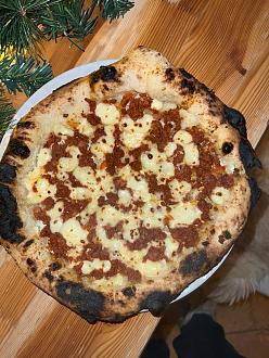

          Mozzarella, or mozzarella? I bought a couple of different types of mozzarella for the pizza. I never considered there are different types of mozzarella for different applications, but seems there are.
          • 1kg roll of mozzarella that I cut into pieces, tasted ok, but didn‘t melt as I anticipated. I think it is more suited to slicing and making bruschetta with tomato etc. I wouldn‘t buy it again to use on my pizza.
          • 2 kg bag of what I think is mozzarella especially for pizza. It’s grated, but in approx 5mm thick sticks, and melts beautifully, very stringy, and tastes really good. It was bubbling on the pizza after about 45-60 seconds, unlike the other that didn‘t bubble like this one.
          With the cooler floor the pizza bottoms were nicely baked, not burnt. This time with my new pizza peel with 1.5 meter handle, I could easily lift the pizzas up to the top of the dome so I could control the cooking a bit more depending on the oven heat.
          Limiting my toppings each bake, yesterday tomato, salami with mozzarella and olives was my wife’s choice. I wanted to try something new, so cooked up a drying bolognese in the morning. Then used thickened cream on the base, followed by bolognese, and mozzarella with some basil. I called in my lasagna pizza, and with -3C it hit the spot.
          My pizza dough
          For a 32 hour pizza dough, I was really impressed. I wanted 100% biga with the temp being -3C. After mixing the pre-ferment I rested it for 6 hours at 20C in the kitchen, before refrigerating it overnight at 6C. Then 2 hours back at 20C before mixing in salt and additional water to bring the hydration to 70%. 2 hours rest at 20C before balling, and then 6 hours rising at 20C before moving out to the oven for baking. There it was -3C, but the dough stayed soft and pliant. Baked beautifully, lots of air inside, soft, tasty. A little charing on the crust, but that was me leaving it a little long close to the coals. I don‘t mind that, as I think it adds to the flavour.
