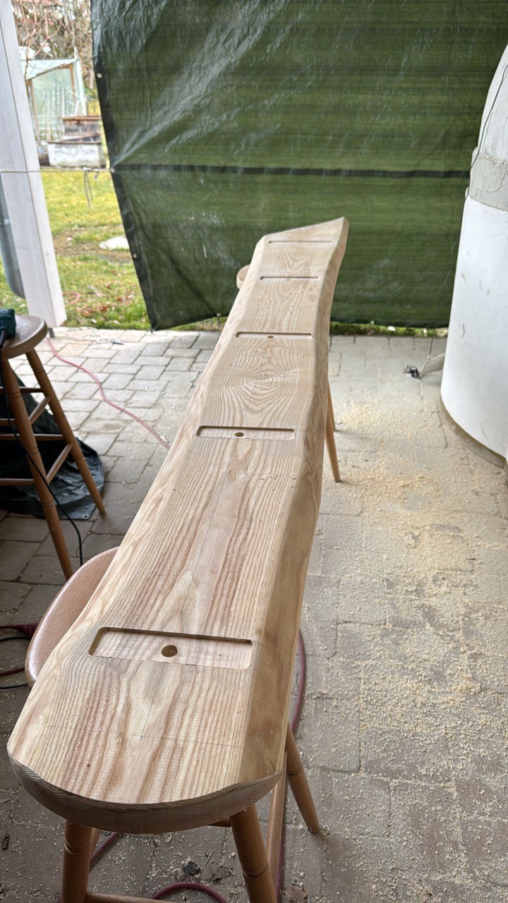

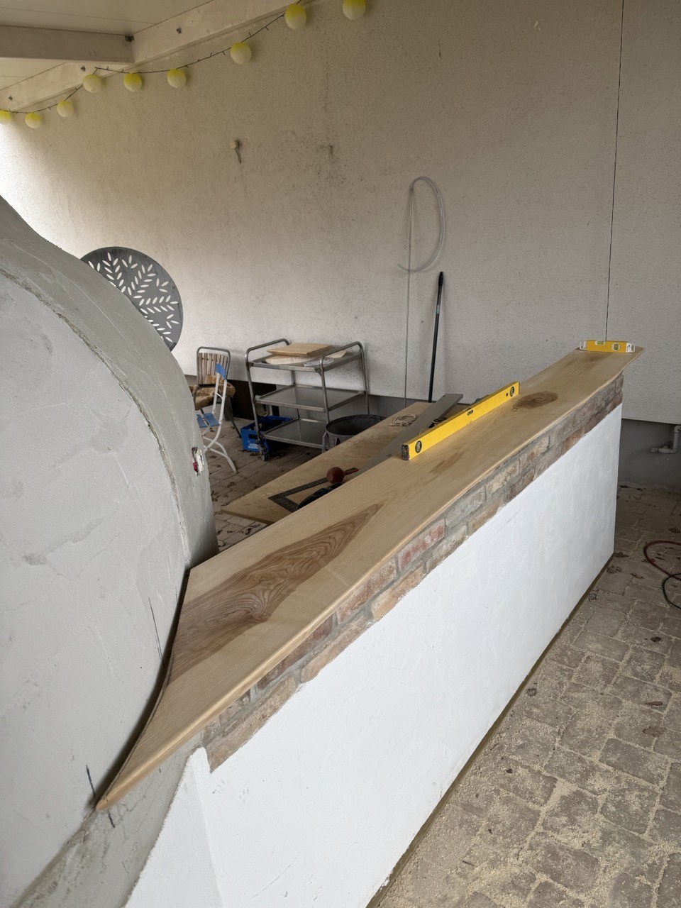

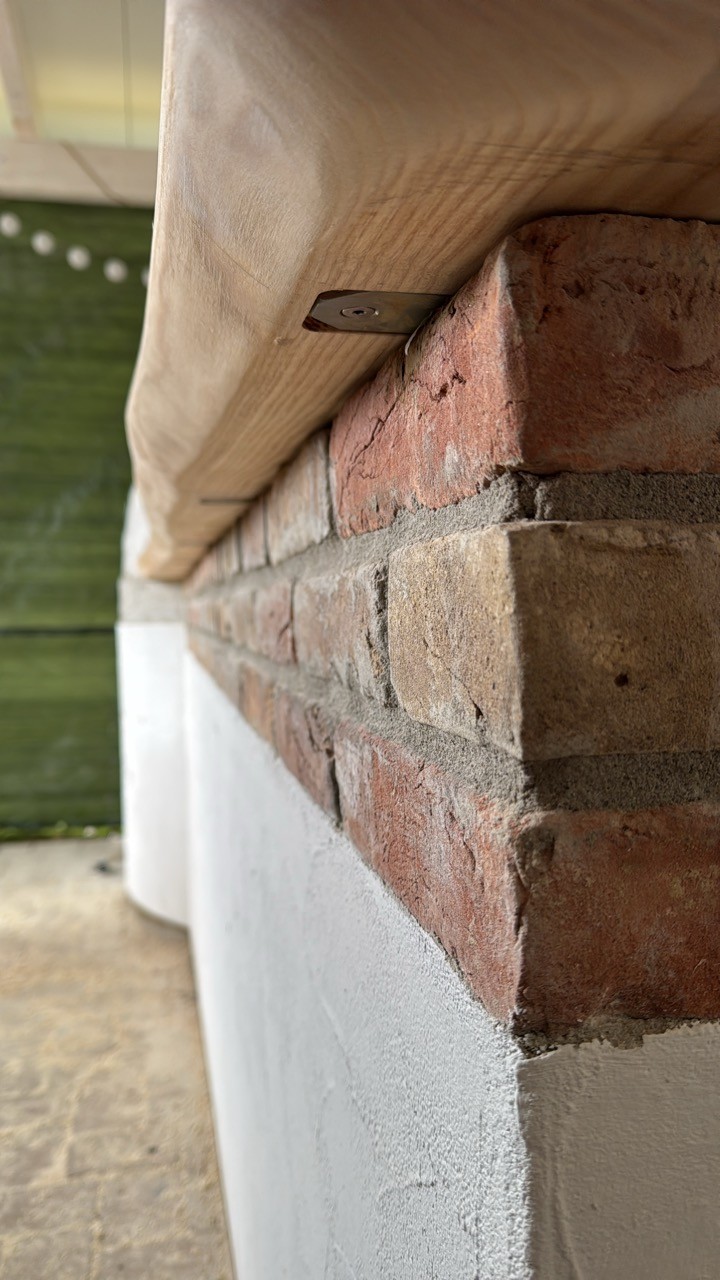

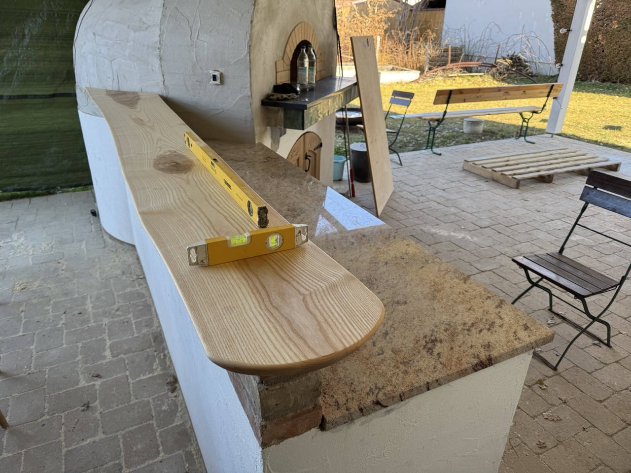

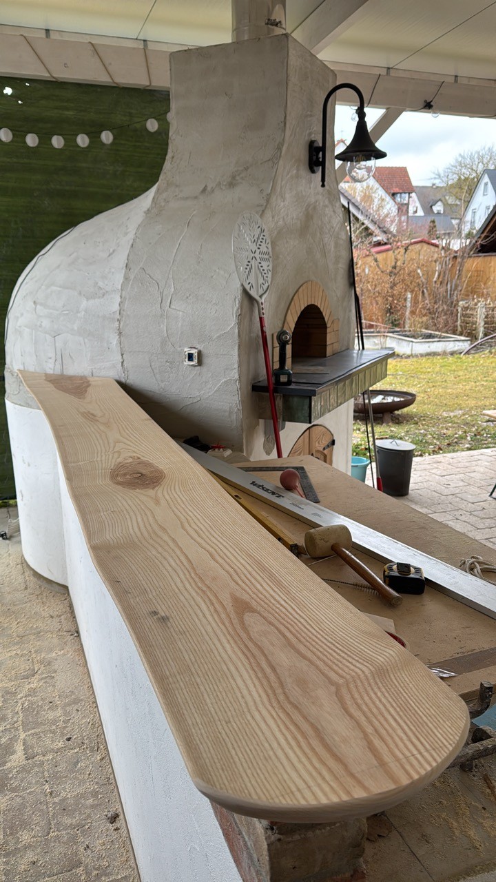

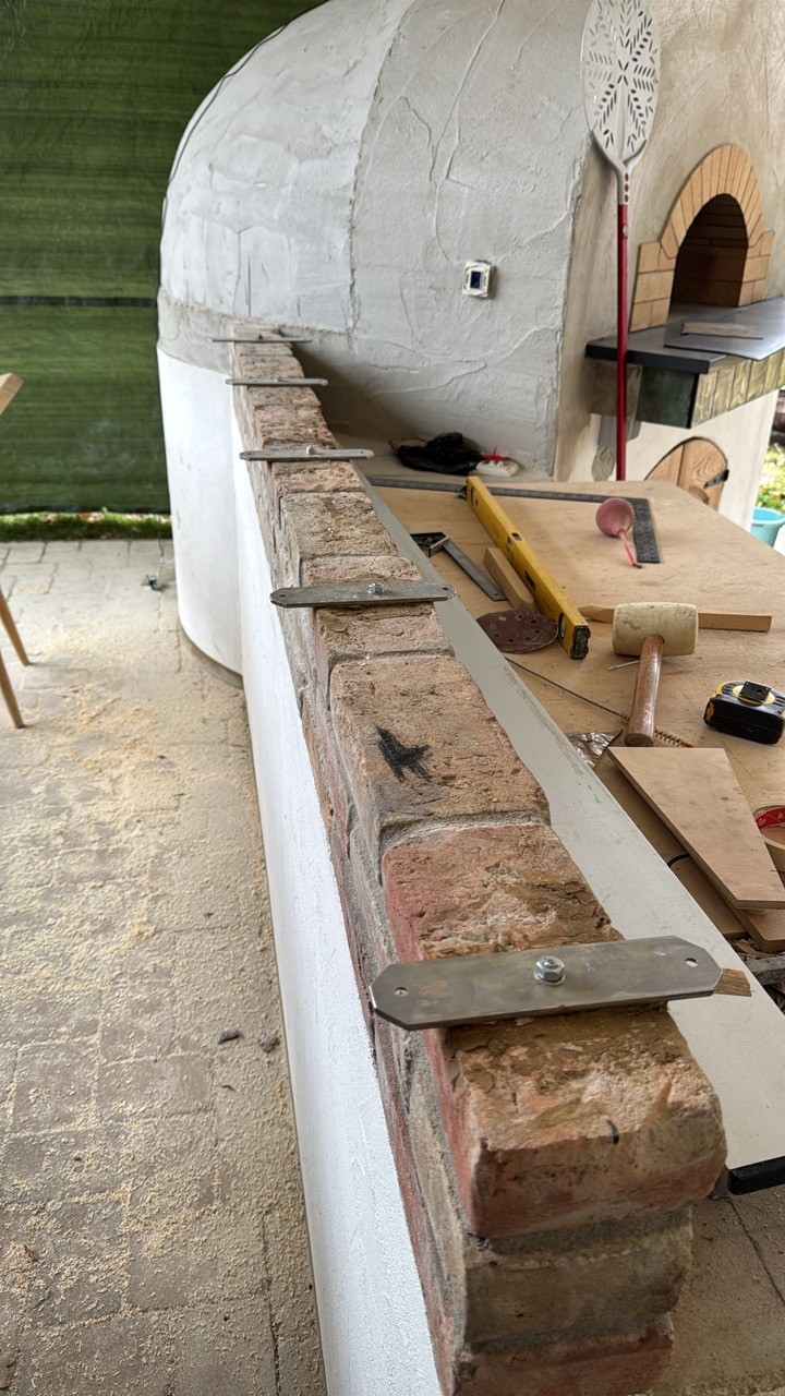

    Ash slab bar fitted
    This week I picked up some 50 x 5 mm stainless flat bar and made some brackets for the top of the wall behind my pizza work bench. I glued some threaded rod in the wall so i could fix the brackets on top of the wall. I wanted the brackets to be flush with the bottom of the Ash slab when it is laid on top. Routered slots for the plates in the bottom of the Ash slab, then screwed through the plates into the bottom of the slab to hold the slab down flat. 5 plates over 3 meters should be strong enough to hold the wood in case it wants to warp with the humidity.
    I cut the end of the slab that fits against the oven dome, leaving a little excess so I can make that custom cut once the final layer of render is on the dome, and it’s painted.

    I wanted to do it this way to allow the bottom of the slab to breath. It was cut 2 years ago, and has been tried under cover, but still not fully dry. 26%, which I was told with the humidity here is ok under the terrace roof outside. I’m oiling it, screwing it in place and then waiting to see how it fairs with time. If cracks appear, to be honest I don’t mind because epoxy mixed with black iron oxide is a great way to fill them so they become a feature, not a flaw.

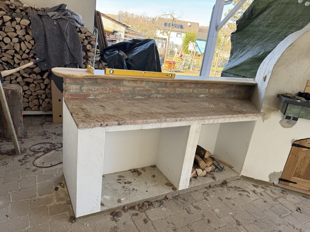

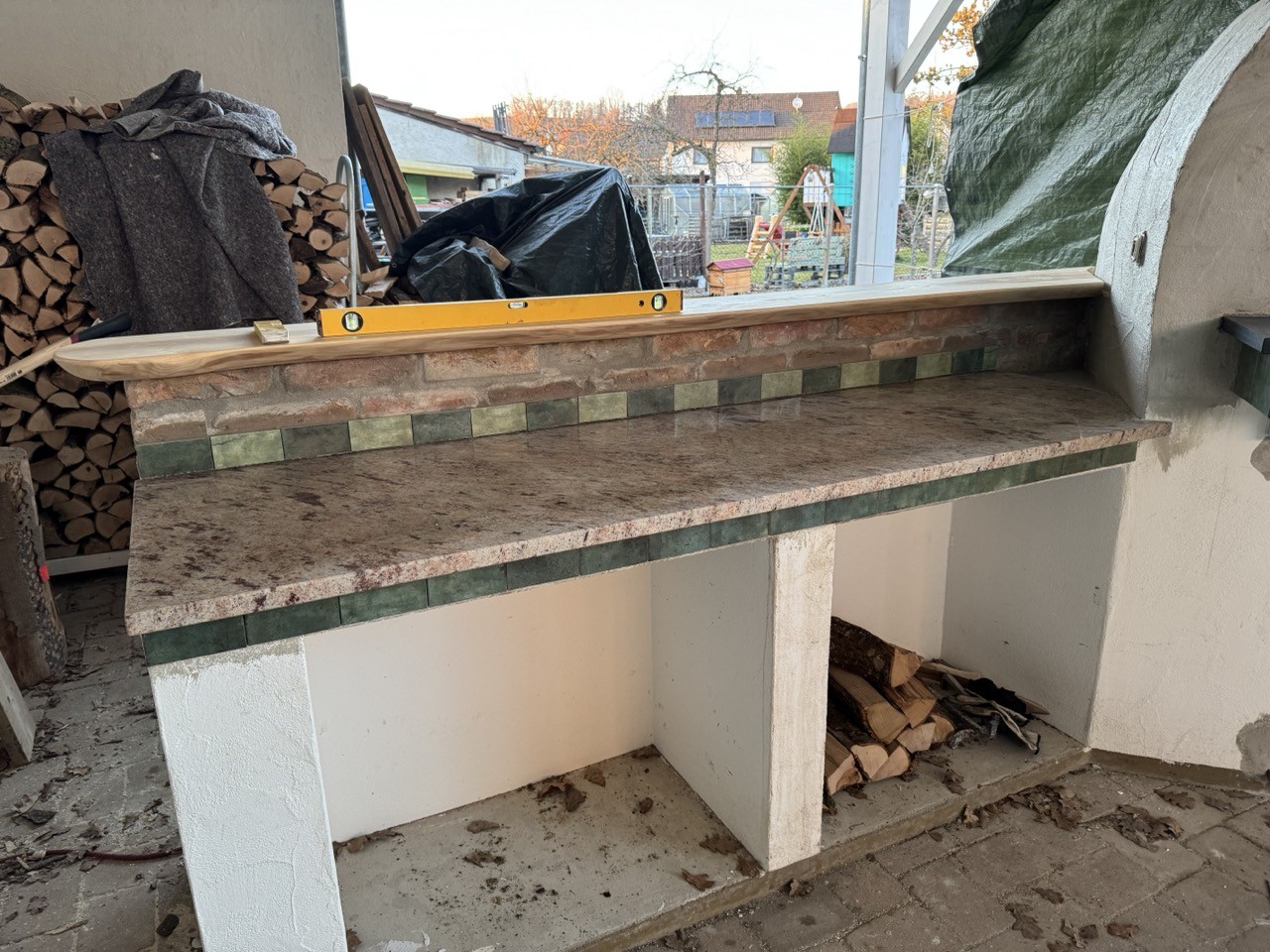

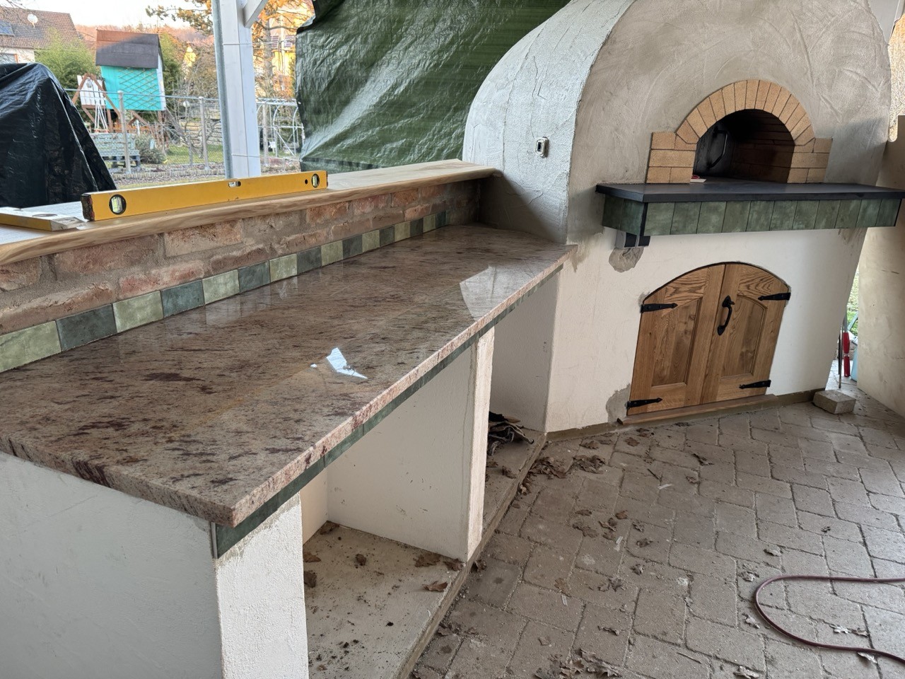

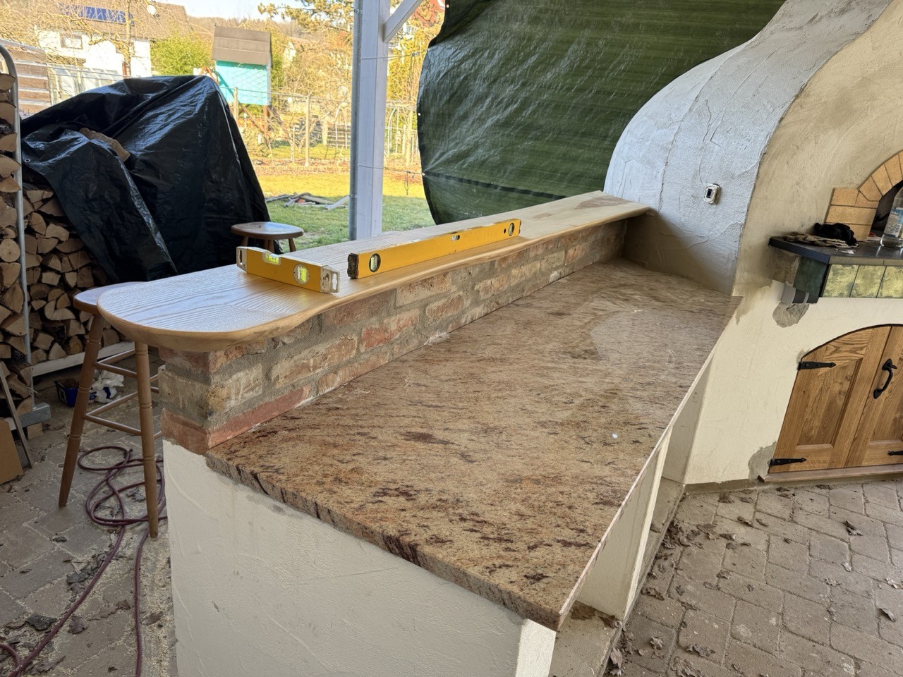

      Granite Worktop Set
      This week we have lovely spring days, 10-14C, with sunshine. My bees are loving it, the first day I see them coming out and orienting themselves for exploration flights.
      The warmer days are great to get back into finishing off details of the oven, that I couldn’t complete with the onset of winter 2024. Today was a big tick, and thinking about how I was going to move the granite was faer worse than just doing it. 120kg top, 2200 x 630 x 30mm. I created a template out of mdf so I could mark and cut one corner out of the top, needed to fit in against the oven. That way I was able to leave the granite laying on the pallet and cut it there with my 125mm grinder and a masonry blade.
      I fitted perfectly, with four of us to move the granite in place, many hands made light work. Really happy with the choice of color too, as it blends with the other colors around it.

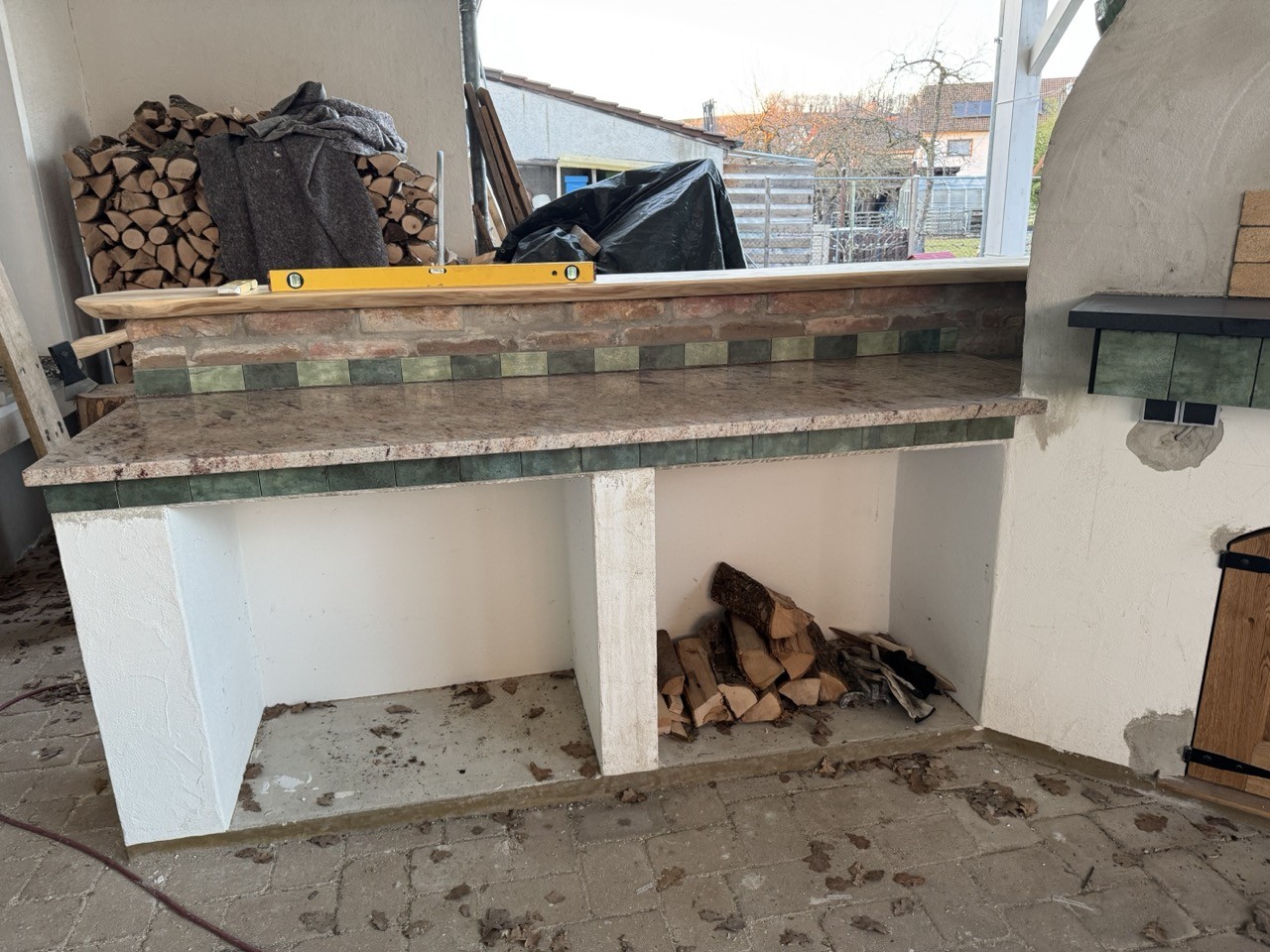

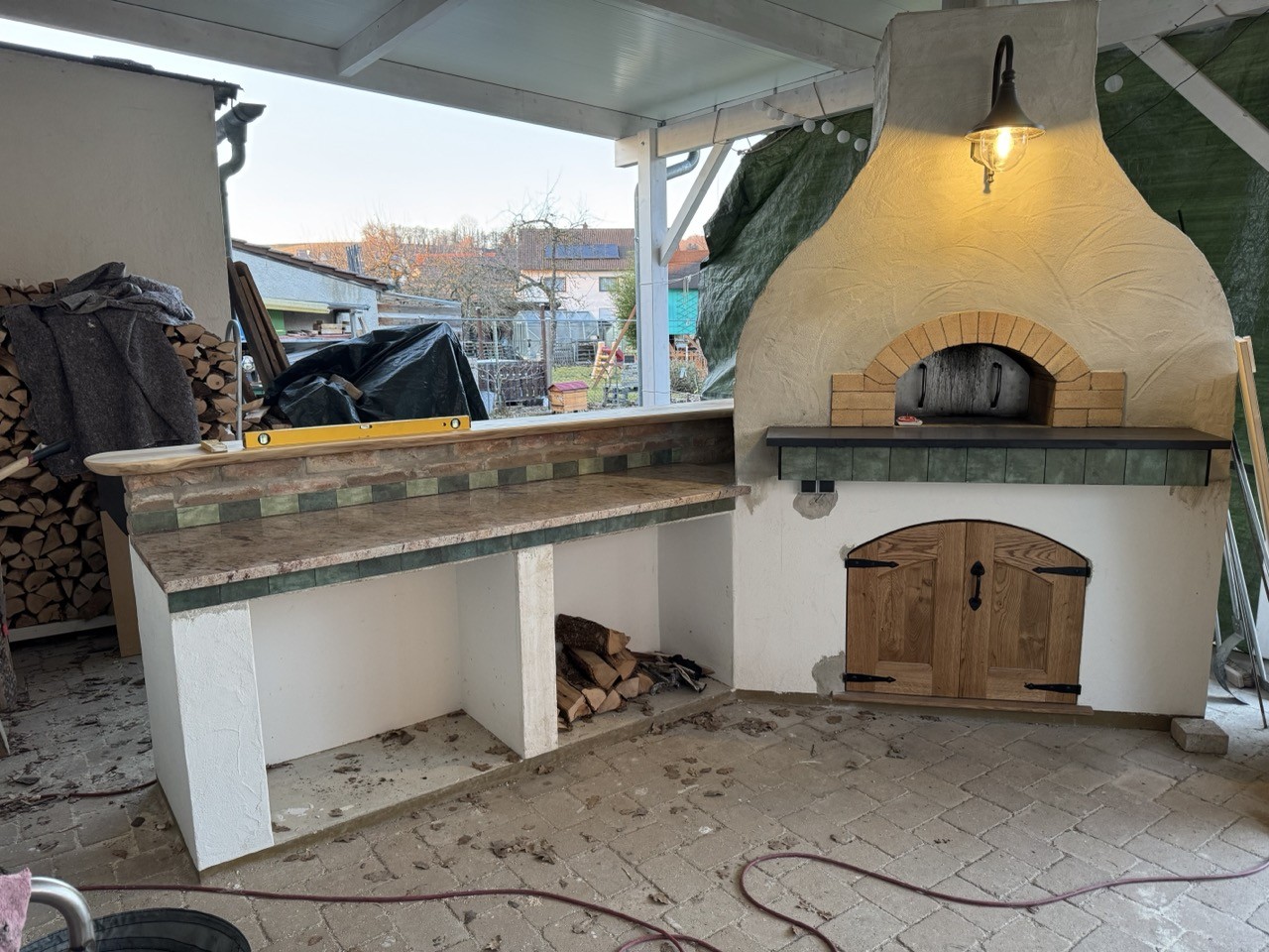

            A little bit of tiling completed today
            Making the most of the warmish spring days. Today I decided to add some tiles under the granite worktop, and at the back of the worktop on the brick wall. Hand made tiles from Italy, a color that reminds me of earlier days diving in Australia. Lived near, and spent a lot of time in the ocean, so it’s a strong connection, and nice to include a color that triggers fond memories. Turquoise green.
            I still have to grout, but I’m taking a 10 day holiday on Friday, and will get into when I return.

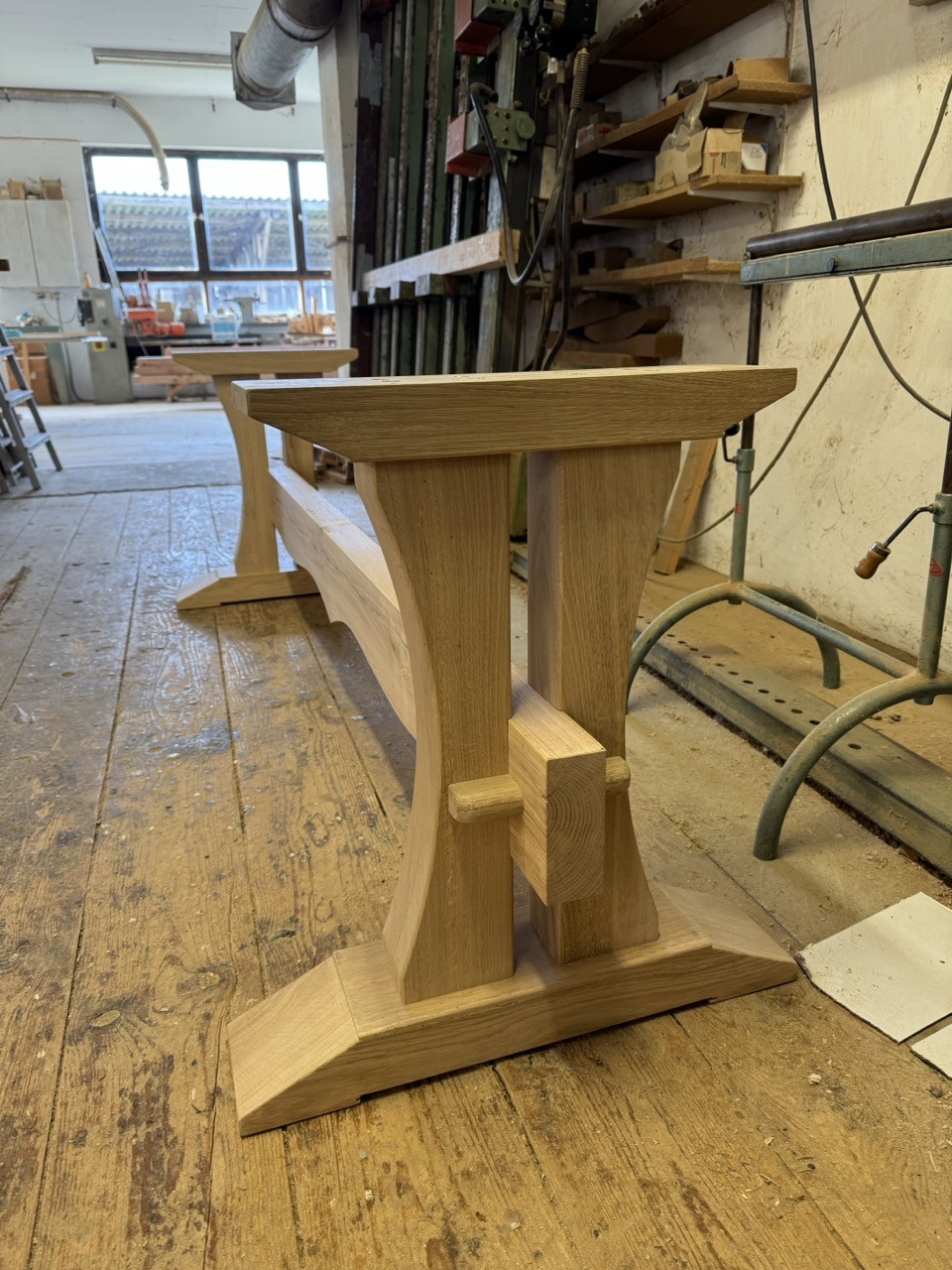

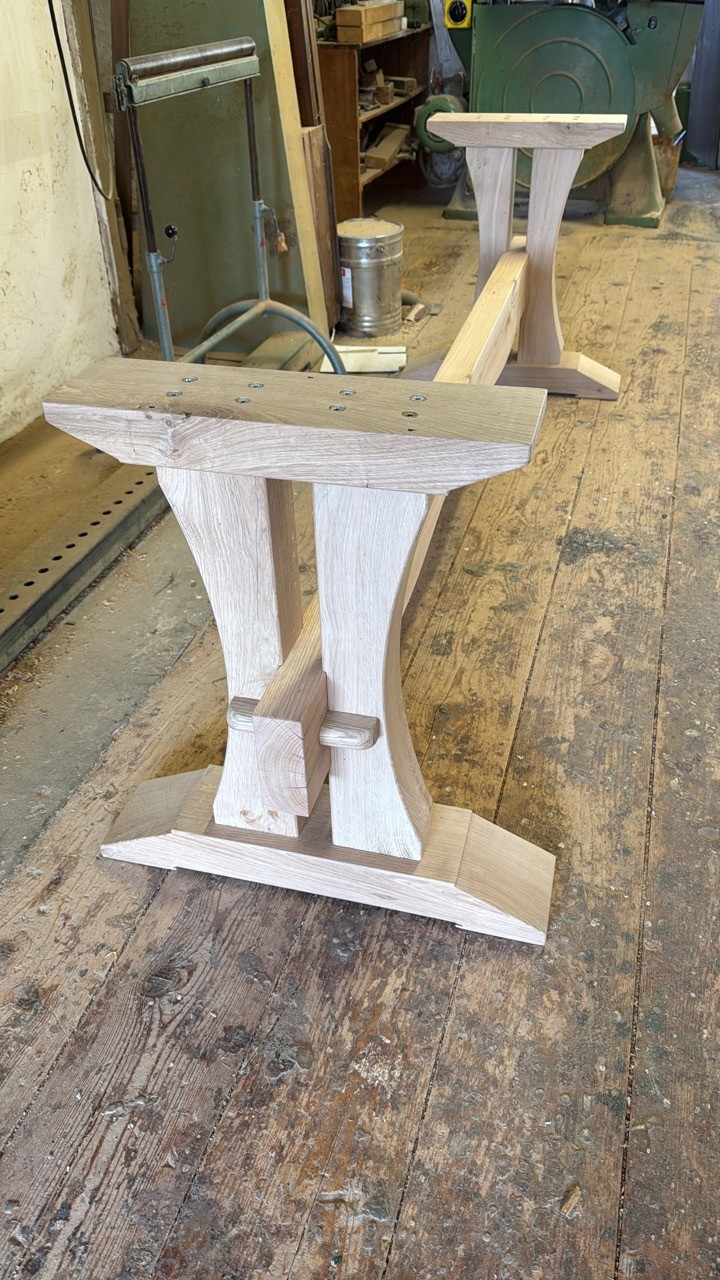

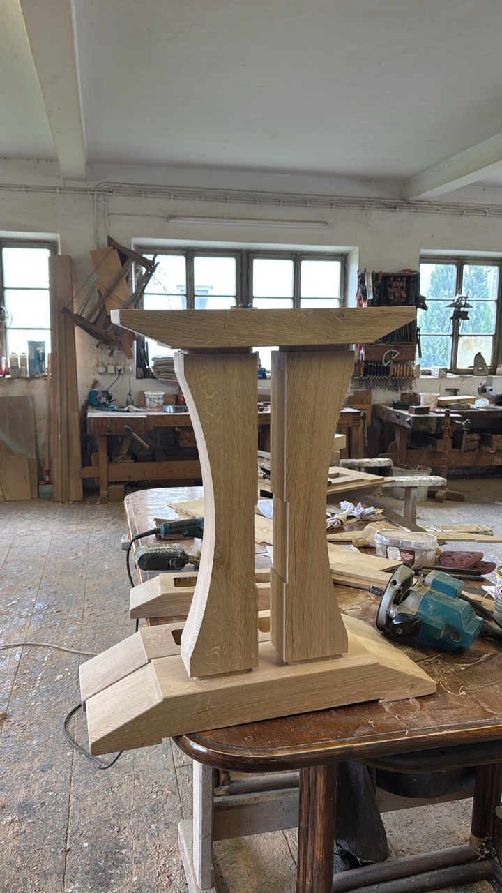

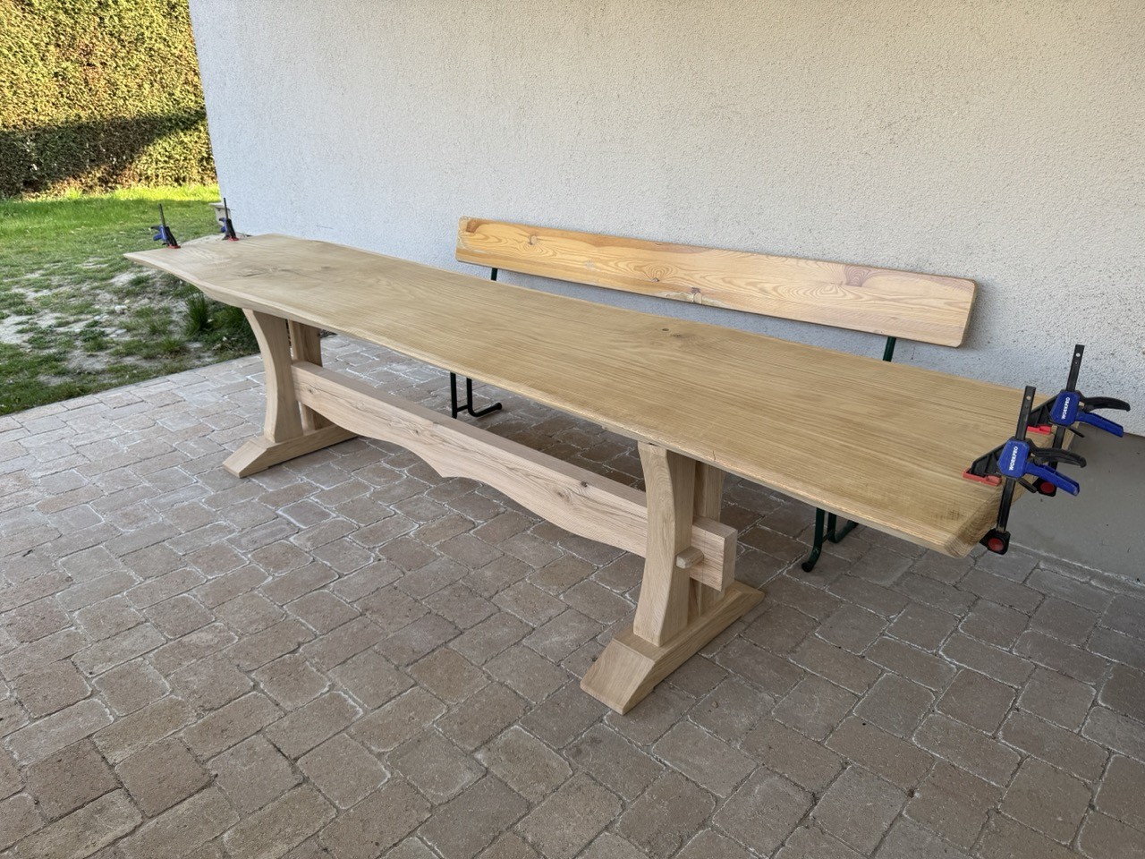

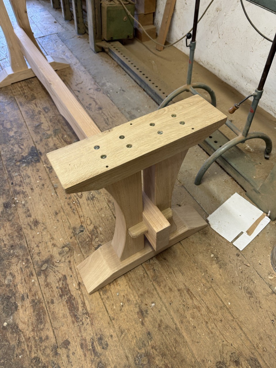

                  Oak Table
                  I picked up a nice slab of oak about 6 weeks ago. 3300 x 800 x 85mm after I finished cleaning it up. It’s still not fully dry, as it was sliced in end of 2023. So I‘m letting it be for a couple more years before finishing it off with a router sled to flatten it perfectly.
                  I was on the lookout for some rough cut dry oak, and a few weeks ago found some that was cut 13 years ago. I took it to my local sawmill where I was able to use the machines to cut it down to size, and build it into a nice solid oak stand. I did that this week, and got it home yesterday. Looks really nice on the terrace next to the pizza oven.
Name:	C2741C5E-31F9-4C8B-98F0-D15E917FE13C Large.jpeg
ID:	465131 Click image for larger version
Name:	59E9C669-45D2-4F05-B88B-7294C2742B42 Large.jpeg
ID:	465132 Click image for larger version
Name:	IMG_8549 Large.jpeg
ID:	465130 Click image for larger version
Name:	IMG_8551 Large.jpeg
ID:	465129 Click image for larger version
Name:	IMG_8558 Large.jpeg
                  It‘s heavy, so I know no one will ever be able to walk off with it . Sits 12 people easily. I have 2 x 3300 x 400 x 50mm slabs of oak I also machined down this week. Now to work on building some legs that will match the table.

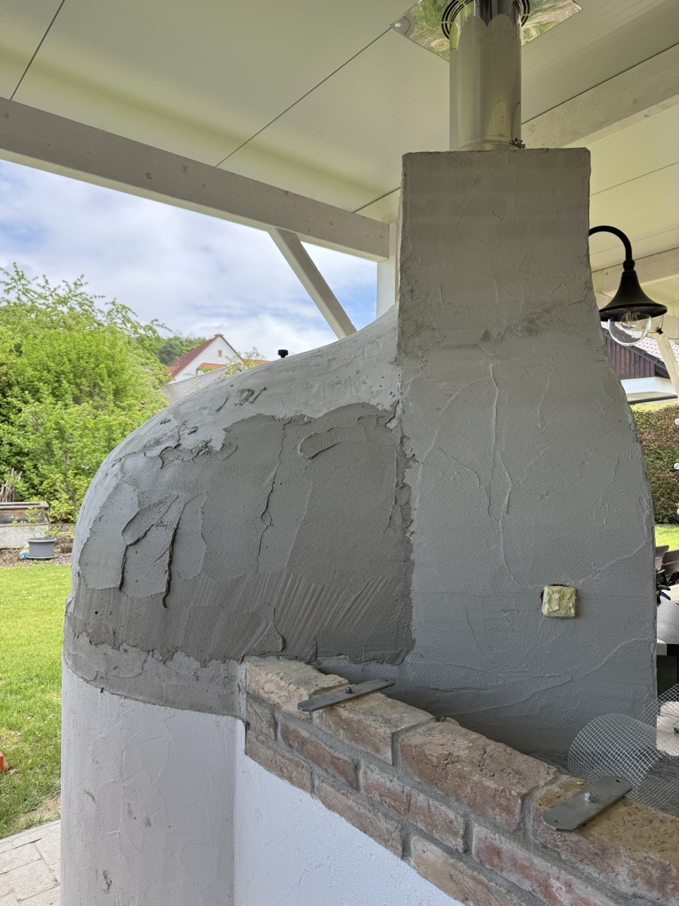

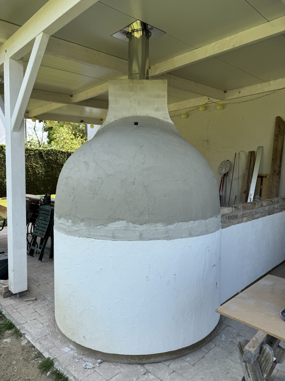

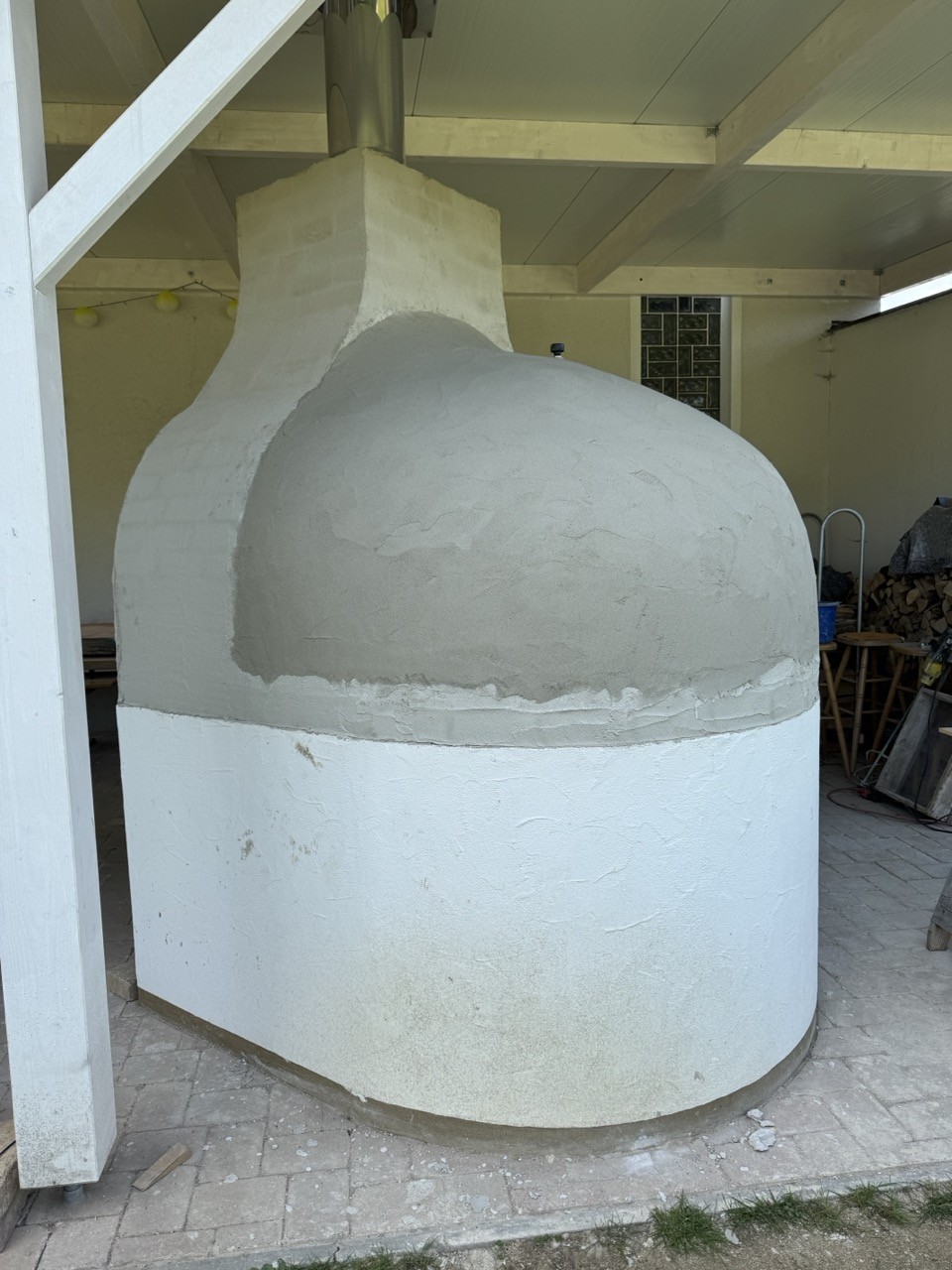

                          Dome render

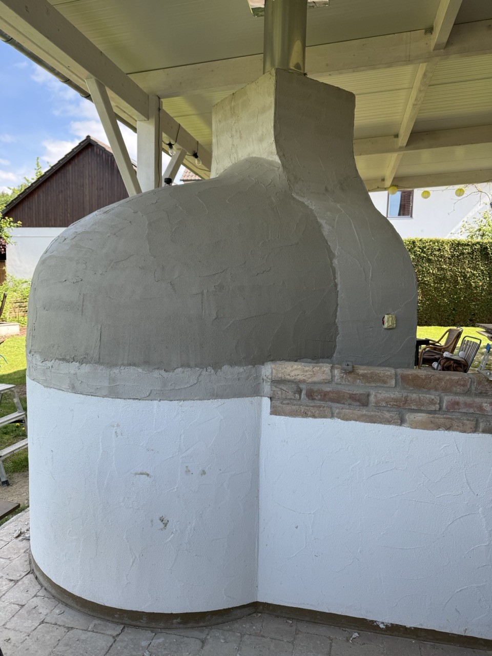

                          I’ve been a bit busy with multiple projects this spring. A couple of days ago I had a window of time and the weather was fine so I put the second last coat of render on the oven dome. Been waiting for it to set sufficiently so I can put the last layer.
                          I’m adding reinforcing mesh where the dome meets the stand and chimney to prevent the possibility of cracking in those spots as it dries. I’m looking forward to to cleaning it up and giving it a final lick of paint.
