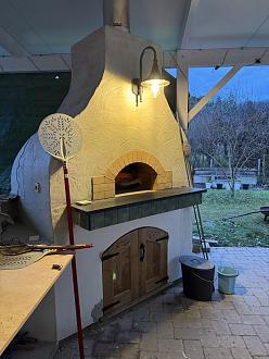

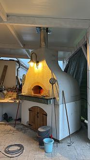

        I dreamed about having my oven for years, all the concepts I had have been blown away, in a good way. The oven is far beyond what I could have imagined. Amazing how powerful it is, which I totally underestimated and consequently had some burnt pizzas to begin with.
        I‘m still finding the balance of knowing how fast and how long to preheat the oven, but I‘m just being scientific with it experiment and find what works best. On my last bake on Monday, I had set up my kindling tower, and put extra wood in the oven while the oven was still warm from the last bake. The wood was dry and warm, and lit really easily. Burnt faster too, which is ok because it build up the bed of glowing coals. After 2.5 hours, I moved the coals to the side of the oven, and had to remove a bucket full as there was just to much. The dome and floor were both at 500C, so I wiped the floor down with a freezing wet cloth to cool it a bit, but that only took 10C out of the floor. I still had to wait a bit before putting my first pizza in the oven to save burning the base. When I did put the pizza in, it was my best to date, perfect crust full of air, very light to eat, crispy on the outside and soft and chewy inside.
        Even with the oven at 500C, sometimes over 550C, there is no heat reaching the outside of the dome. Also, the chimney is cool on the outside, with no heat on the outer wall. My insulated double walled stainless steel flue gets to 10C on the outside. I thought it would get much hotter, but with the arch, vent and schamott flue being the first 1.5 meters above the vent, that takes the heat and is well insulated with ceramic fibre and perlite.
        Day 2 after baking the oven is consistently around 300C, with day 3 around 220C, and day 4 170C. Using this retained heat I have been baking bread, and tried some ribs which were the best I ever had. Using the ovens retained heat, and having to open it up to measure the temp wth the IR thermometer, I understand now the advantage of installing a probe thermometer to be able to know the internal temp without having to open it. Knowing that they all fail at some point, i will install one eventually, but in such a way with a sheath that I can easily replace it when needed.
        Finally put my light on the front of the oven last week, and added a double power point under the landing, along with 6 more power points alone the back wall of the terrace. You can never have enough power points is my view. I ordered my granite benchtop, but that won‘t come for a few more weeks, and then I‘ll only install it when the temp is warm enough.
