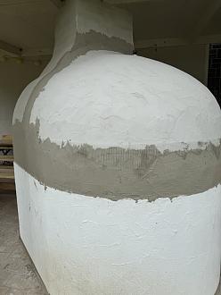

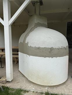

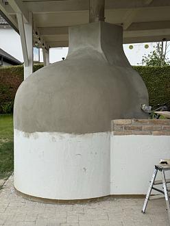

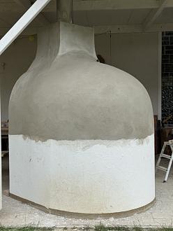

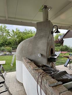

        Final layer of render on dome
        This last week I have been working on finishing the final layer of render on the dome. I incorporated nylon mesh where the dome render meets the base and the front chimney structure to reduce any cracking if there is movement. At last, a bit over a year after starting the oven the rendering is done. With the warm weather expected this week I should be able to paint it in about a week. Then I‘ll refit the Ash slab on the bar at the rear of the preparation bench top. FInishing the details is really fulfilling.

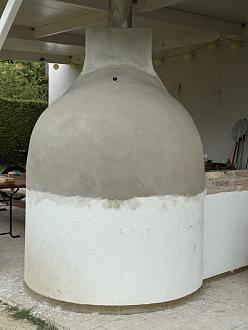

          Adding reinforcing mesh to render

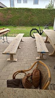

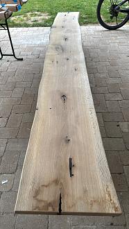

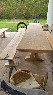

            Matching oak bench seats for oak table
            This week I also planned down some oak slabs and built to matching oak benches to go with the oak table. The oak is well seasoned, 13 years since it was cut. I have started filling cracks and blemishes with 2 part epoxy colored with black iron oxide. Its a tedious process, as I need to wait 24 hours after filling before being able to sand it flat, then move to a different side. Once the filling and sanding is finished, I can oil it.
            I really like how adding the black epoxy not only fills blemishes, but also highlights and makes a feature of them. I‘ll put some more pictures when it is done.
            The bench tops are 3300mm x 400mm x 40mm. I kept the natural sides, only removing the bark and sanding to smooth the edges.

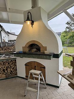

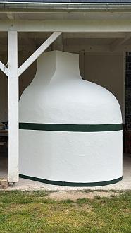

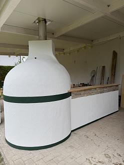

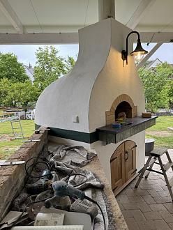

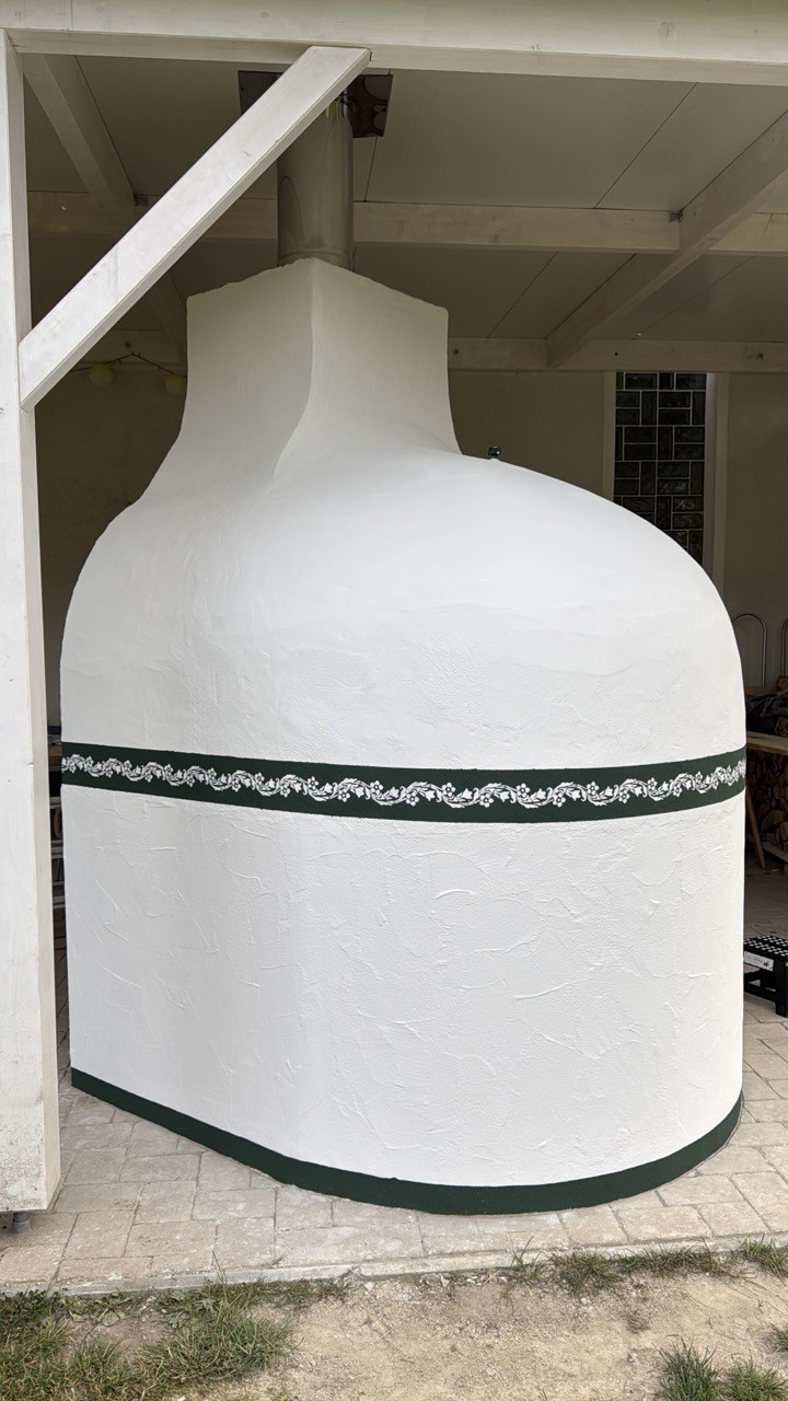

                Oven painted, light switch fitted
                The last days I fully painted the oven, giving it 3 coats of off white. Added mission green skirting and waist band. Waiting on a stencil which I will use to add a nice pattern around the oven on the green band.
                Waiting on some more 2 part epoxy resin so I can finish off the bar, oil it and screw it down on the back of the bench. Then I can finally clean off the pizza bench and put it to the work its intended for.

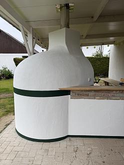

                  #323

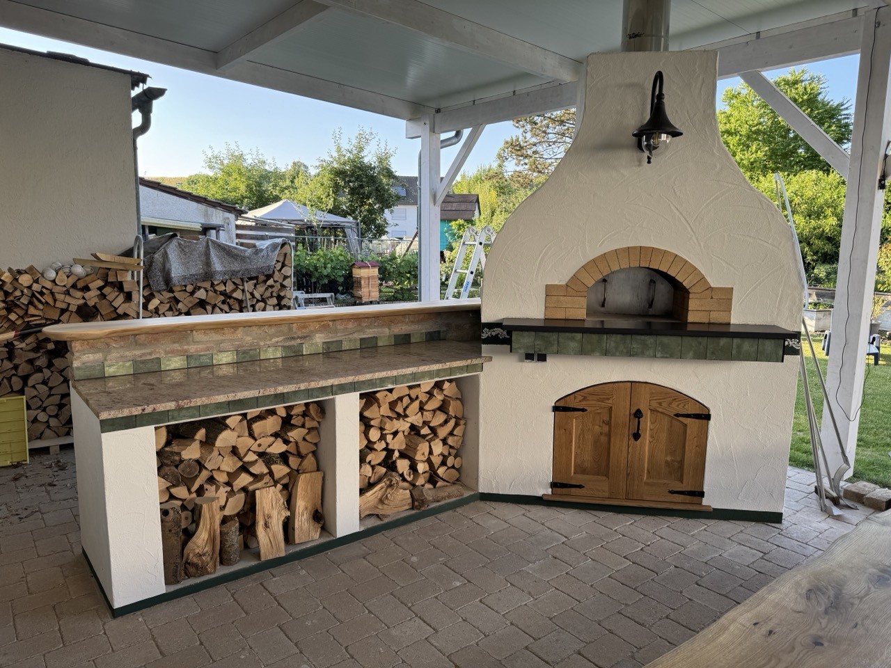

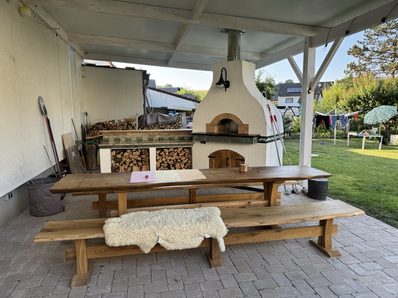

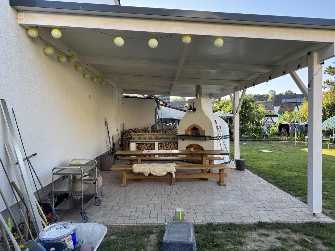

                  Table and benches for oven completed
                  Summer is getting hot here, and I‘ve been busy digging foundations for the new terrace on the side of the house. I also have been working on finishing the oak table and benches for the pizza oven. Filled the cracks and blemishes with black epoxy resin. Sanded and oiled, was a time consuming process but it‘s finally done and very happy with the outcome.
                  I painted a floral stencil on the green stripe around the oven. Lines up with the tiled landing on the front of the oven.
                  This arvo I put all my tools away, uncovered the granite, cleaned and sealed it. With the heat, the insulated roof provides a cool shaded space, with great air circulation. This week I‘ll fire it up and get back to cooking pizza. I‘m thinking a 48 hour biga pizza dough. Biga proofed at room temperature and the dough refrigerated overnight day 2 before cooking.

                    • 5261
                    #324
                    Top notch project, very nice.
                    • daidensacha
                      • Jan 2024
                      • 207
                      #325
                      Thank you.
                      It was on my bucket list for many years since I first came across the Forno Bravo plans.
                      A year planning it out in Sketchup, working out details, with the very kind help from your forum.
                      Challenging working with the stone to fit my vision and design. Long sweaty days, but I would do it all over again.
                      I‘m so happy I didn‘t compromise on insulation, as with the heat retention I can use it for 4-5 days from the initial heating. Pizza, meat, cakes, vege‘s, herbs.
                      Your support has been amazing, and sooooo appreciated.

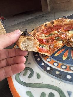

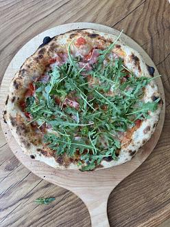

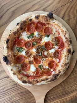

                                I’ll start by saying this journey of finding my ideal pizza dough has successes and failures, but that even the failures are successes in that they are learning experiences.
                                1. 72 Hour cold fermented 100% Biga dough.
                                Tuesday I started a 72 hour cold ferment 100% biga dough which I cooked yesterday. It was not good, lacking gluten development and really difficult to work with and get in the oven without breaking. I checked my yeast to see it is still good, and ordered new yeast, but in my test it started bubbling in 10 mints, so should be good. Possible it was too little yeast, or I needed to add a little more when mixing the dough. Eatable, not to my liking. I used 1 gram of IDY in 1017g of 00 Pizza flour with 45% hydration. I did try to mix it in my mixer in reverse gear per the youtube video I got the recipe from, but it was very dry. I’ll try it again, but I’ll adjust the biga to 50% hydration, and add a little more when mixing the dough.
                                2. 30 hour room temp (22C) 100% biga dough.
                                Started the biga yesterday at 12.30pm, and due to an appointment this morning I wasn’t home to mix the dough until 1.30 today, so it was a 25 hour room ferment. Lots of gas, at 50% hydration, when I broke it up to put in the mixer it was already a little sticky. My dough was 68% hydration. By the time i added the salt, malt powder, and water it was really sticky difficult to handle. I left it to bulk ferment, and then divided it to 280g balls once the bulk ferment had doubled it in size. A little oil, with some folds it became easier to handle, and at 6pm I was baking. I would rate it as one of my best to date, and while I’m still refining it, it is becoming my go to dough as its easy, and quality for a 30 hour 100% biga. It was almost 30C today. I would cut the biga to 60-80% next time I make it on such warm days. Also, we went out this morning leaving the kitchen windows open, when the blinds up, so the kitchen got quite hot. Not ideal, and good to remember in future when fermenting at room temp in the kitchen.
                                Pizzas as follows:
                                1. Margherita - Tomato, mozzarella, fresh basil, parmigiano regiano, buffalo mozzarella, + extra sweet corn as a special request
                                2. Crudo - Tomato, mozzarella, fresh basil, parmigiano regiano, ham, buffalo mozzarella, pepper, salt, fresh rocket + extra home pickled jalapeños
                                3. Maurizio - Mozzarella, fresh rosemary, pepper, salt, olive oil, parmigiano regiano.
                                4. Diavola - Tomato, mozzarella, fresh basil, hot salami, home pickled jalapeños, buffalo mozzarella, parmigiano regiano
                                The cornicione was really nice with good rise and air pockets, crumb was super soft and moist. Very tasty and light to eat, with beautiful leoparding, and a good lasting crunch.
