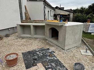

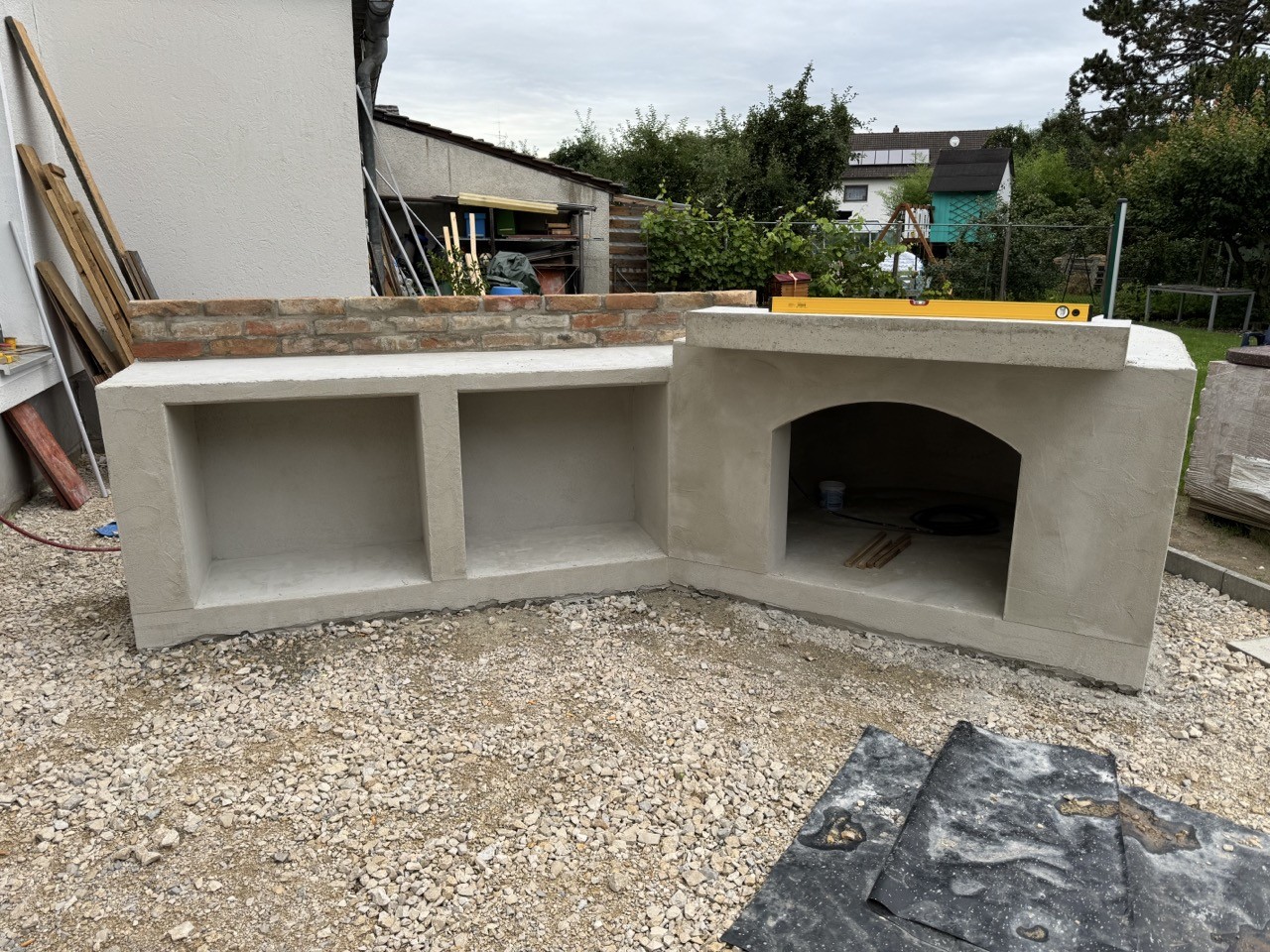

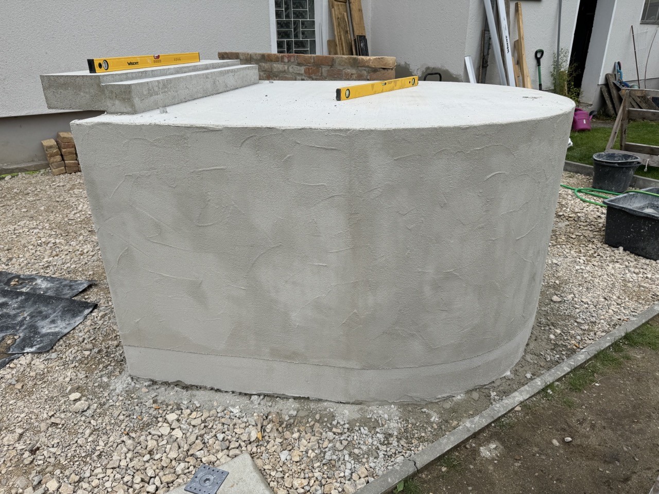

    Finished rendering the oven stand at last
    It’s been a really wet start to summer this year in Bavaria. When it rains it really pours, and it’s been really unpredictable. It’s been a bit hard getting a run at rendering oven stand, but today I finally managed to finish it. I’m going for a rustic theme with the finish, so visible washed out trowel marks are visible. I added a smooth skirting around the bottom that I will paint to match the okra color of the pavers.
    Going with the rustic theme, I added 3 courses of recycled hand made historical red bricks on back of the work bench. I want to use the same bricks for the decorative arch and possibly to add character when building up the chimney.
    I’m elated the oven stand is done at last, that was heavy work, and required learning new skills to get it done. It was worth it though.

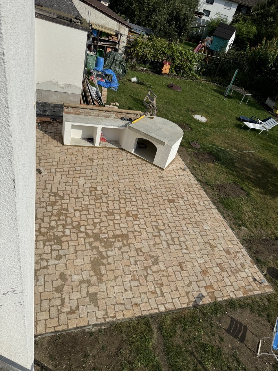

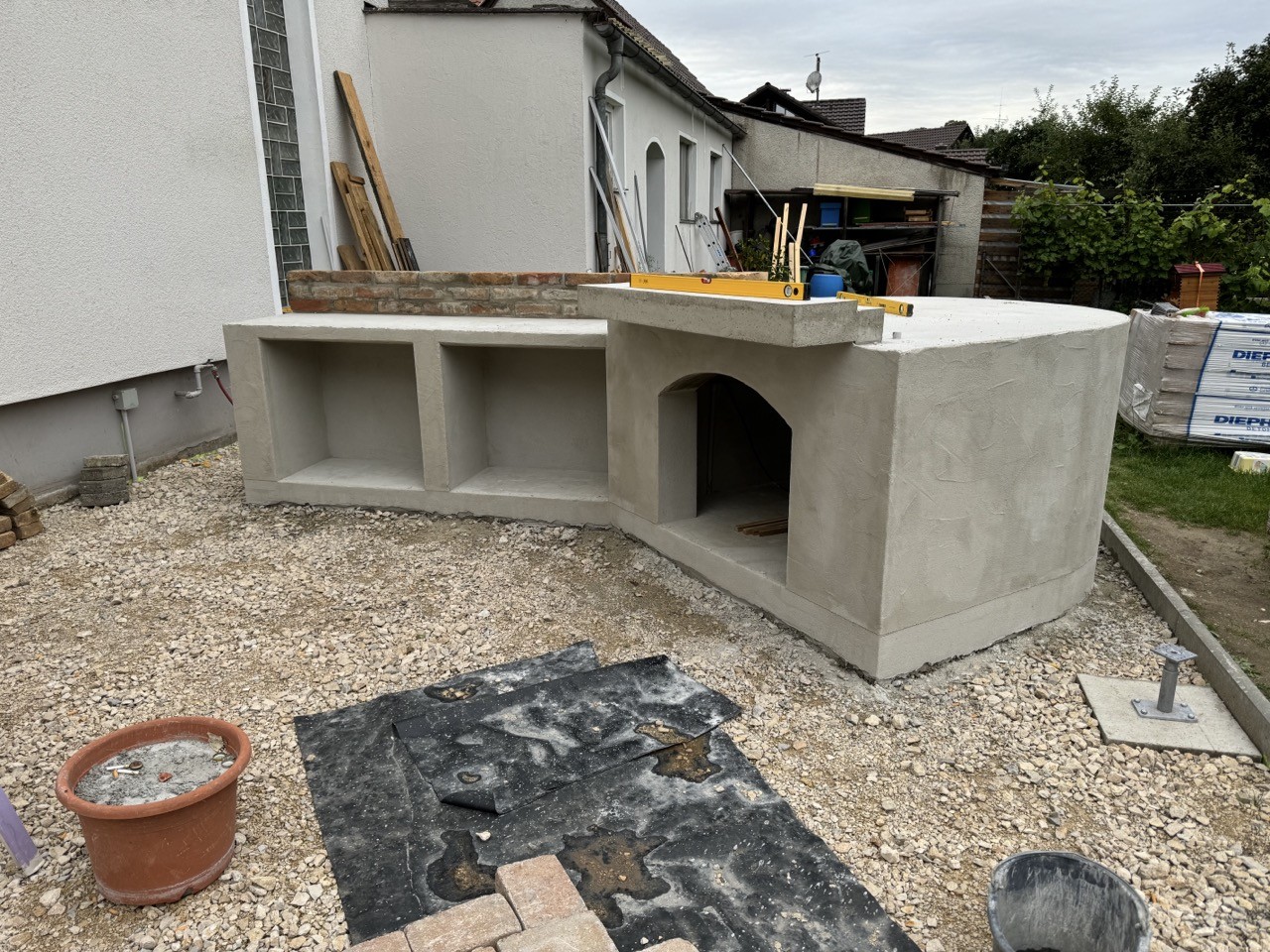

        Construction moving forward.

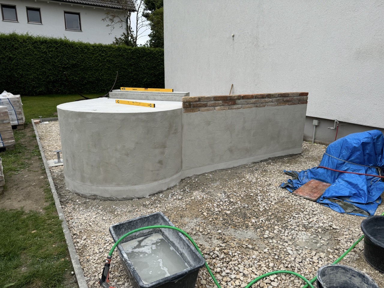

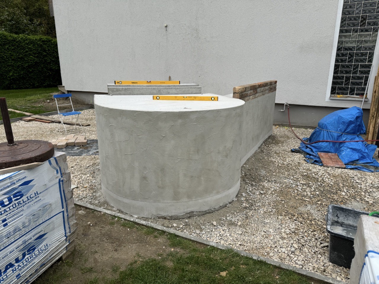

        I received approval for our terrace construction this last week, so I was able to order timber which will take a few weeks before it is delivered. Also ordering sandwich panel sheeting for the roof.
        I finished rendering the base and gave it a lick of paint before laying the paving. It will get another coat once I have finished the dome.
        I was able to lay 4 pallets of paving last week, but was 3m² short of pavers. The extra pavers also come from the factory so that will be next week before I am able to finish the paving and put that job behind me. Overall happy with the job so far. Once I lay the final pavers I will run a compactor with rubber mat over them to set them and even the surface.

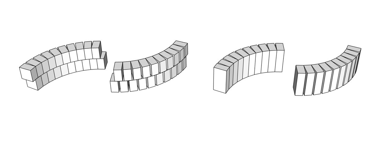

              Thanks for your input David. I appreciate it a lot. I understand there will be many different opinions, and it really depends on the particular application as to what fits best. I‘m one to weigh up the info at hand and given I will live with the consequence, make the decision I think best for what I am doing.

              I knocked up this image in Sketchup. I gather this illustrates what your preference would be, to have two courses of half bricks atop each other in place of one course of full height soldiers. I can understand it would add additional strength, while giving the required height before beginning the curve of the dome.
              Cutting the bricks in half is easy with the wet cutting saw. It’s worth consideration. I‘m in accordance with your advice on placing the first course directly on the calcium silicate sheets. It was worrying me doing this with full height soldiers, so your alternative per the above image is a good one.
              I still have 2 stainless steel straps with tightening bolts to attach to the front arch to prevent the bottom course blowing out.

                A steel strap to support the bottom bricks is the method used by the Neopolitan ovens. The difficulty is anchoring the ends of the strap so that it doesn’t impede the entry.

                    I'm glad david s posted about this. I've read a ton about soldier courses on this forum and there's certainly a myriad of opinions. Before I decided to go with the pre-cut kit, I was trying to decide between a Pompeii style and Neapolitan style build. Ultimately, I knew I was going to bake/cook things other than pizza probably 75% of the time, so the Pompeii style kit worked fine for me.
                    daidensacha looks like you've modeled David's idea with the bricks oriented with the 2.5" dimension left to right.

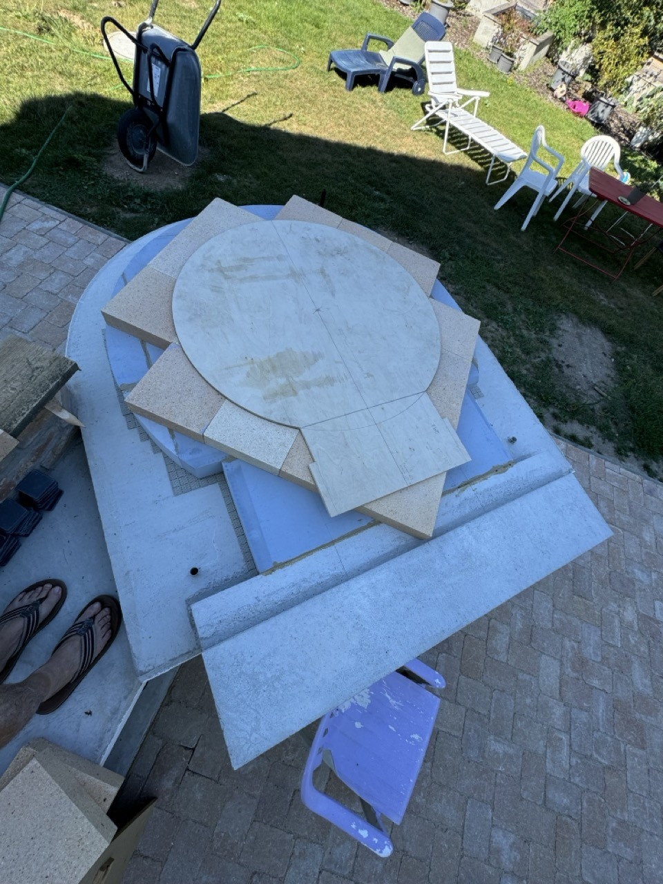

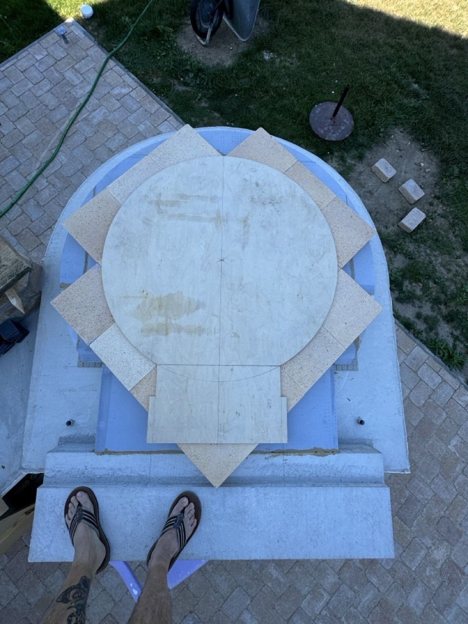

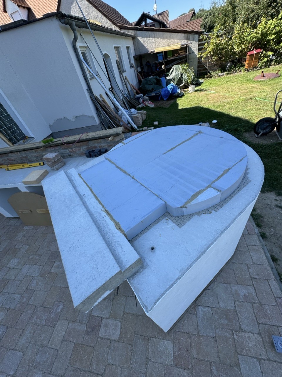

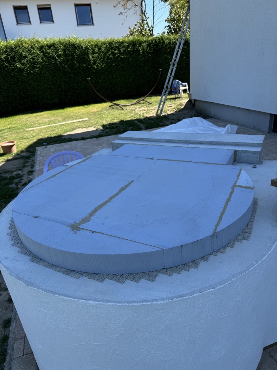

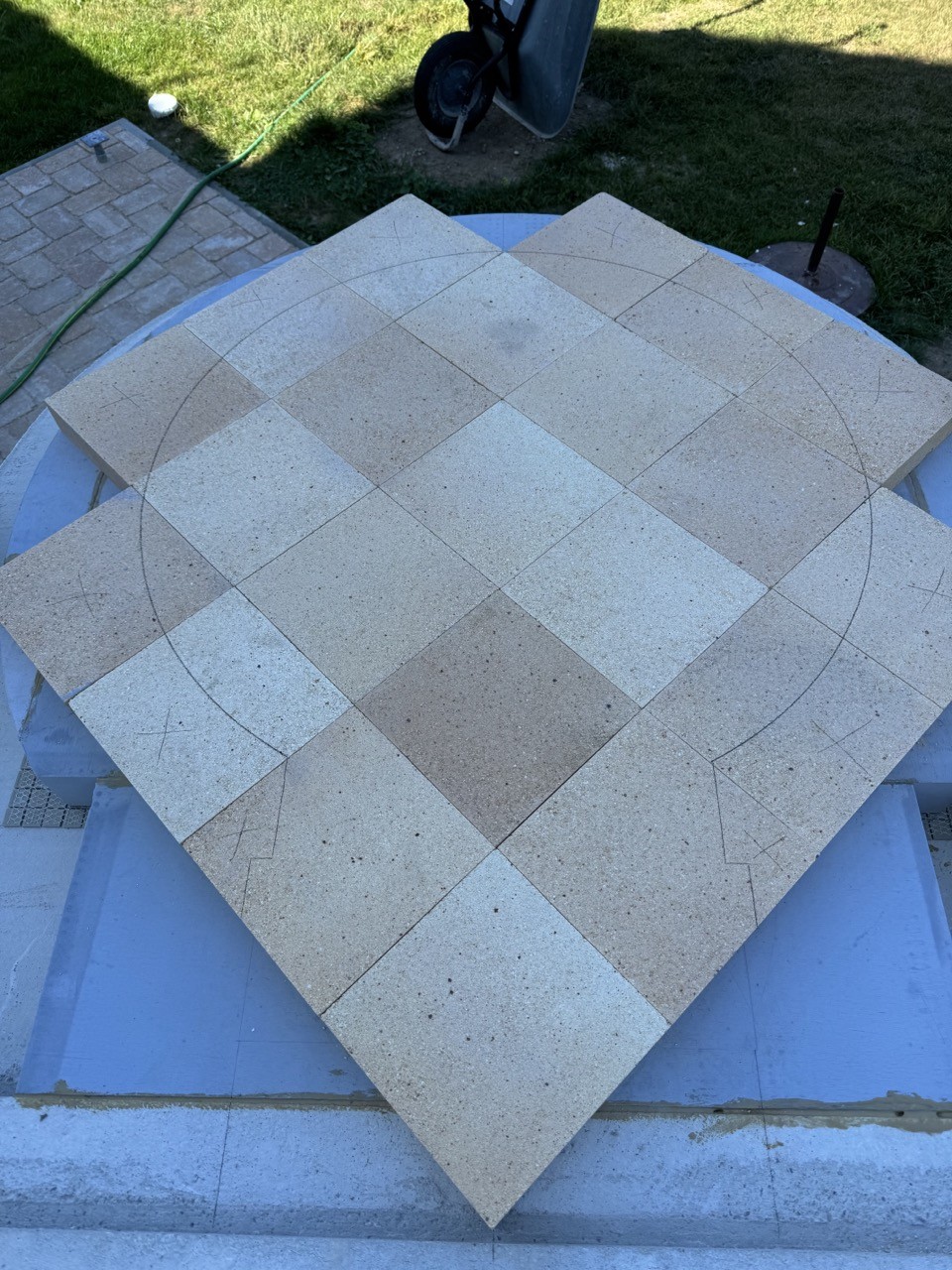

                                Set calcium silicate board on mosaic sheets, floor bricks marked for cutting
                                I had a few days away in Süd Tirol this week, needed a break. Before I went I cut the calcium silicate boards so I could get to setting them on the hearth when I returned. Yesterday I drilled out the drainage holes from under the hearth through the inserted pvc conduits added into the hearth concrete. There was only about 8mm above the conduit to drill out, was really easy.
                                I layed out the mosaic tile sheets to cover the required area for the calcium silicate sheets to sit on, and cut the sheets back a bit to within about 50mm from the sides of the calcium silicate sheets. Then I glued the calcium silicate sheets together on top of the tiles with fire resistant refractory glue.
                                Today I layed out the refractory floor bricks (250 x 250 x 64mm) on the calcium silicate sheets. I had already made a template the size of the inner floor, so I layed it on the bricks and marked the outline with pencil for cutting tomorrow.
                                So I was climbing over, standing and walking on the front shelf, even jumping on it. Happy to confirm it‘s strong az!
                                A few photos.
