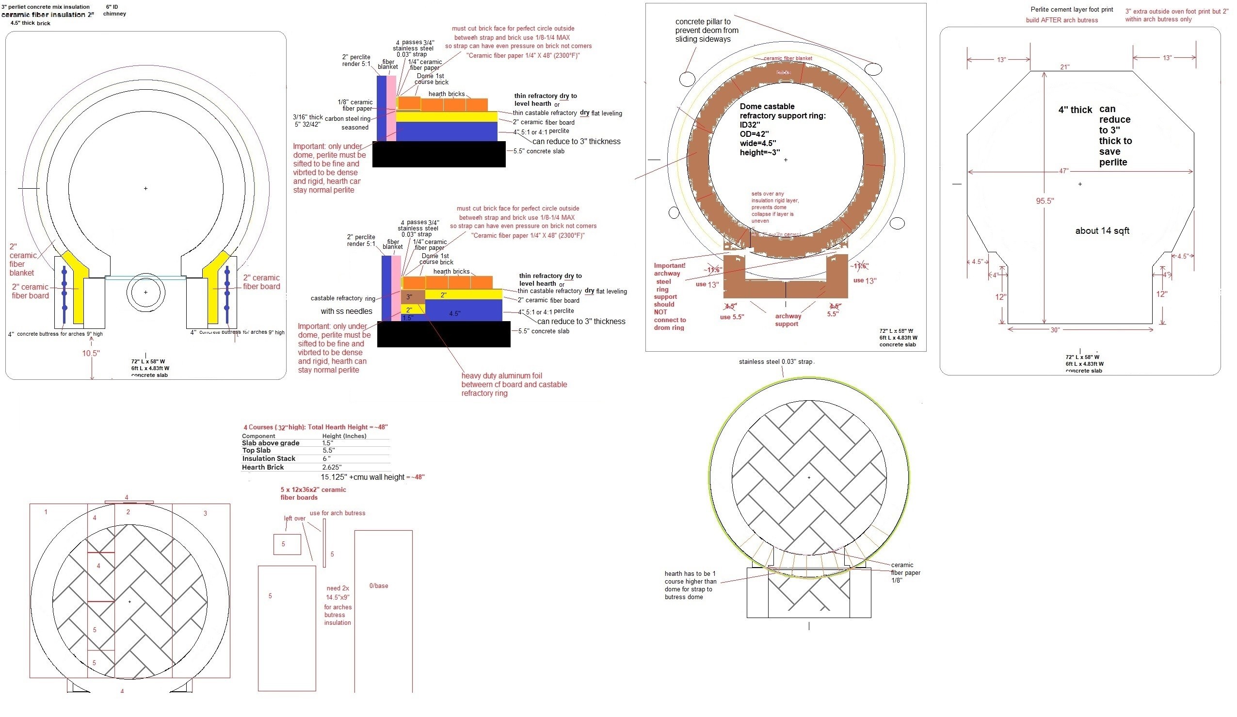

    I have been designing my oven and now its time to start building , wondering if my designs are good:

            • IH123
              • May 2026
              • 134
              As Mike mentioned, it would be helpful if we had more details on your build. Our members want to help new builders with the best practices and current trends. It is much easier to correct fatal flaws on paper then after the build has started. If you have not already done so, go to the Forno Bravo website and under resources you will find a free pdf download that gives a builder basic guidelines to get started and combined with member's input you will be less likely to run into design issues.
              Thanks, here are some of my design diagrams that I am following, I appreciate your kind help

              • IH123
                • May 2026
                • 134
                Arch diagrams

                    • IH123
                      • May 2026
                      • 134
                      insulation, buttressing, banding and hoop

                            • 9216
                            #14
                            Excellent plans, you've obviously researched and thought out this build really well.
                            A couple of things:
                            It looks like you have no access to the centre of your stand and if so you won't be able to remove any props supporting the supporting slab pour. I guess this doesn't really matter, they could stay there forever. Do consider either casting weep holes through the supporting slab or drilling them later. Casting them is probably easier because there's no problem in dodging hitting steel if drilling. An enclosure design is better than an igloo in terms of keeping out moisture, but all ovens suffer from moisture accumulation under the floor, particularly in the building stage and the weep holes do a great job of providing an exit for that moisture.
                            It looks like you are planning to make precise cuts of the floor bricks and building the dome around the outside of the floor. If this is correct try to get medium duty firebricks because high duty ones are far tougher to cut and you'll go through expensive diamond blades a lot quicker. Because you'll do a lot of cutting and the build will take some time the hiring of a brick saw will get expensive, far better to buy one and resell after the project if you want to recoup costs.

                              #15
                              A couple of things:
                              1- why do I need weep holes on slab? I am creating vents in the cmu walls not on the slab, they are positioned at 90 degrees angle so regardless which direction any wind is flowing it will push from one side and vent in another any trapped moisture and pressure in those closed cubes.
                              2-I have bricks that are rated for about 2500F - not heavy duty, 9"x4.5"x2.625" each weighs abut 3.3kg. I have a 10" wetsaw (will require two passes on some cuts). I have all tools I bought used at steep prices. I have concrete vibrator, cement drum mixer, paddle mixer, wet saw, mitre saw, concrete saw... etc
                              3- for moisture enclosure, I am actually going a totally new plan, bought two Aluminum sheets 24 gauge 0.020" each is 4ftx8ft , I will use a shingle style shell with 1" gap between the aluminum sheet and oven outer layer made by metal clips anchored to the perlite-cement layer: imagine it like an orange peel or earth equator lines,at bottom will be a big circular warp lets say about 6"-8" high, then next I put another wrap above it overlapping with it and so on, when I reach the peak pole of the dome, I will create a hole in the sheet and on top of it I will create a big umbrella so any rainfalls or melts will fall far over the shingles. same for archway however rectangular. the sheets will cover the entire slab top not just the dome so one wrap will cover the slab and has a small cantilever and drop control so basically a manta ray shape cover separated from oven by a 1" gap , is that crazy? my backup plan is to use the sheets as a roof top metal sheets if I ended up with lumber roof
