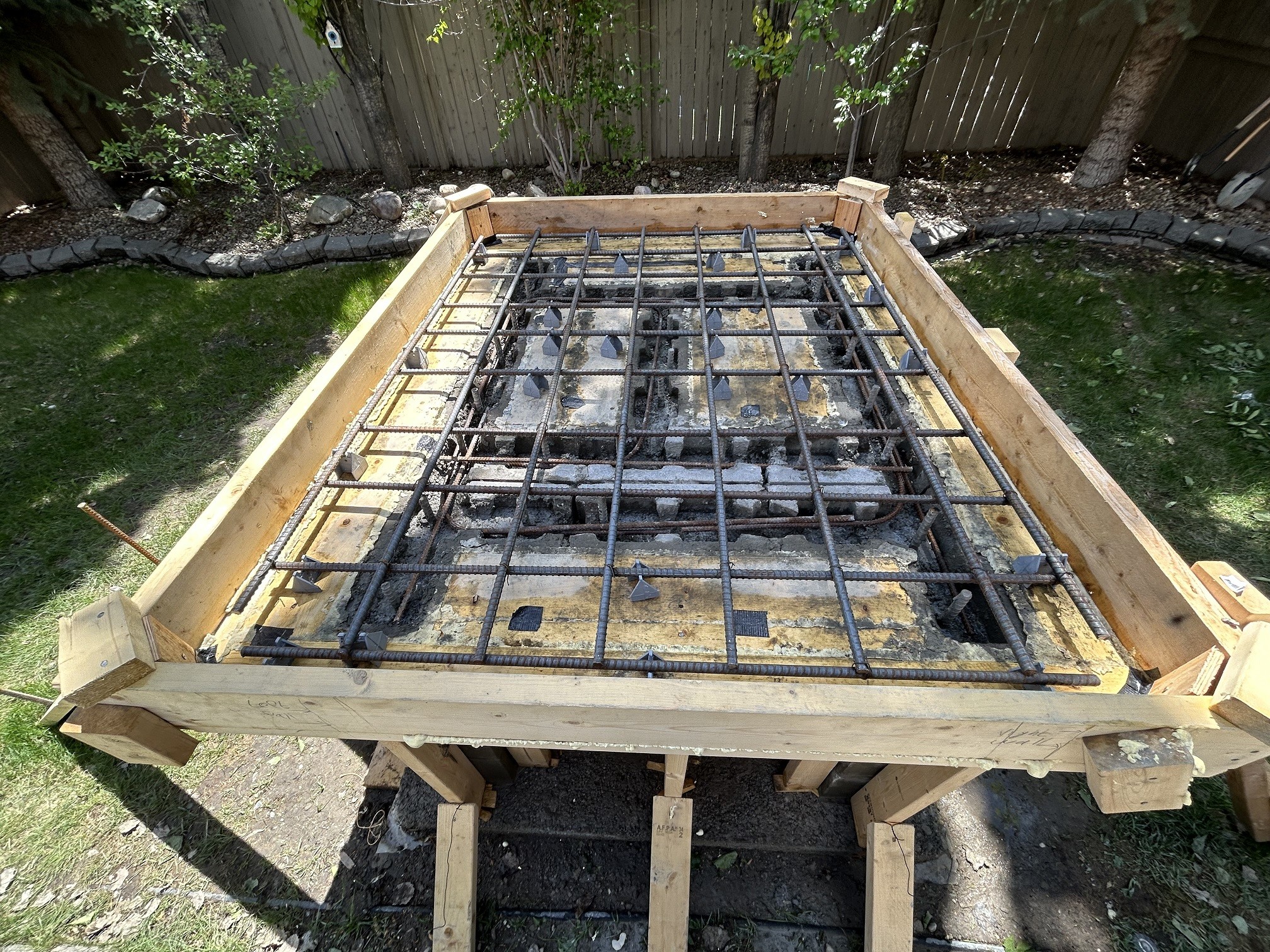

          Today's work: grouted all cores leaving about 2" on top without grout so the slab would cap on it when poured. used 3 gram fritz pack air entrain + 15 grams fritz pack set delay per 2 30kg ready mix bags (4000psi) and about 5.6 litres of water (more than minimum to keep grout fluid), I vibrated with the concrete vibrator too, installed the top slab rebar mat

            Serious steel in there.

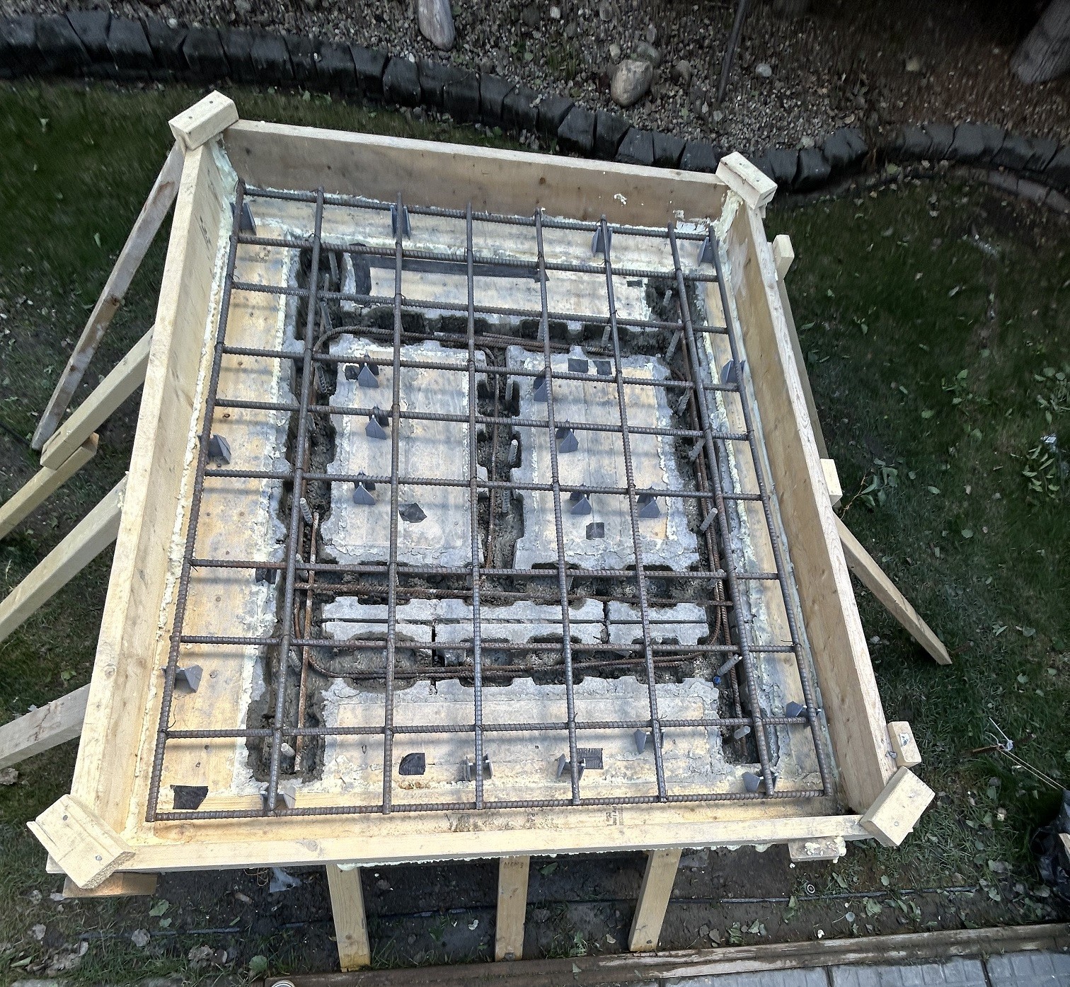

              Click image for larger version  Name:	IMG_8735.jpg Views:	0 Size:	1.35 MB ID:	471391
              small change in the plan, instead of PVC pipe cut, I cut the rebars at corners so when corner is trimmed they wont be closer to it than 2", I use plywood pad to dampen the corner edge and when slab is cured I will use angle grinder or concrete saw to trim it proper a tiny. my next step is the pour of the slab, will be using 6 hours of set delay: for 2 30kg 4000psi ready mix, I will use 3gr of air entrain, 45 gr of set delay (all fritz pack) , and 20 grams of 1" poly fibers. I will vibrate with my 35mm concrete vibrator. next update is after top slab is poured and finished. have 34 bags to mix and doing it all by myself in the morning

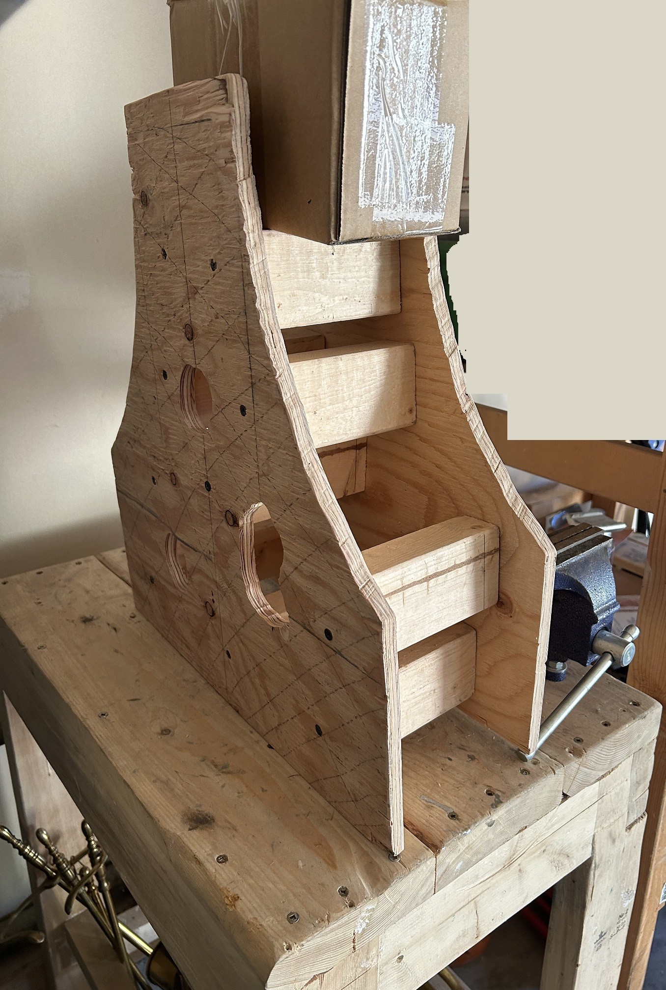

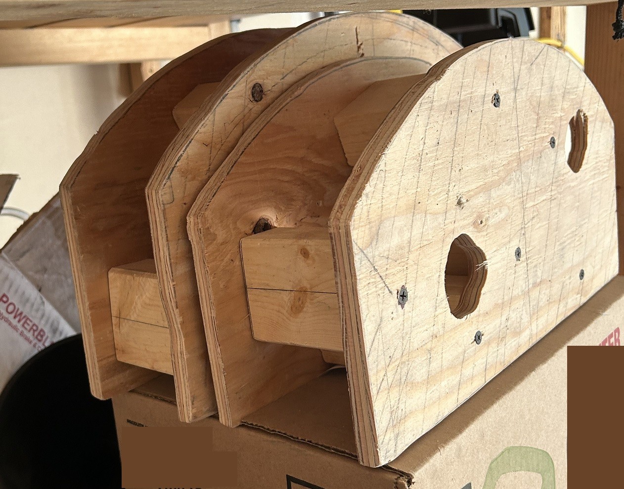

ID:	471394The arch plywood forms

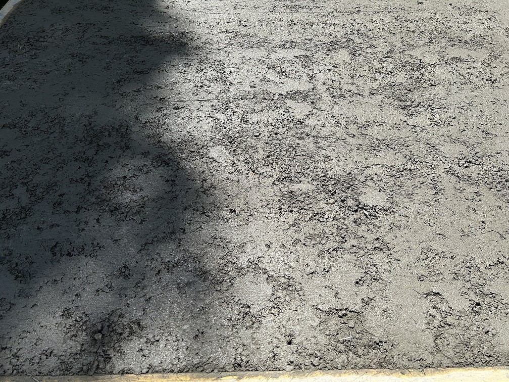

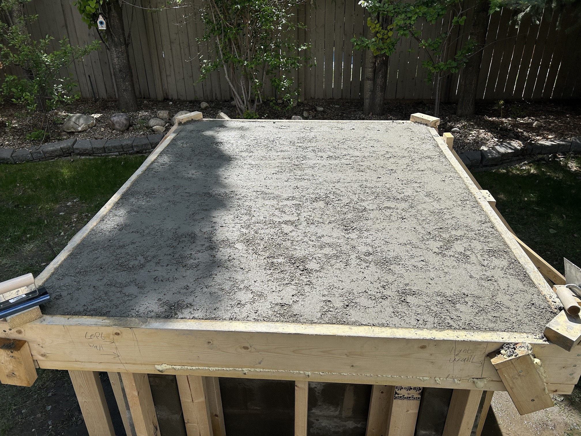

ID:	471410just finished the pour around 12:30pm, 2 hours ago, likely have to wait few hours before finish as 6 hours set delay makes it soft still
